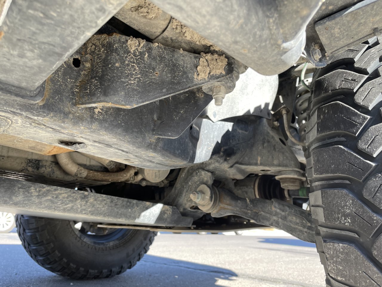

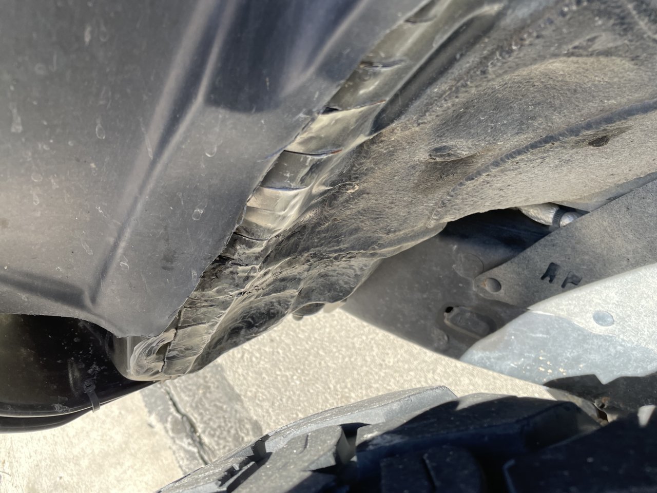

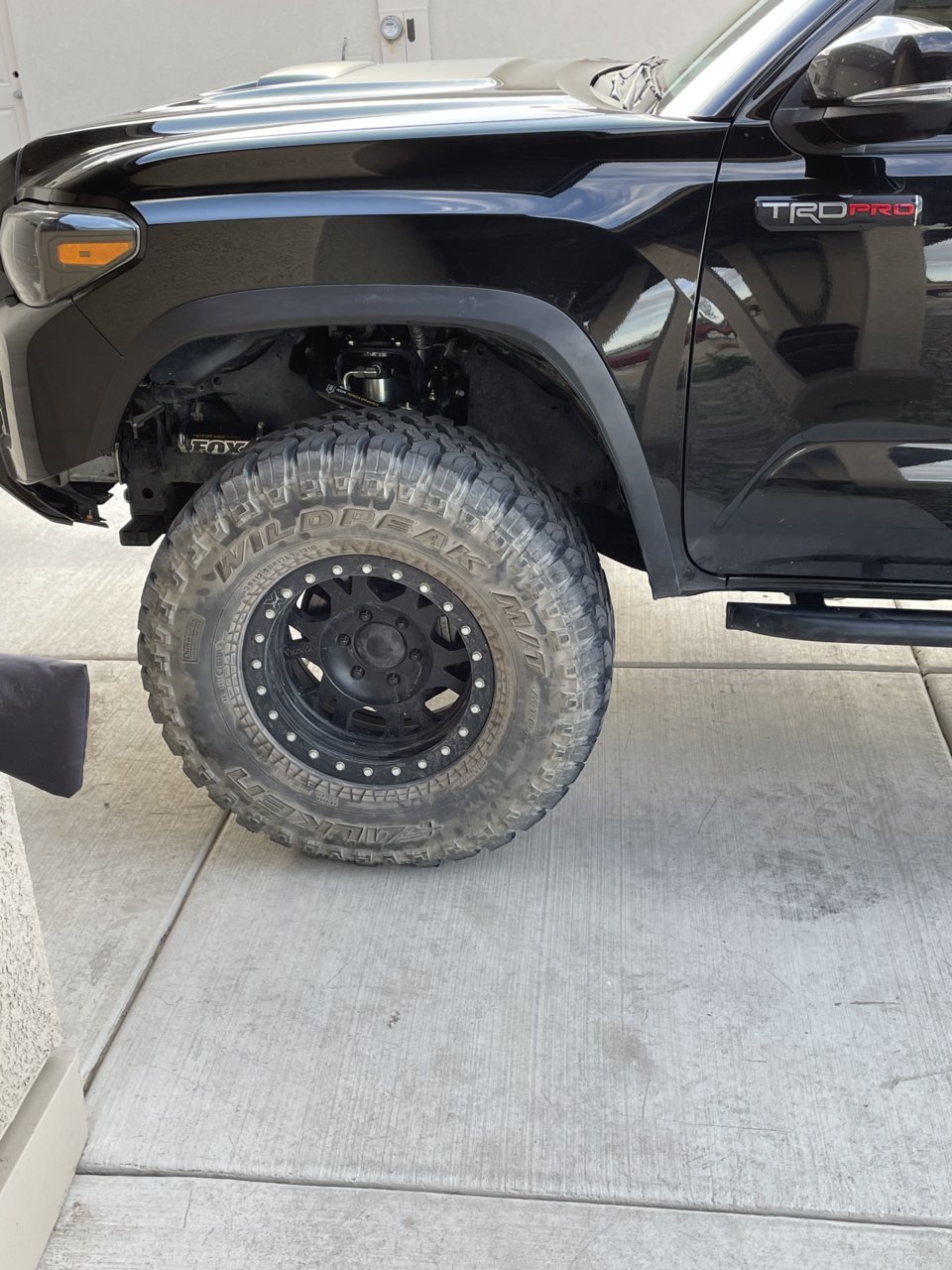

    lol hey at least you went with a true 33x12.50 so kudos... most guys settle for a 285-75/70. With what you have planned that should be enough for 33's. May still have to do some minor cutting of the fender trim towards the cab mount. I am on 35x12.5x17 and I have a CMR from alpine designs and icon tubular UCA's so my adjustment is nothing like the SPC's but I didn't personally want UCA's with a balljoint. 35's require more cutting. My fenders are trimmed 2.5" all the way around and I have the firewall pushed back as far as I can with a big hammer. I still rub the firewall when the tire is stuffed and turned so I am going to tub it out at some point. You may not have to with SPC's though. Funny my right side also rubs more as well.
