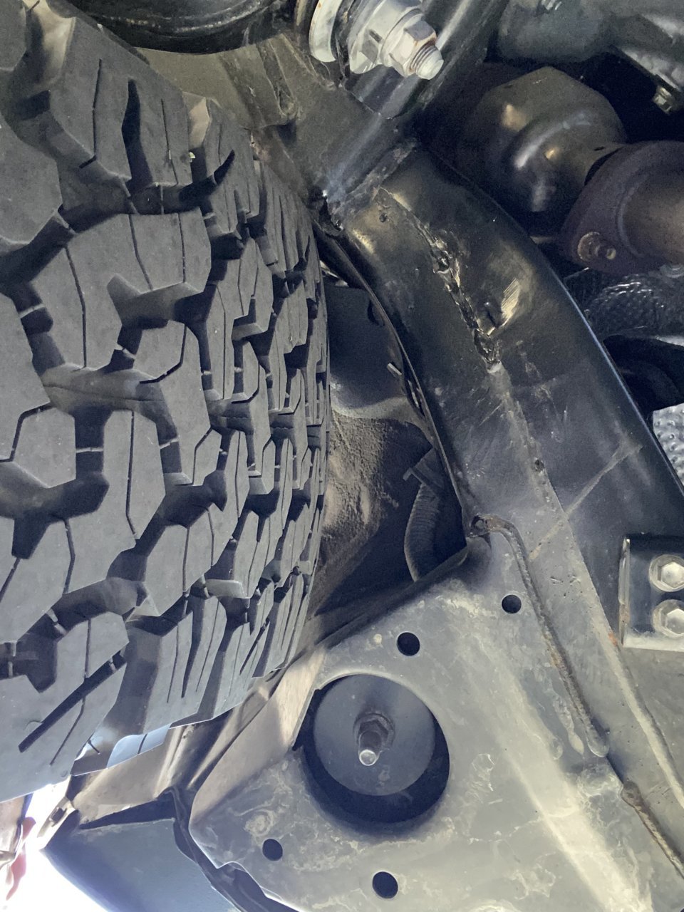

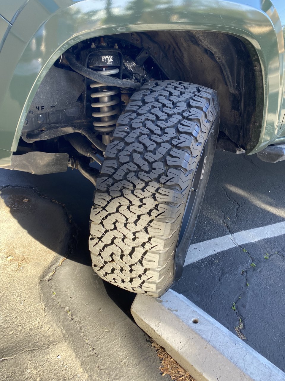

    Here is a picture of the wheel turned out

    From the bottom
