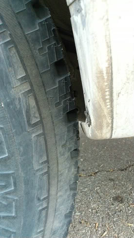

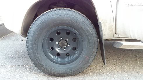

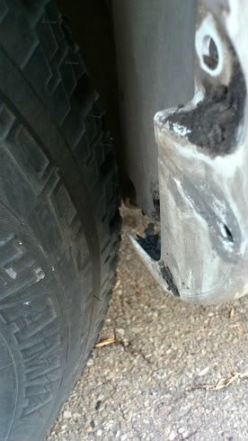

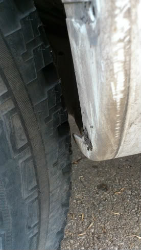

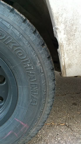

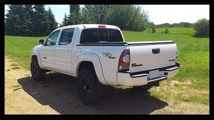

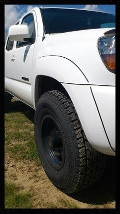

    OP: I have American Racing Mojave Teflon wheels in 16x8 4.5bs and 0 offset with 265/75/16 Yokohama Geolandar AT-S tires on stock suspension.
    I did have to remove front mudflaps. I also had to slightly bend the inner portion of the flare normally covered by the front mudflap inward. Now it does not rub even in full lock. Hope this helps.
