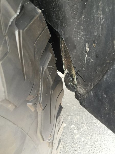

    I know there's threads about it but I'm no good at searching for threads so bare with me here.
    I put 265/75/16 KO2's on my truck last week and I continue to rub. I trimmed my wheel well down a little. The rubbing stops and somewhere during my day my tire manages to reach the plastic. So I trim more. And this happens over and over.
    However, I do have Bilstein 5100 adjustables in the front. I have another 1.25 inches to go but my truck is level atm and I don't want to bulldog. Is 1.25 really gonna make the appearance change that much?

  11. Jan 7, 2016 at 9:08 AM
    Scoobarooo
    Scoobarooo [OP] Well-Known Member
    Jul 11, 2014
    #133735
    3,851
    Casey
    Brooksville, FL
    '02 DCSB TRD OR
    3" OME/Bilstein, Retrofits, Custom Bed rack/Toolbox, Amsoil Everything, tons of others.
    image.jpg I trimmed the plastic more. So that clears, but this metal isn't clearing

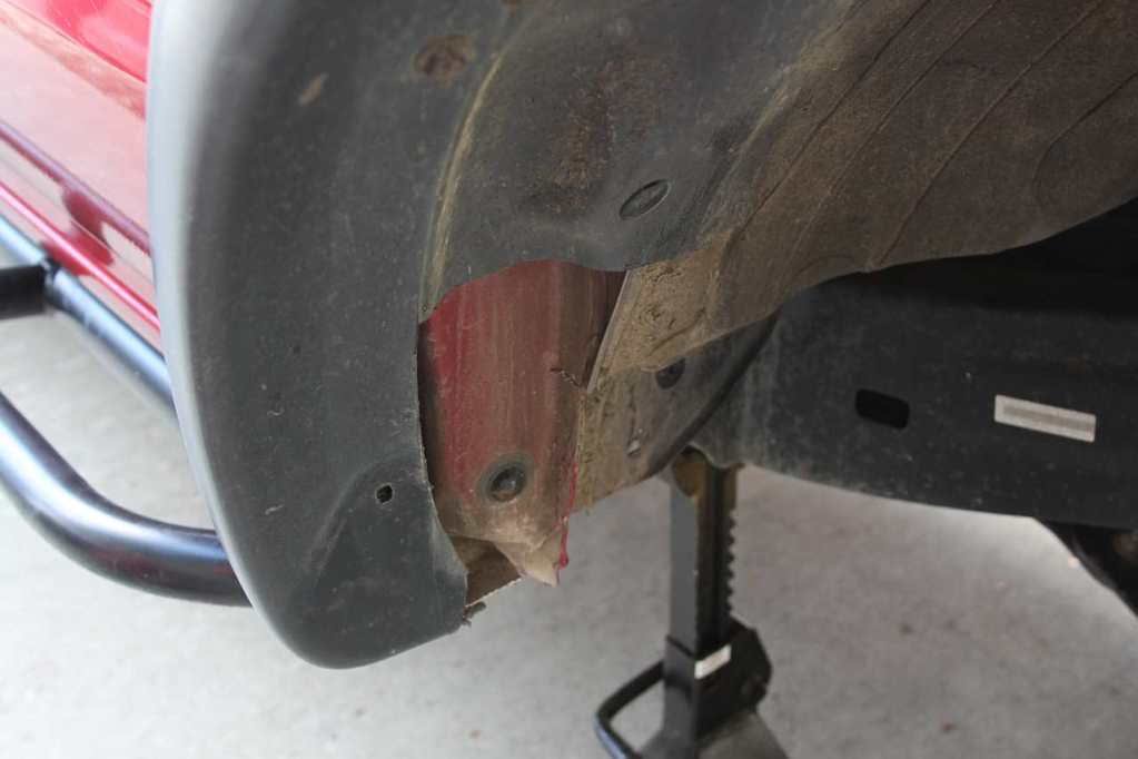

  12. Jan 7, 2016 at 9:27 AM
    Digiratus
    Digiratus Adventurer
    Mar 26, 2010
    #34006
    23,777
    Roaming the PNW
    The RedHead
    2002 XtraCab TRD 4x4 SCv6 AutoTrans With Lots of Mods ADS COs w/Compression Adjusters Camburg Uniball UCAs Whiteline Lower Control Arm Bushings Kartek 7" Limit Straps Plastics Guy Front Bumpstops Total Chaos Sprindle Gussets Custom Alcan Springs +800 lbs +3" ADS 10" Stroke Triple Bypass w/Resi Rear Shocks Custom Rear Shock Relocate All-Pro U-bolt Flip w/Timbren Bumpstops 4.88 Nitro Gears ARB Front Locker ARB Twin Compressor Black 17x8 Konig Countersteer Type X 285/70r17 Falken A/T3w Gunmetal 16x8 SCS Ray10s 255/85r16 Maxxis Bighorns Limited Edition (Relentless) Elite Front Bumper Smittybilt X2O 10K Winch Diode Dynamics SS3 Sport Selective Yellow Fog Lights in the Bumper Diode Dynamics SS3 Pro 4,000 Kelvin SAE Driving Lights with Clear Lenses on the Bumper Morimoto D2S Projectors XB35 Ballasts + 4300K Bulbs Badland Sliders FrankenFab Tire Carrier Swingout bumper w/kitchen BudBuilt Front & Bellypan Skids BAMF Rear Diff Skid Dometic CFX 55im Fridge/Freezer Alpha II Hardshell RTT Badland Custom Bed Rack Denso 210-0461 105 amp alternator Dual Northstar 24F AGM batteries BlueSea 7622 ML-ACR Battery controller Peak DBI Dual Battery Voltage Monitor Haltech IC-7 Display with Mako Dash Insert Haltech Elite 2500 Standalone ECU Magnuson MP62 Supercharger w/URD 2.2" Pulley Denso 650cc Fuel Injectors Aeromotive Stealth 340 Fuel Pump TransGo A340F Reprogramming Shift Kit Doug Thorley Headers 2.5" Magnaflow Hi-Flow CAT Magnaflow 18" Muffler w/Vibrant Resonator 13WL Brake Calipers Braided Steel Brake Lines Kenwood TM-71A Dual Band Ham Radio Larson 70CM/2M Antenna Midland MTX275 GMRS Radio w/Roof Mount Antenna Uniden 520xl CB radio 3' Firestik Adjustable tip antenna Pioneer DEH-P9400BH HU Alpine Amps & Type R components (F) and coaxials (R) Wet Okole Seat Covers Weathertech Digital Liners Deck Plate Mod 1" Diff Drop Carrier Bearing Drop
    That is the pinch weld folks are referring to. Take a big hammer to it and pound it flat. Or a grind it down.

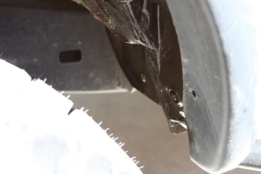

  13. Jan 7, 2016 at 9:35 AM
    Digiratus
    Mar 26, 2010
    #34006
    23,777
    Roaming the PNW
    The RedHead
    Here is a pic of what mine looks like after massaging the pinch weld.
