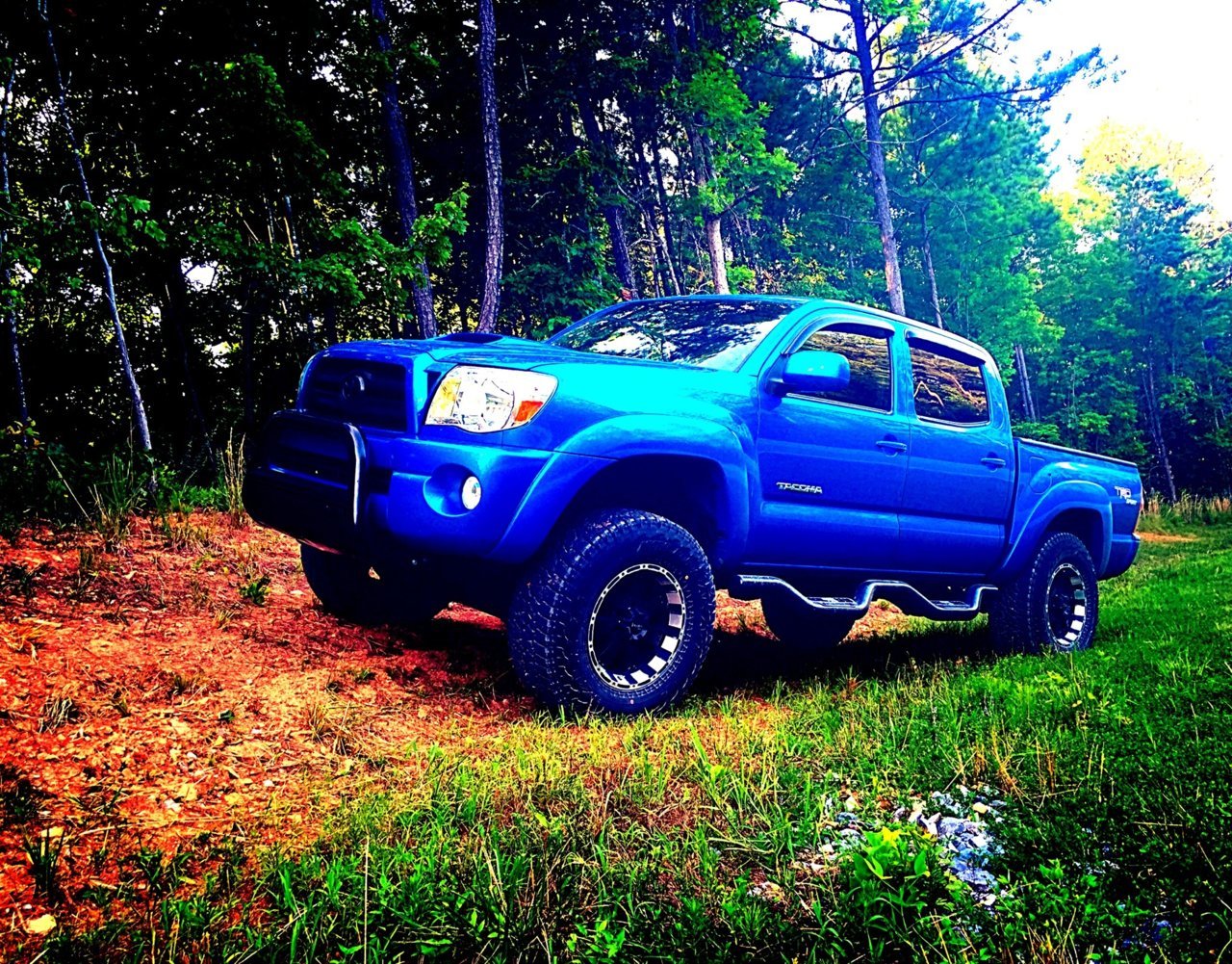

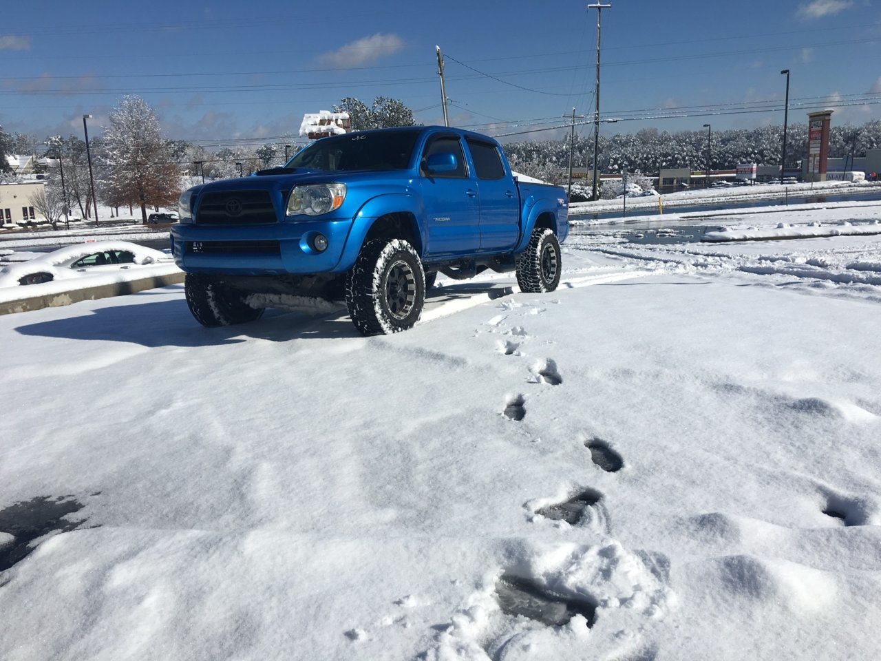

    463BF397-5109-4581-A93C-A9ACD5B358BD.jpg 9DBE4ABF-A898-4C6B-8FB8-9BFF90A63B62.jpg 7C958D81-7822-41EE-995D-9FF38FFCD7D1.jpg Specs:
    Falken Wildpeak A/T’s 285/70/17
    Spider trax 1.25 spacers all the way around.
    Incubus rims( unsure of offset if any) I thin they are 17x9.
    3” Tuff country lift
    Trimmed the front bumper black wheel well that hung down a bit to flush with the bumper. Still rubs slightly on front and back of wheel well.
    However my biggest concern is it rubbing on the sway bar end links.
    I’m not sure if I need different wheels, smaller tires, more lift, better suspension, or whatever but I’ve tried everything I can think of with my knowledge (not much)
    Anyone know an easy fix? Or have any ideas to why it still rubs even after going from 305’s to 285’s and adding bigger spacers?
    Thanks! Any help would be greatly appreciated!!!!

    For the fender rubbing you can keep cutting. I'm fairly suprised your hitting the links. Hitting the upper control arms is much more common. I (and a bunch of others) run 35/12.5s without rubbing suspension components ( I think we all rub the cab mount without a relocate). I'm would bet it's your wheel specs. 9 inches is a wide wheel. Do you know the backspacing/offset? Also any pics of where you rub?

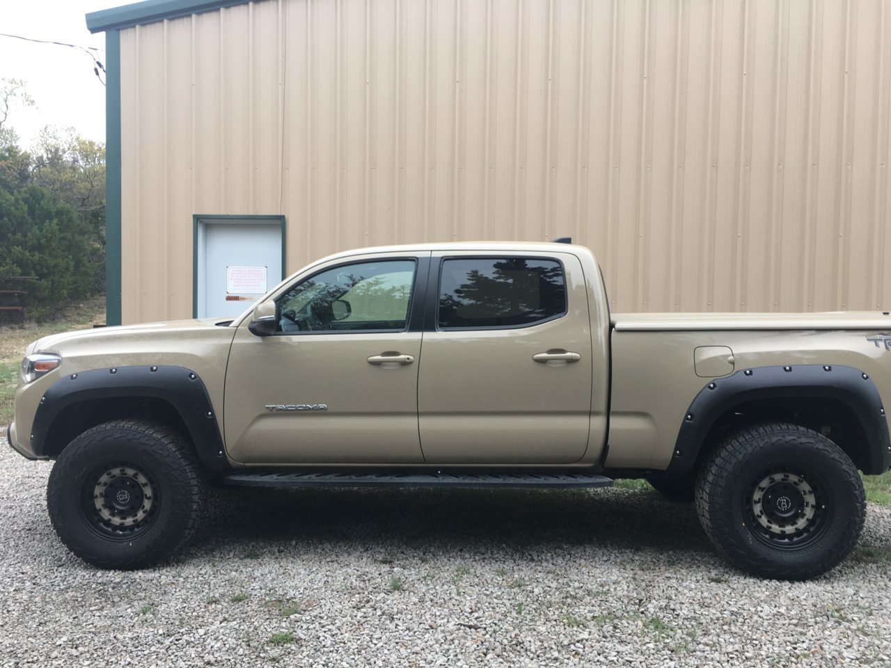

    I run a 9.5" wheel with a -18 offset and yes did a major cab mount chop. No issues now.
