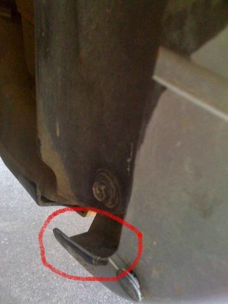

    This is a Google image, but I cut here with a box cutter. They won’t rub if I try now, and it looks factory if you cut good and don’t have an uncut Tacoma to compare to. You just hack that protruding piece out, and some of the liner.

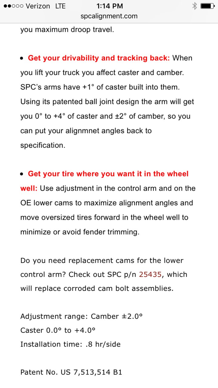

    RangerComa
    RangerComa 58008
    Mar 14, 2017
    #213317
    2,823
    Adam
    Marin, CA
    17 DCLB
    list is growing fast
    I have Dirt King UCA's, very similar set up to you with wheels and tires. I had rub on same spots. The UCA's have built in caster that pushes the wheels further back in the wheel well, hence the rubbing. Had an alignment done twice to try and get more caster, but they kept maxing out and then camber was too far off. My alignment numbers are around 2.9 caster and .03 camber with .07 toe on both sides.
    The problem is that the caster can only be adjusted on the lower control arms alignment cam bolts. Many people run SPC UCA's for this reason... they are adjustable at the UCA also. This allows for more caster to be added while maintaining good positions on the LCA cam bolts for camber.
    If cutting some plastic is ok with you, I would recommend as it's the easiest and cheapest option. But if you are cool with dropping another $500 on SPC UCA's, you can get better caster/camber numbers and completely eliminate the rubbing issues. It will also allow you plenty of clearance for those 255's you want...
    Good luck man. It's a rabbit hole we've entered!

    Toyota
    That's what I'm saying. You can. There is a cam bolt on the ball joint of the UCA that you can adjust the caster and camber with. This is in addition to the OE lower arm cam bolt adjustments.

    Not sure where you got your info and not trying to have a pissing match, just want the right info out there for op and others. This is directly off of SPC's website:
