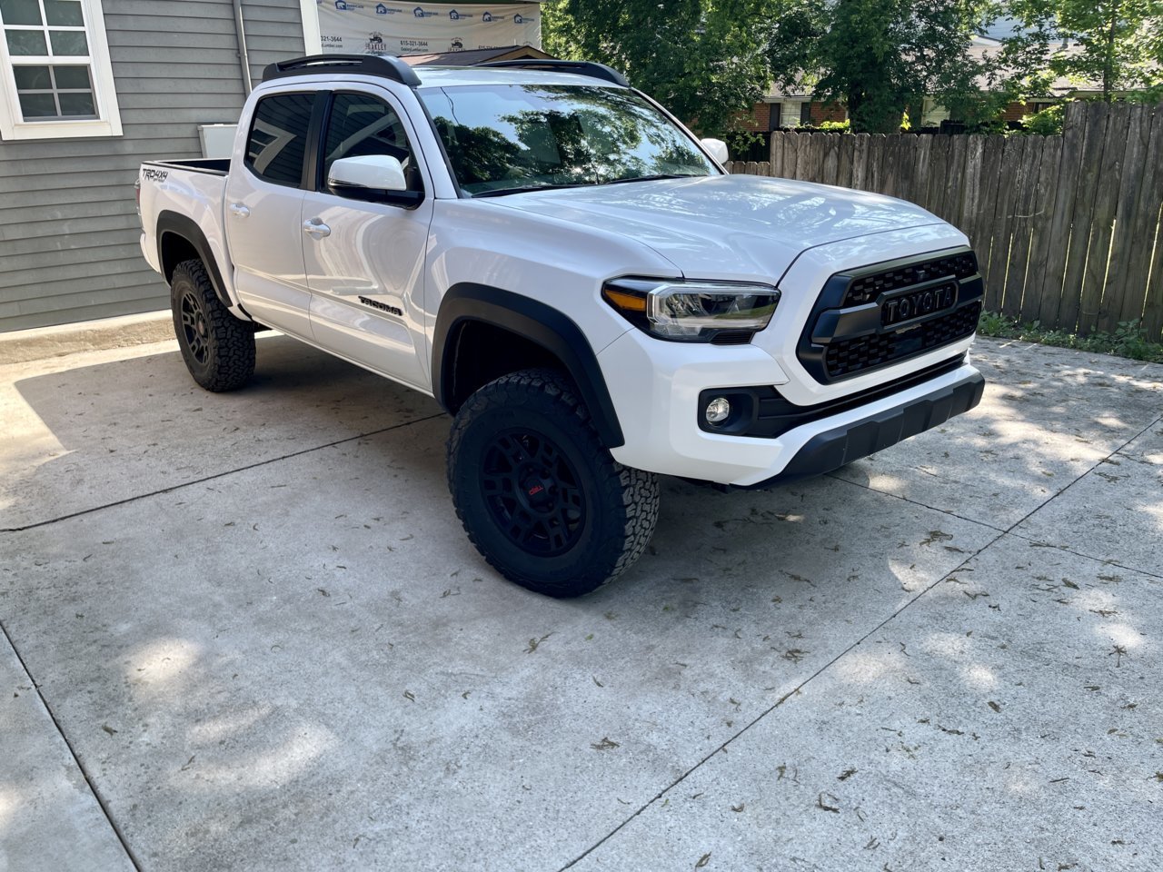

    Hey guys - apologies if this is covered somewhere and I missed it. Feel like I've seen folks post solutions to this before but couldn't seem to find them again when searching.
    I'm on 255/75 BFG K02s with the 17" TRD Pro 4Runner wheels. 2" factory TRD lift. Factory mud guards.
    I'm getting rubbing on the front driver side mudguard at something approaching full lock. Best way to fix this that (ideally) doesn't involve buying new mud guards? Anyone modified OEM ones in some way? Cut 'em? bend 'em?
    appreciate any help!

    Heat the spot on the flap that’s rubbing with a heat gun, then re-mold it to where it no longer obstructs the tire.

    Youve got 3 options, not including just removing the mudflaps:
    1 - Find a knowledgeable alignment tech that will adjust your tire centerline a litte forward in the wheel well.
    2 - Swap your mudflaps for Tuffskinz or Rokbloks mudflaps. These are flat and should gain you a little bit of room.
    3 - Go to a smaller tire
    Also you don't mention it but are you using wheel spacers? If so how wide? If you are runnig 1.5" you could try .75" or just remove them.
    Edit: I did once try modifying the oem mudflaps to fix the same rub you are having. The result was less than ideal, the mudflap never went back on.
