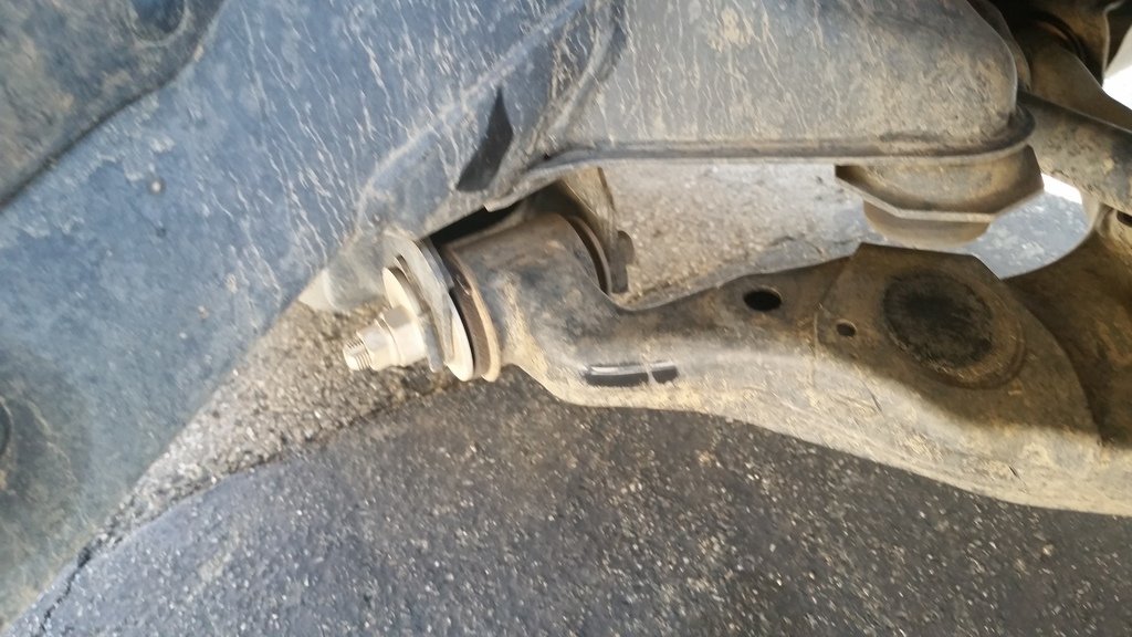

    anyone else having this rubbing issue or is it just me. need suggestion on fixing this problem. only rubbing on passenger side.
    i have 08 tacoma 4x4 xcab
    ome lift kit.
    SCS F5 16x8 3.5bs.
    bfg ko2 265/75/16
    camburg UCA not install yet

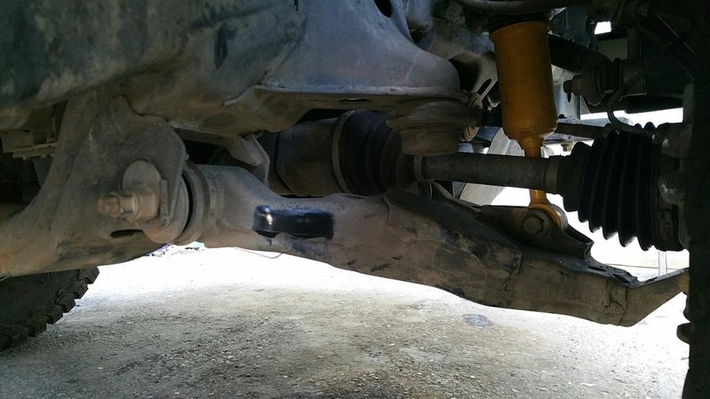

    Where is it rubbing? The frame or UCA can be fixed with spacers. But at 3.5 backspacing I'm betting your rubbing the cab, bumper, or fenders?

    Did the cab mount chop, trimmed the bumper and liner already no rubbing there. Wit 3.5bs no rubbing on the uca either

    I see where your rubbing now. Spacers will help but then depth of your cmc is gonna be the next issue

    I bet it is just you alignment. Look how far that alignment cam is hanging out there...when you get the UCA's on get it aligned. I bet it will clear.

    I have a 2014 with the TRD Baja 2" leveling kit, mine does the same thing - rubs on passenger LCA and frame. also have 265/75's
