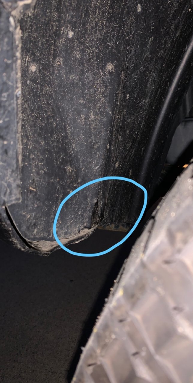

    Just put 255/80/17 Wildpeaks on my 2018 Tacoma. Just switched from 265/75/16 Wildpeaks. I’m rubbing a little bit on my inner fender as pictured below only when I make turns in dips above 10mph. Any suggestions on the easiest way to fix/trim/file this area? 2A08A37E-9A40-4CAC-9334-971206EDC795.jpg

    Heat it up and press it back. That will self clearance eventually anyways...

    I know it’s not your question, but alignment? Caster? Is that an issue or of help? I’ve solved the rub that way on 255’s.

    If it's only rubbing a little I would just cut it and call it a day

    Yes, but not with stock ucas
