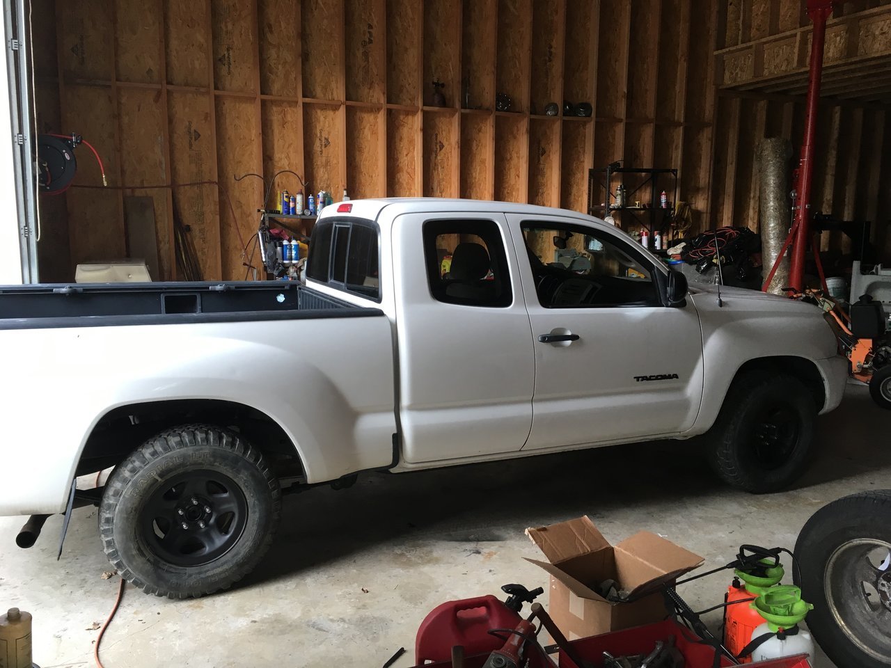

    hello all,
    So I recently put 30x9.5 r15 on my five lug tacoma with a 3mm spacer. As soon as I went to roll out I heard grinding. It's rubbing on my caliber. I put both 3mm spacers on one wheel just to check and it spun freely. So my question is
    Do I grind down my caliber so it fits properly
    OR
    Do I put 6mm spacers on my front.
    Which if I do that will I need longer studs.
    Any suggestions?

    I know on the prerunners and 4x4 2nd gen you have to run at least a 16" wheel or it will rub the calipers. Probably the same on 5 lug.

    Second gen. It's an 07

    Saw the pic when I posted and changed it.

    Did you have a 16" wheel on there before?

    No I had 15in before too. I used jeep rims.

    Your caliper is inside the wheel. The tires have nothing to do with the wheel rubbing on the calipers. Only other thing I see you changed was the spacer. You try it without it?

    No but it is a diffrent rim from the last. Both are 15in. I'll have to get a pic tommrow to clarify. Thanks for the reply.

    Post up a pic and we'll take another look at it. I'm sure we can figure something out.
