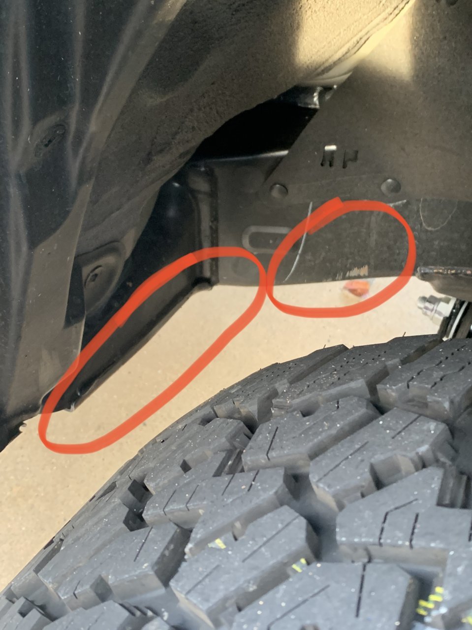

    Rubbing with my current set up. Trimmed all the plastic, tires are definitely clearing the fender walls. Now (Im pretty sure) its rubbing the frame (Ill post a pic below of where I think its rubbing)
    current set up:
    + 2021 TRD OR DCLB
    + Bilstein 6112 set @ #6/#5
    + Bilstein 5160 in rear
    + IVD 3 leaf AAL pack
    + Black Rhino Rapids 17x8.5 0 offset wheels
    + Falken Wildpeak 265/70r17
    + Spidertrax 1.25" spacers
    I was rubbing before I lifted the truck, after I lifted the truck, and after adding the spacers. The lifted definitely helped but it needed a decent amount of trimming of the fender walls. Now Its still rubbing at full articulation in reverse and when I start driving (both forward and reverse) from rest on an uneven surface. I dont feel any rub if I hit a bump while Im driving though.
    Anyone have this problem with this tire size?
    Wondering if the next step is to hammer back the pinch welds or add more offset.
    This is the passenger side of the car (back of the wheel well). Same story for the drivers side.

    Have you tried without the spacers? I would bet you don't get rubbing without the spacers with your zero offset wheels.

    Agree. It's the spacers. Run it without them.

    Stupid question, would pushing the wheels out further prevent the rubbing on the back of the frame?
    I'm not the best with wheel/suspension stuff.
    I'll probably end up taking the spacer off to test it and see how that helps anways.

    Pushing the wheels out with spacers makes all rubbing worse, unless you are rubbing the Upper Control Arm.

    0 offset wheels like Said above remove spacers

    did you upgrade the UCA? sounds like you need aftermarket UCA to increased the caster and push wheels away from the cab which will prevent rubbing

    Someone here mention move the front tires forward…had my alignment shop..move 1/2 inch to front…so far it work! Note SPC upper control arms…alignment came out perfect…green bars..

    As @not0ny said you need UCA’s and more positive caster.

    I thought 265/70’s clear stock…I’m guessing your spacers are hurting you

    Good idea. That is the problem.
