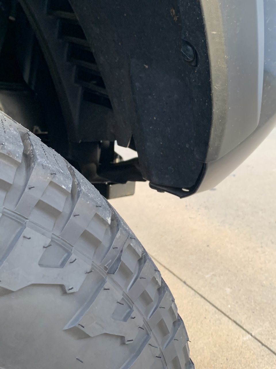

    If you look close at the original pic I posted, you can see where I trimmed it in the back of the wheel well. The picture below is the front of it. It’s not rubbing the plastic anymore though, just the inner corner of the frame and the backside of the wheel well.
    no alignment specs.
    sorry for the shitty quality pics. My phone camera sucks ass.

    I’m a little confused though… I’m not doubting what your saying, just wondering what the exact reason is. Since it’s rubbing the frame on the inner/back side of the wheel well, wouldn’t pushing the wheel out make it rub less? Or is this logic wrong.

    Your wheels are wider than stock (which means the sidewalls stick out that much further), the 0 offset means they also stick out 25mm more than stock (which is about an inch right there), and you put 1.25” spacers on them. Add all those factors together and you’ve increased the turning arc of your tires by about 2.5”. That’s why you’re rubbing. Like others have said, lose the spacers - that’s the easiest thing you can do at this point to try to stop the rub.

    Alright that makes sense. More offset = more turning arch = more rubbing. I appreciate the help.
