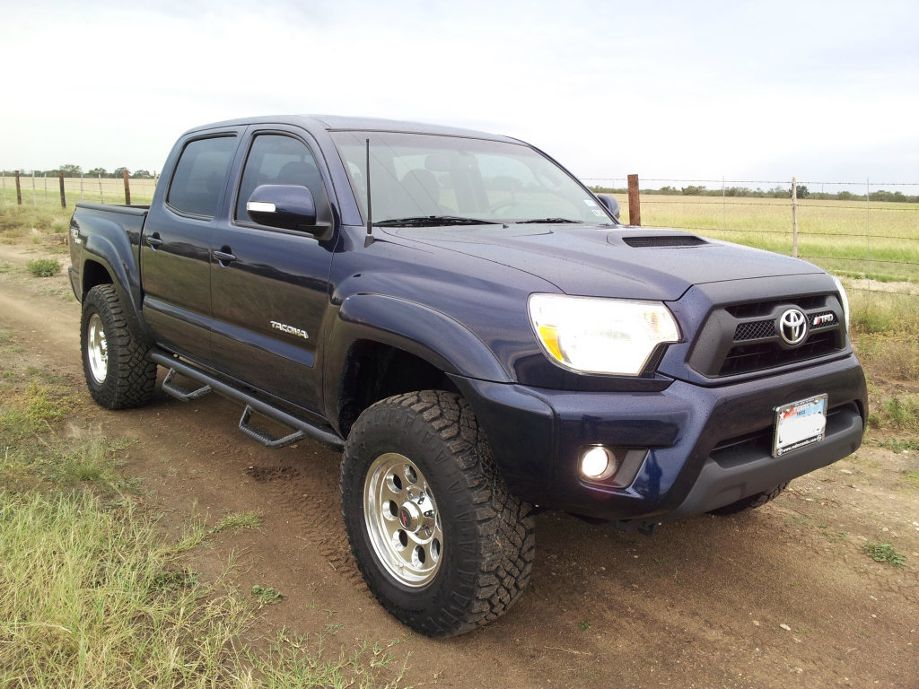

    I have the Level 8 Trackers 16x8.5 & 265/75/16 Duratracs on my 2012 and had a similar issue.
    Got the tires and wheels installed first and it rubbed when I turned all the way. I removed both of the front mudflaps and it stopped rubbing when turned. But if I turned and hit a slight bump (like going into my driveway) it would rub. When it did rub, it rubbed a large hump on the top of the mudflap.
    I had the 5100 installed at 1.75 and no rub at all anymore (I still have the mudflaps removed)
    It is pointless to keep the mudflaps on when the tire sticks out further than the mudflaps.
