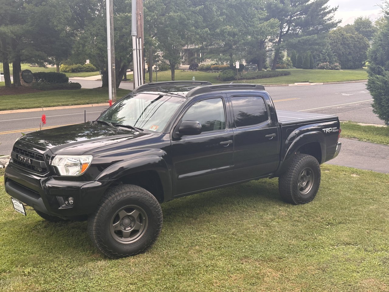

    Hey guys, I need some help. I have a 2015 OR with a Toytec 3” lift and Wildpeak 285 75R16 tires.
    There is no rubbing while on road driving, but full lock and hitting a bump I rub. When taking it off road I rub too.
    I have no idea where I’m rubbing though so I’m hesitant to cut anything off because I’m afraid of making costly mistakes.
    How can I tell where I’m rubbing so I can cut that part off?

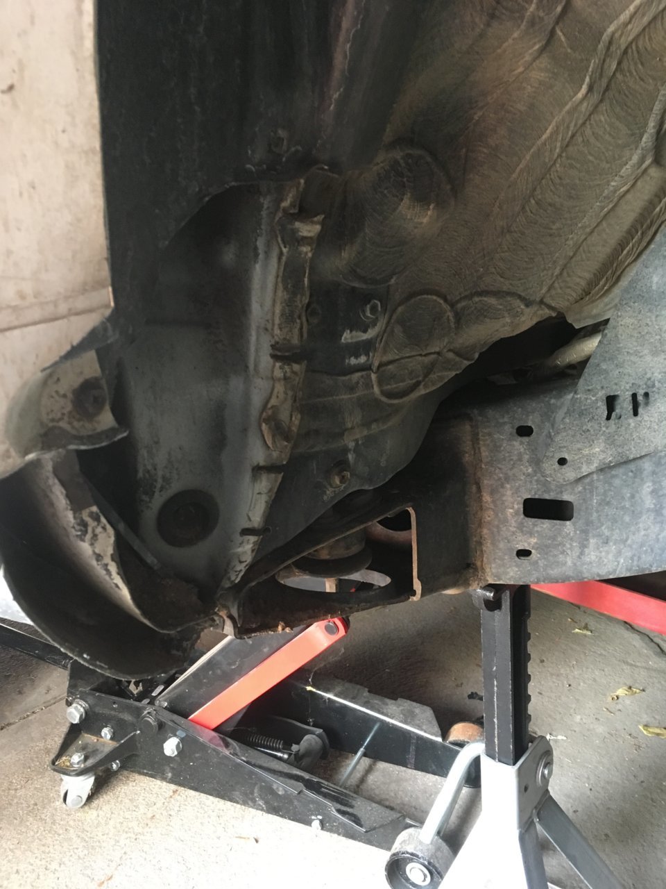

    You can absolutely cut the cab mounts yourself, even if you can't weld. All you need is an angle grinder. You don't need to weld plates over it immediately after you cut them, you can take it to a shop later for that, but I do recommend you eventually take it somewhere to have them throw plates on as they will just funnel dirt and water into your frame. Ask me how I know.
    Here is where i cut mine for 285s, bone stock suspension, no lift, for reference.
