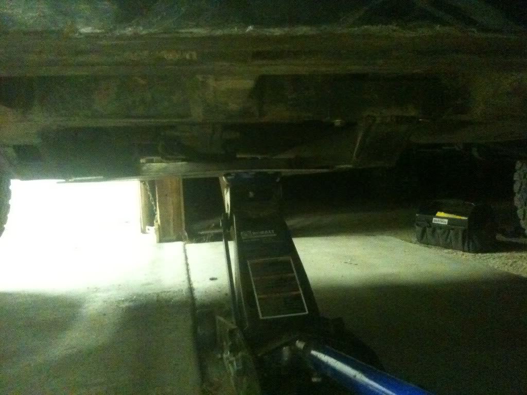

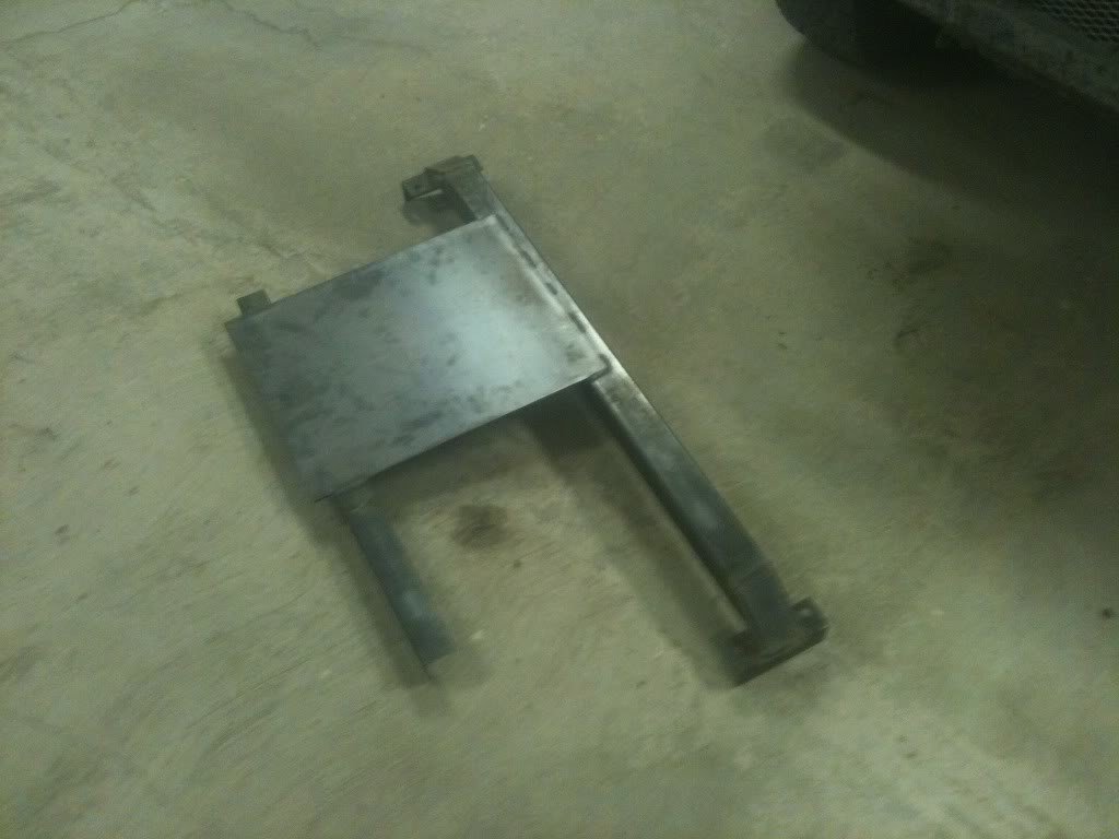

    Saw a nice "dig" in the cheesy ass tcase "skid" so i decided to make a tcase skid out of some 3/16" plate
    Total cost $40
    The last picture shows it flexing but all 4 wheels off the ground balanced on the skid

    lack of equipment makes it challenging at times...
    if only i had a shear/brake, pipe bender, plasma cutter, cold saw, etc...
    using flux core its not pretty but my shit is strong!
    my sliders have taken more abuse than any round tube style that ive seen

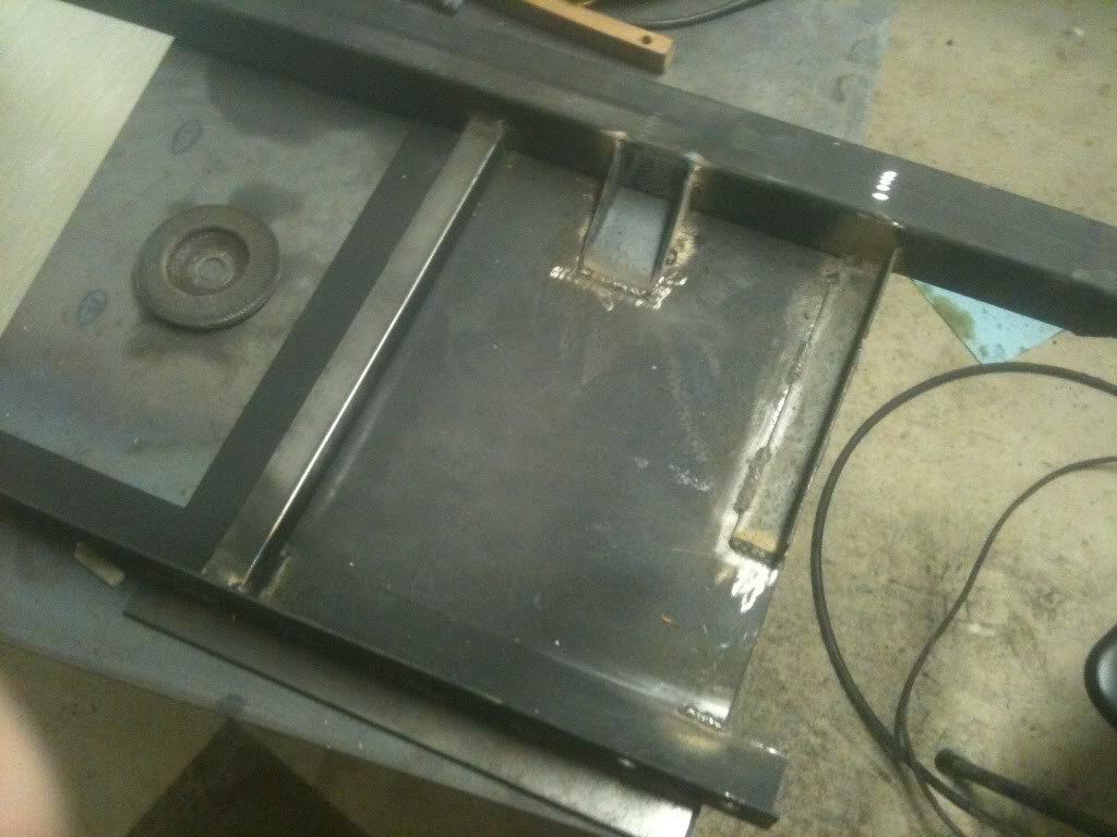

    forgot to upload pics of reinforcements to the trans skid...
    it doesnt flex anymore. it took some punishment on the trail labor day weekend, held up like a champ!

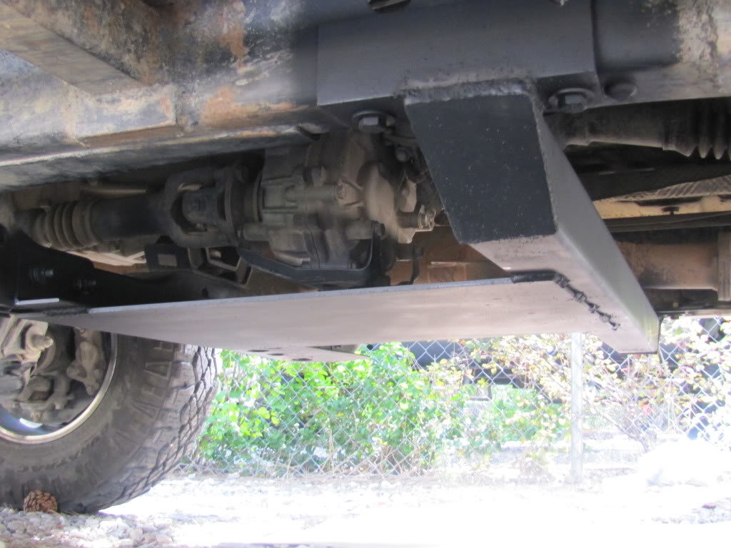

    oh yea so ATO skid is on, fit kinda sucked... IDK why... rear holes were off by about 1/4" i had to modify the mounts...
    probably my fault so i cant dis ato because the skid is seriously beefy!!!
    may have tweaked my xmember a bit before i got the skid. anyway, it doesnt matter, i modified it and its on now...
    so yea, im armored, locked (in the rear) lifted, so i guess rubicon, summer, 2012 im ready...
