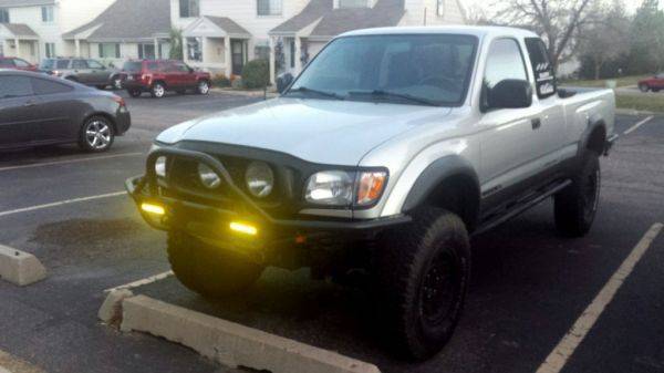

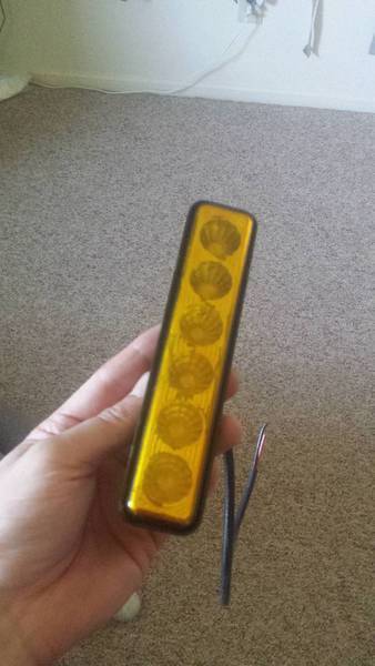

    added some blitzpro amber lights.

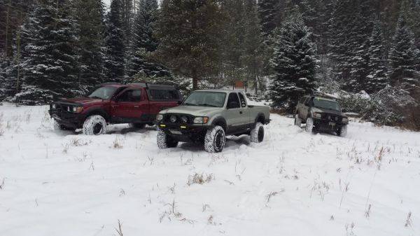

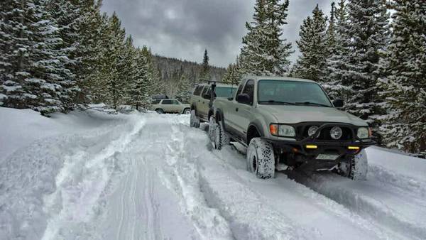

    Snow wheeling
    7 mile pass, and dead man road

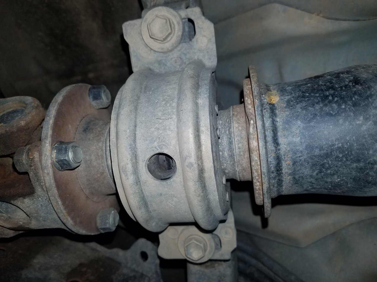

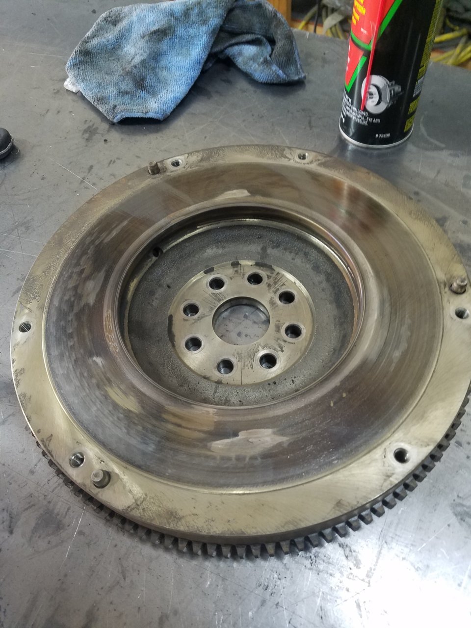

    20191127_120045.jpg 20191127_125927.jpg 20191124_160456.jpg 20191124_154126.jpg 20191127_082057.jpg

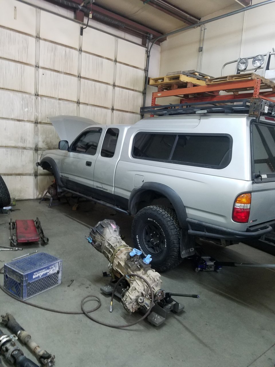

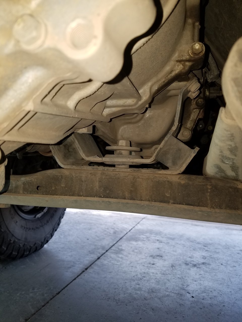

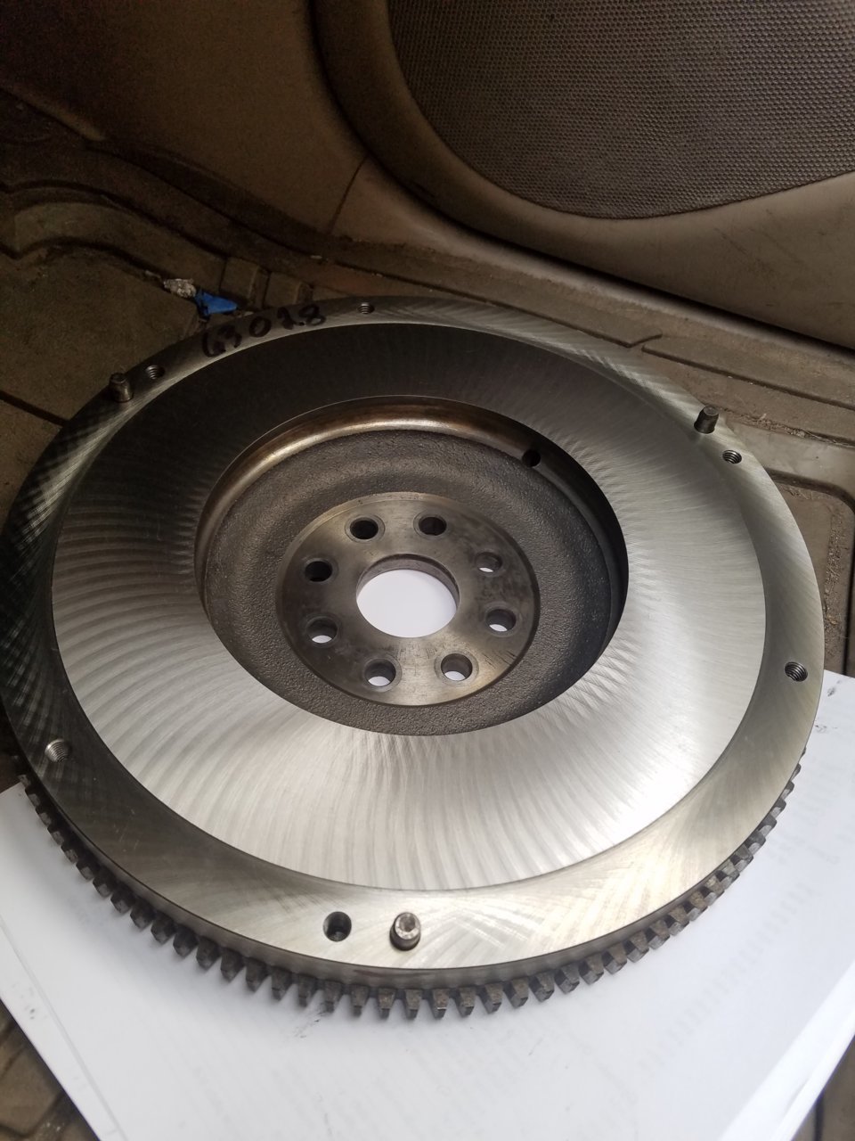

    12/2/2019

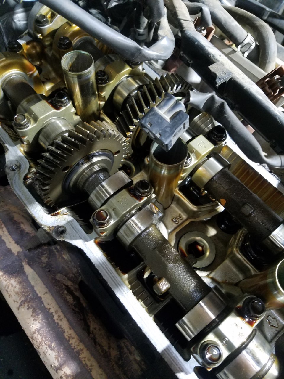

    Replaced clutch, flywheel resurfaced, carrier bearing, rear transmission mount, slave cylinder, rebuilt the starter
    (Just my way of keeping track of maintenance and changes.)

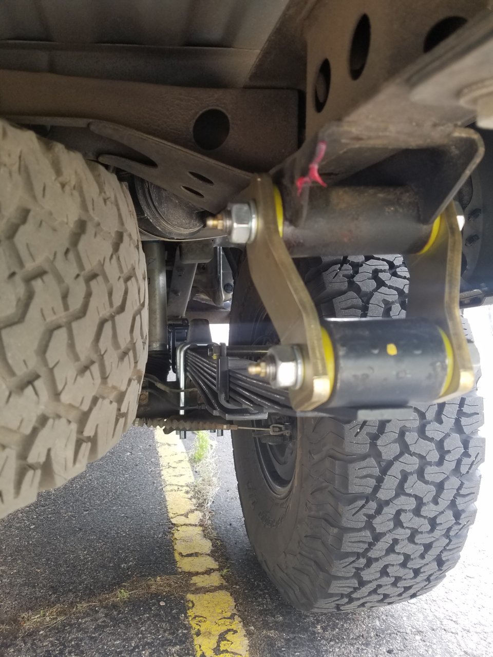

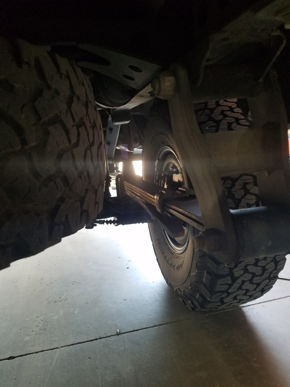

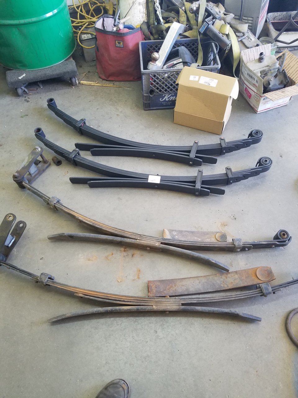

    May 2020:

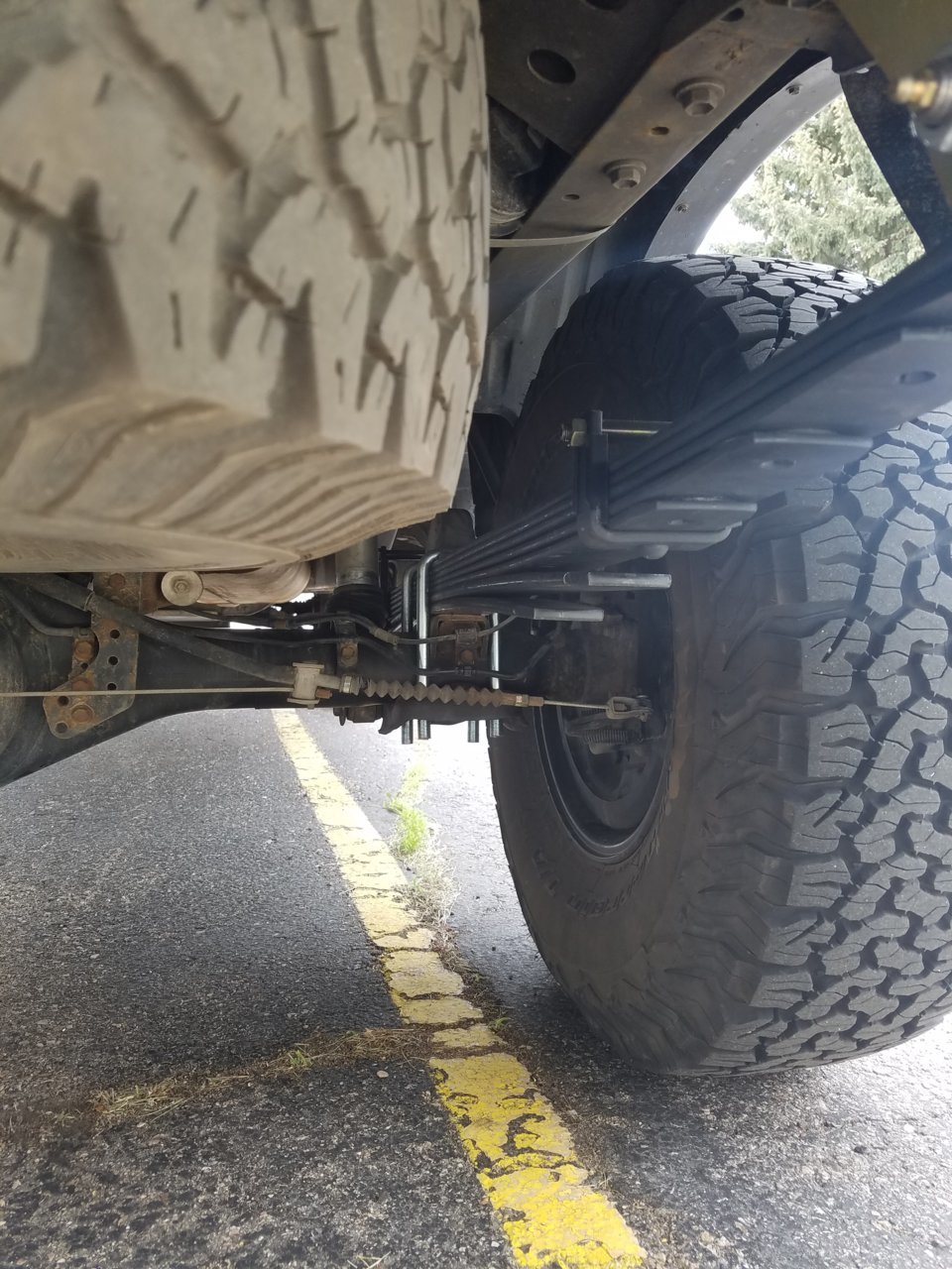

    OME Dakar leaf pack to replace stock leafs + Broken AAL's + long shackles with hardly any bushings.
    Ride feels the same, but I need to do the OME-D43XL AAL to beef up the pack for the weight I have in the back. I wasn't really thinking I met the criteria for the extra leaf but after getting it off the stands it squatted down quite a bit and feels soft.
    One week later: Added the AAL and its a lot better now. Height and firmness are much improved

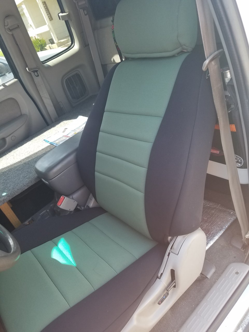

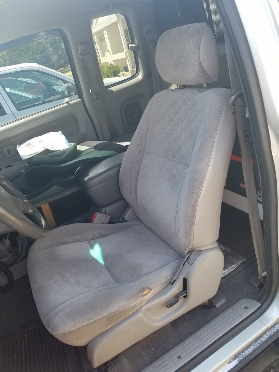

    8/13/2020 Wet Okole seat cover

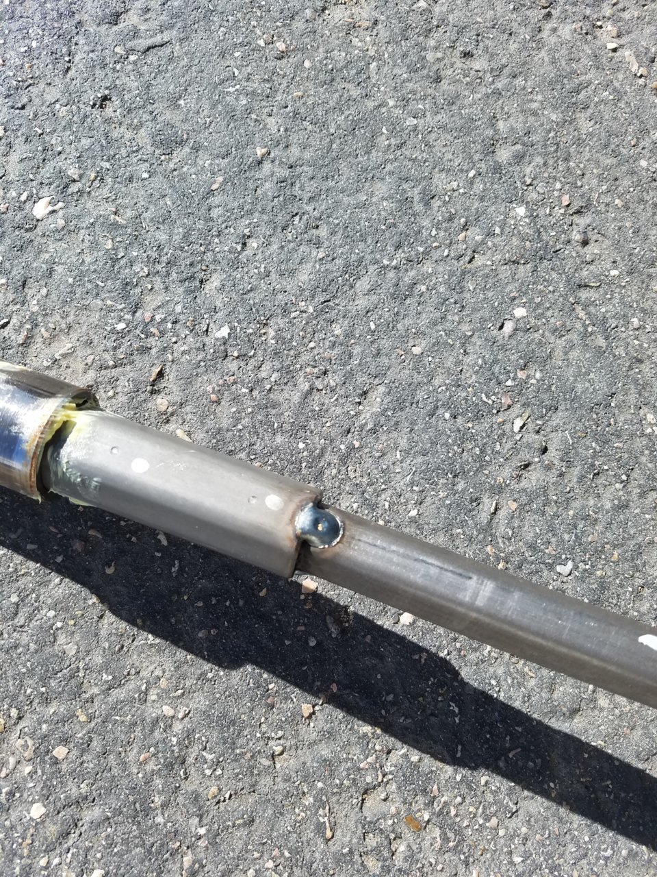

    Did the tack weld mod to tighten up the steering, and later replaced the valve cover gaskets @214000miles

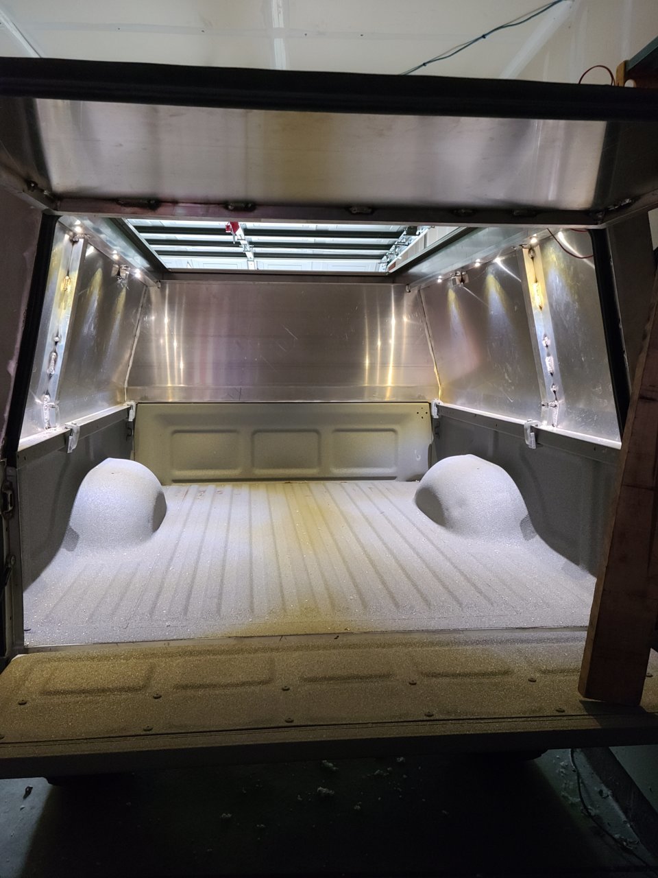

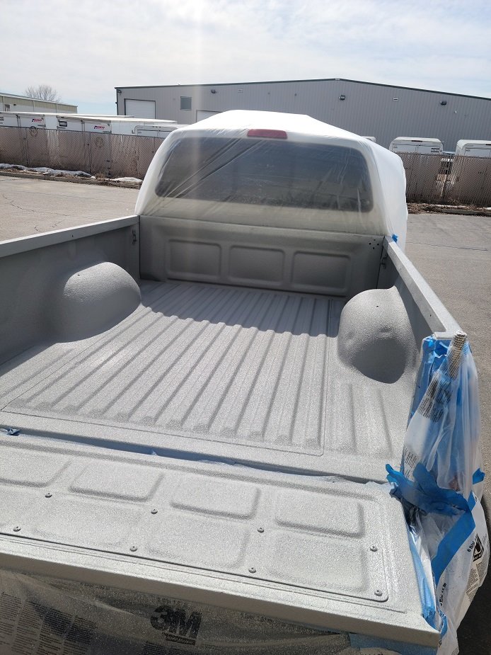

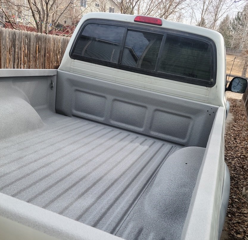

    Used raptor liner to coat the bed. Made quick work with a nylon cup brush to rough every bit of it, blew out with air, washed with alcohol, then started to blast away.
    Used 6 quarts of raptor liner with dove grey tint. I went with a lighter tint because I am eventually going to have a camper on it and didn't want a black interior.20210306_140211.jpg 20210307_111211.jpg 20210307_134553.jpg

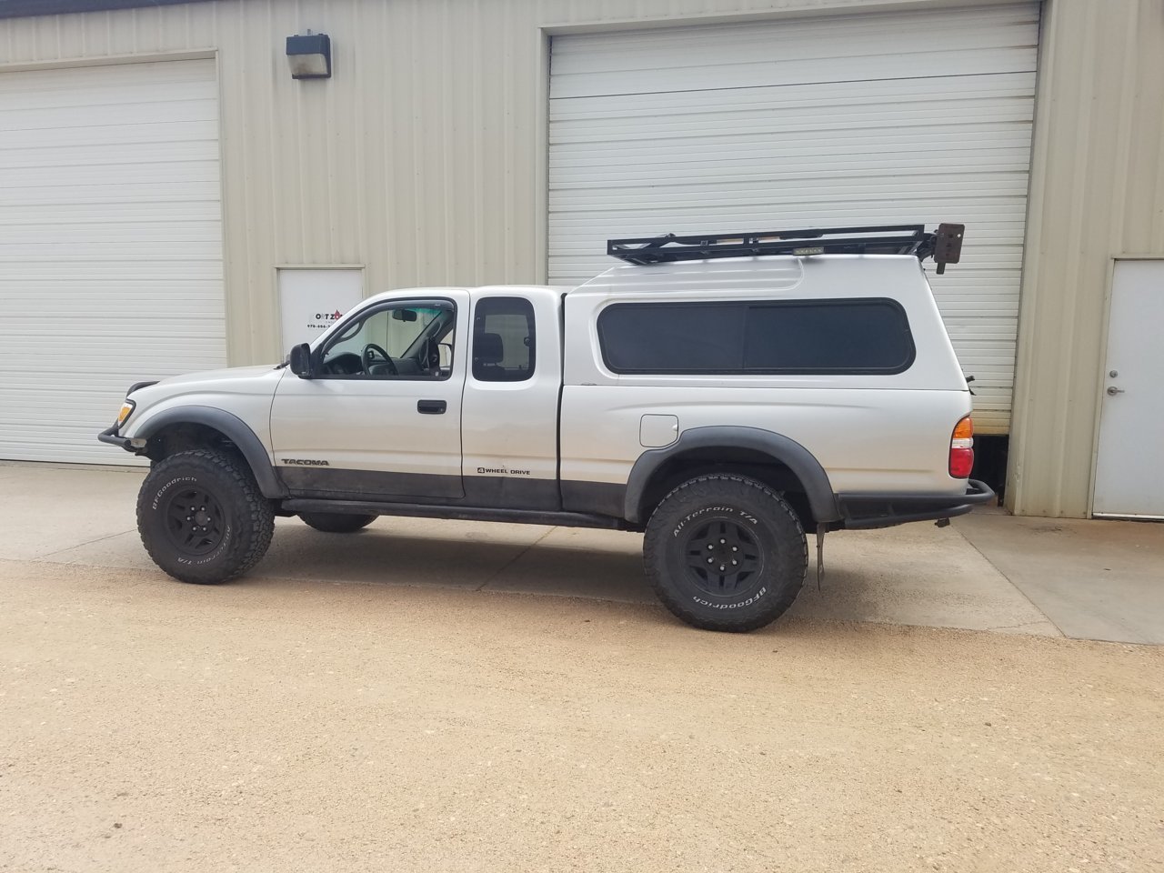

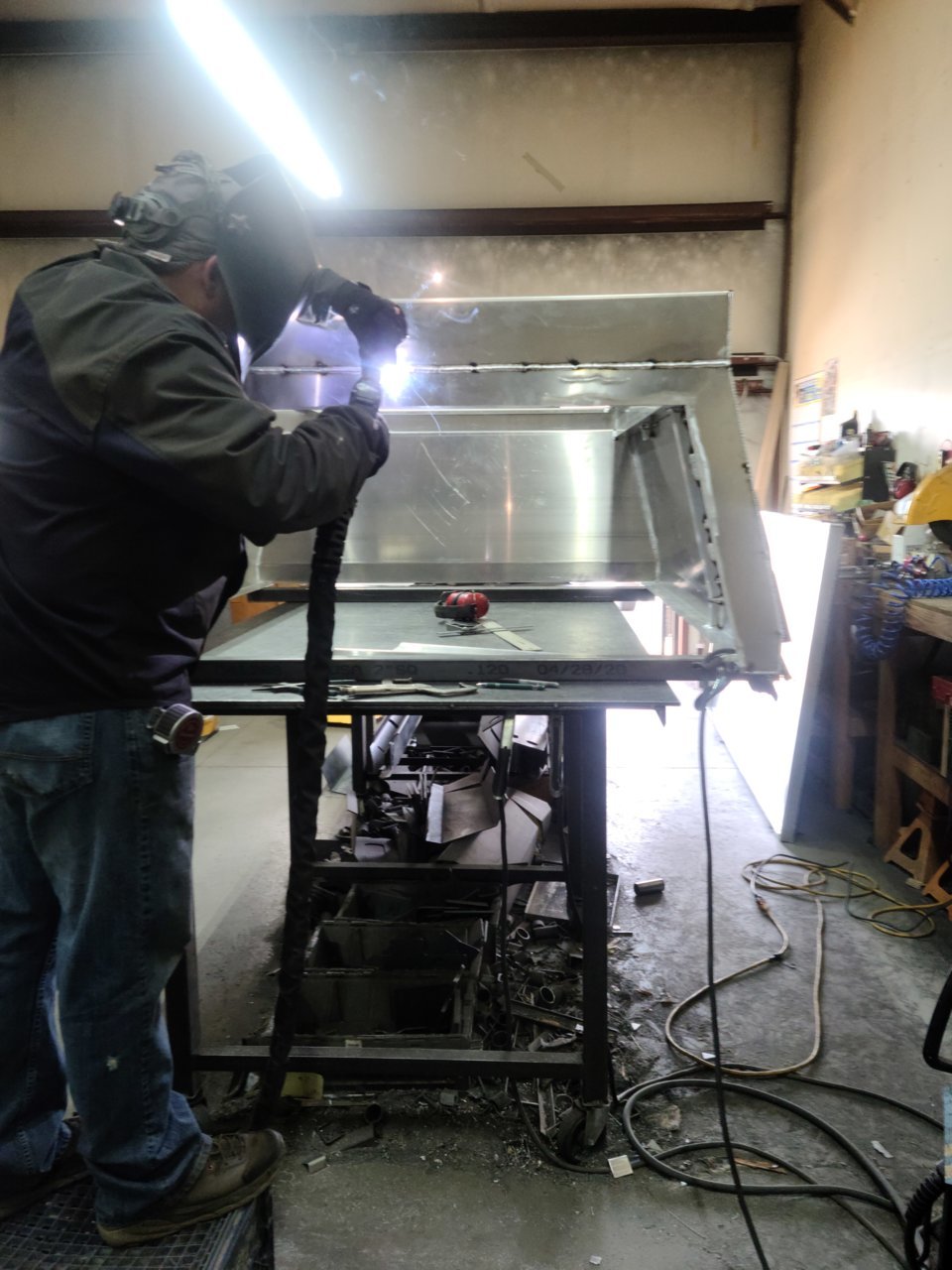

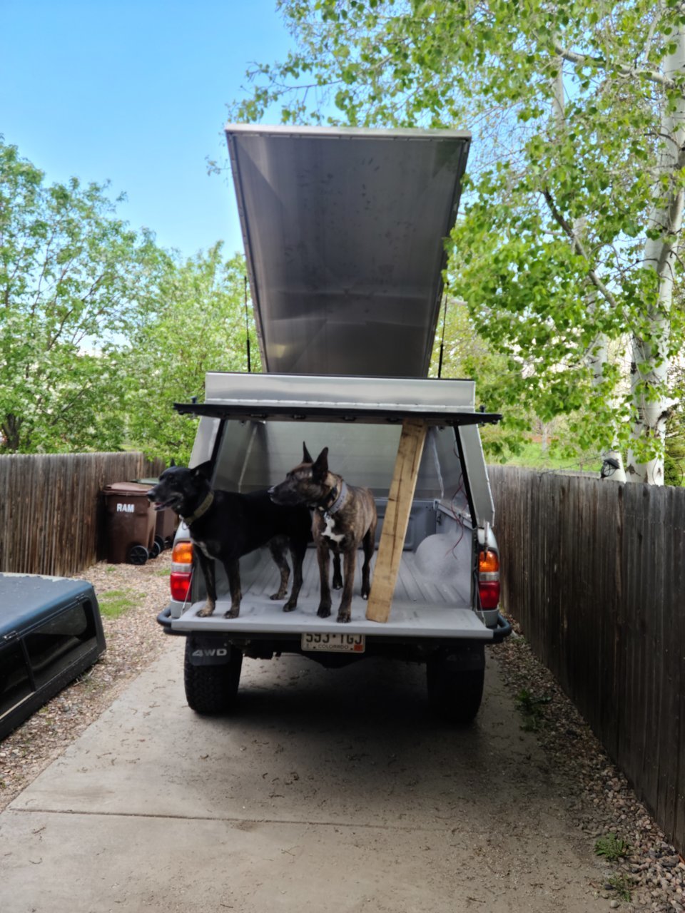

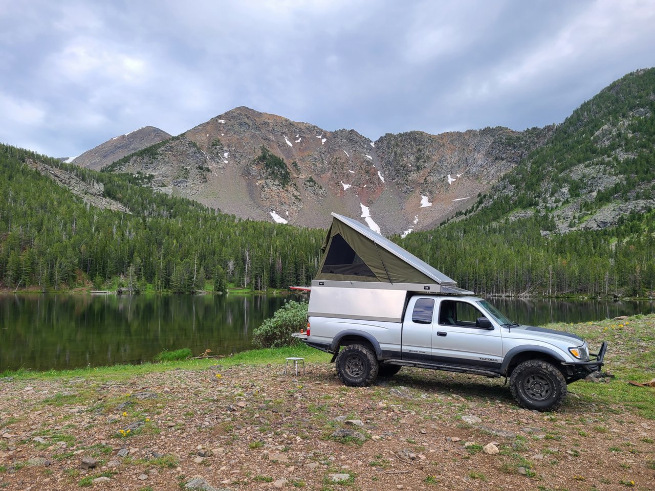

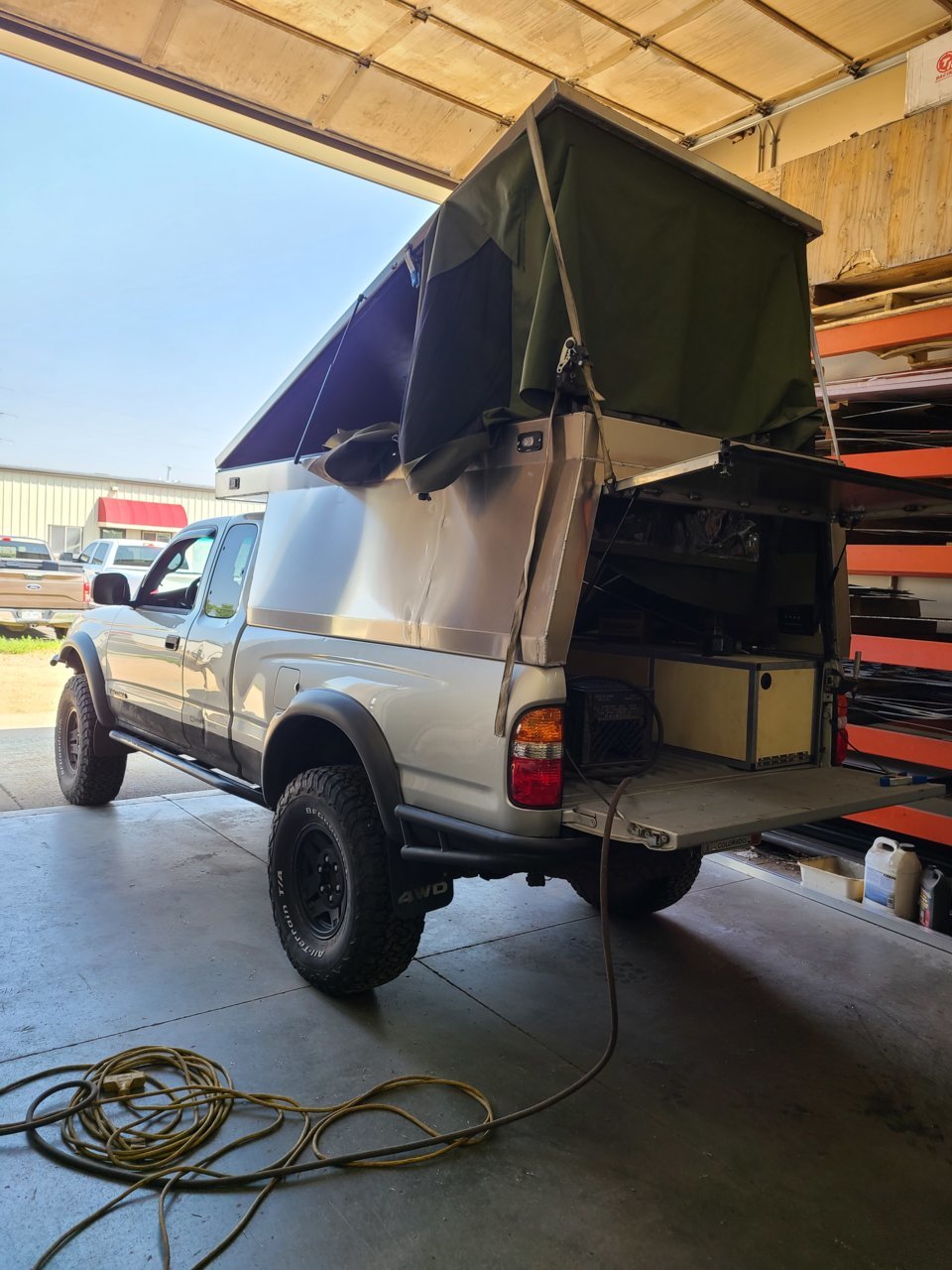

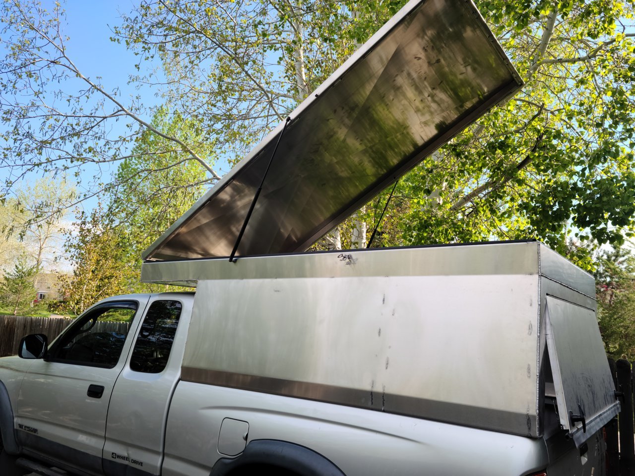

    Finished the Topper!

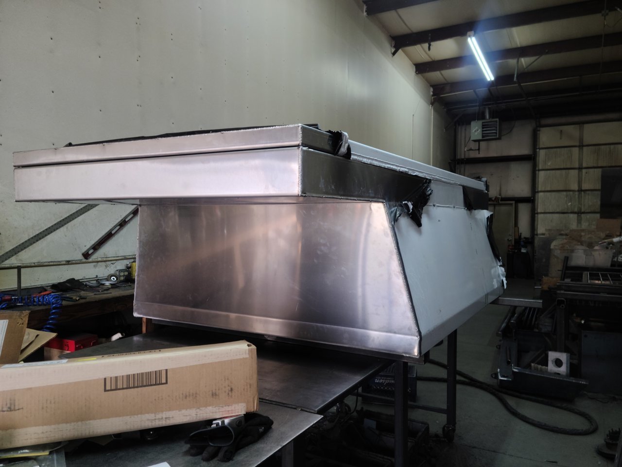

    Some of the building pictures

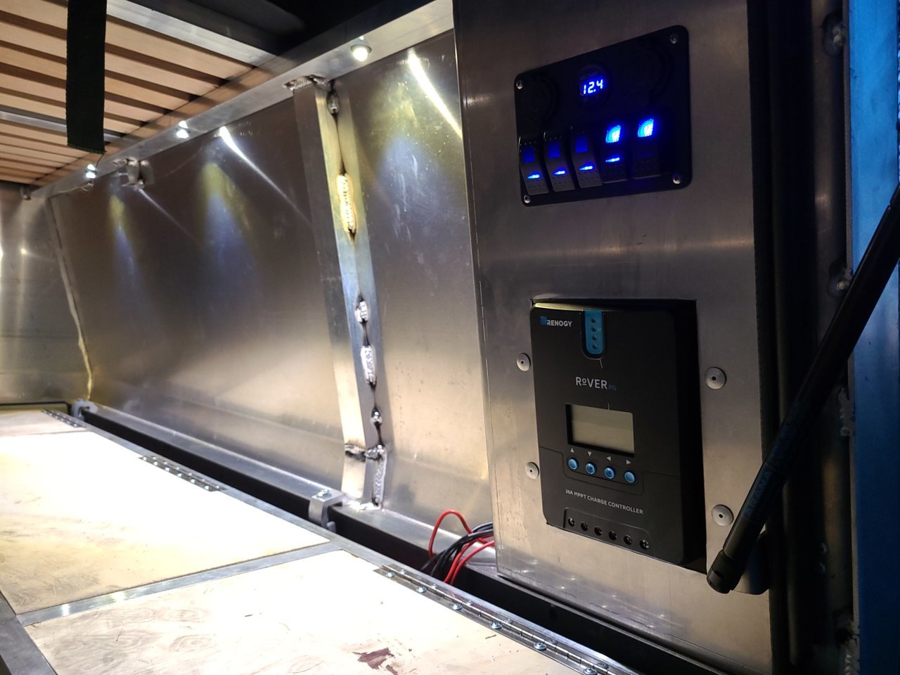

    Just a little update to this quiet build

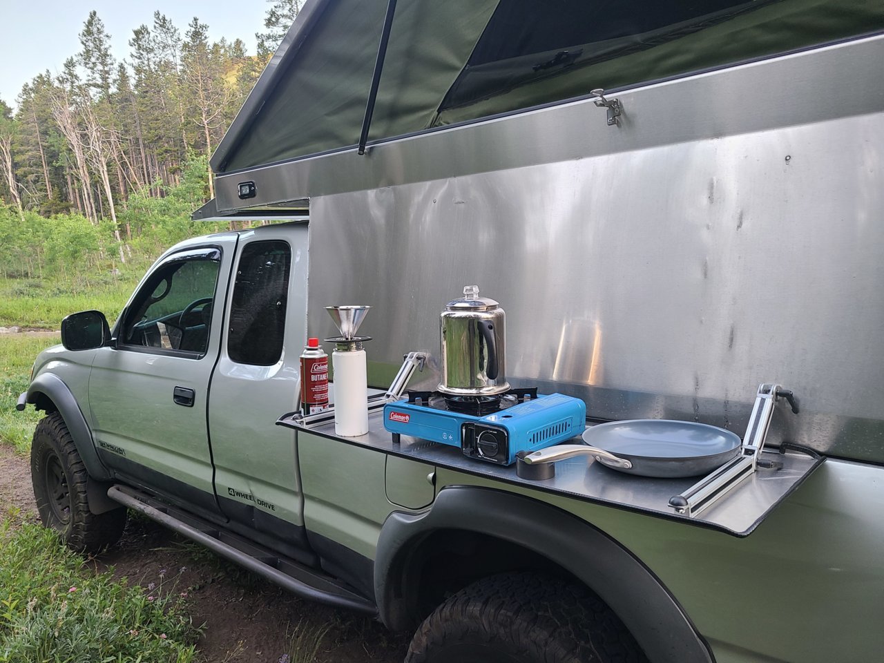

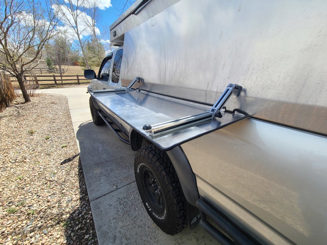

    How did you do your folding table?
  18. Sep 7, 2022 at 9:56 AM
    #58
    Rucas
    Rucas [OP] 1st gen
    Dec 5, 2009
    #27040
    4,297
    Lucas
    1st gen. 4x4
    Custom Aluminum Camper
    I just did it out of some 1" 80-20 parts. It supports against the camper at the bottom when it is down. To fold it up, I straighten out the middle joint and lock it in place, then its flay and I fold it up against the camper and lock the first joint.
