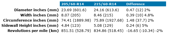

    You probably wont even notice the difference.
    gotoman1969 and Ridgerunner[OP] like this.

    Good stats that mirror what Ghost said thanks! Glad already I posted here. I'm lucky Goodrich still builds those TAs. The brands I saw otherwise were flat weird-Nankang, Federal, Achilles? Nope.
    98tacoma27[QUOTED] likes this.
