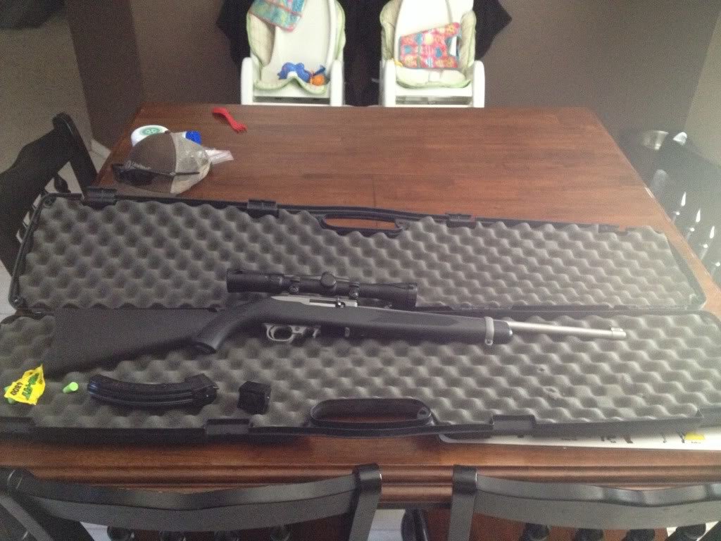

  6. Sep 24, 2013 at 11:51 AM
    #586
    RideFast
    RideFast on the flats.
    Jul 31, 2009
    #20433
    1,145
    Jesse
    Albuquerque New Mexico
    Tacoma
    Here we go, I have had my 10/22 a few years now. All stock except for the simmons scope. I just ordered my first mods.
    kidd auto bolt release
    kidd bolt buffer
    Set me back $19
    Not quite sure what to do next? What are the must have mods?

  7. Sep 24, 2013 at 12:02 PM
    #587
    Racer X
    Racer X Well-Known Member
    Jul 9, 2009
    #19470
    132
    North Carolina
    07 FJ Cruiser
    Trigger job! The stock 10/22 trigger is around 8 lbs of pull. They are much better at 2.5 lbs. A friend of mind just had his done by Brimstone Gunsmithing and it came out real nice, and was only $70. You can get a drop in kit for about the same. Also, polishing all the internal parts of the bolt will make it much smoother. Look on YouTube, there are all kinds of how-to videos out there.
  8. Sep 24, 2013 at 12:17 PM
    #588
    Zombie Runner
    Zombie Runner Are these black helicopters for me?
    Mar 13, 2008
    #5246
    15,074
    Kevin
    Wichita Falls, TX
    2011 taco, sport 4x4
    oil change...
    Very nice. Ive been thinking about getting another 10/22 to keep a factory stock and barrel on and just doing internal upgrades on.
    Nailed it. My grandad did a trigger job on mine years ago and its much smoother and lighter than factory.
    For the bolt all you need is some steel wool and some time :D
    as Racer said, just check out youtube and http://www.rimfirecentral.com/forums/index.php
    for more help.
    I would also do an upgraded extractor as well
    http://www.hawktecharms.com/Volquartsen-10-22-Exact-Edge-Extractor-p/vc10eee.htm

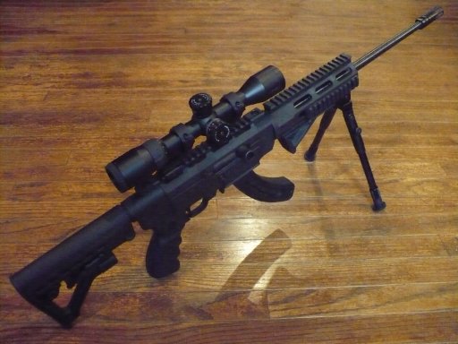

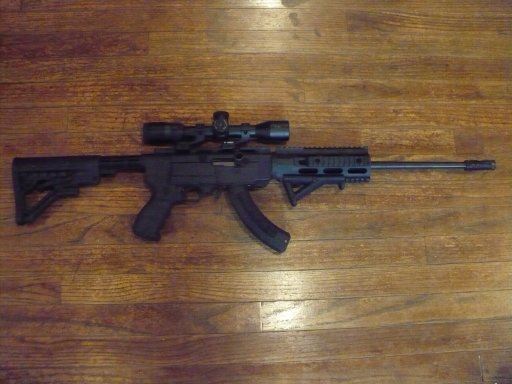

  12. Sep 24, 2013 at 7:04 PM
    #592
    Snowbrdr1220
    Snowbrdr1220 Well-Known Member
    Jul 26, 2012
    #83456
    696
    PA
    13 DC TRD Off Road NBM
    Here's my tactical 10/22, bought it as a basic carbine model. It sure is a sweet shooter, everyone who has shoot it so far handed it back to me with a big grin on their face. :D
    Archangel 556 Stock Kit
    KIDD Trigger Job Kit
    Volquartsen Exact Edge Extractor
    Volquartsen Auto Bolt Release
    Volquartsen Recoil Buffer
    Superior Concepts Charging Handle
    Tactical Innovations Flash Hider
    MagPul AFG2 Foregrip
    MagPul L5 MOE Side Rails
    UTG Biopod
    Nikon P-22 Scope
    Ruger BX-25 Magazines
  13. Sep 25, 2013 at 4:49 PM
    #593
    Runn0r
    Runn0r Well-Known Member
    Jan 7, 2013
    #94656
    489
    NC
    07 Prerunn0r
    How is that Archangel stock? ive never looked at one. I got the BC stock and UTG quad rail and magpul grip like urs, but.....I came to realize that the BC stock is flawed! This guy points it out:
    http://youtu.be/voC_u2Q-R5A
    Mine has the same issue. I dont care much about the other issues but the damn gun body see-saws in the middle even after mods...its the softness of the material. no way it will be accurate. I filed it down and the damn polymer just warps, even with the stock barrel band. I mainly got the BC because it collapses the carbine into the shortest legal length...just sucks that it warps under normal pressure. I may look into this one. Or, I may hack a stock 10/22 polymer stock and attach the BC folding butt to it.
  14. Sep 26, 2013 at 9:18 PM
    #594
    Snowbrdr1220
    Jul 26, 2012
    #83456
    696
    PA
    The Archangel stock is good. I was worried it might flex a little or not fit the gun right. However it fits great, and the polymer is very high quality with no flex at all. The floated barrel on mine is centered perfectly in the hand guard with no shims or mods needed. I would definitely recommend it to anyone.
    The oversize charging handle I have didn't fit with the stock, but I fixed that by just cutting a small notch out of the back of the handle with a dremel.
