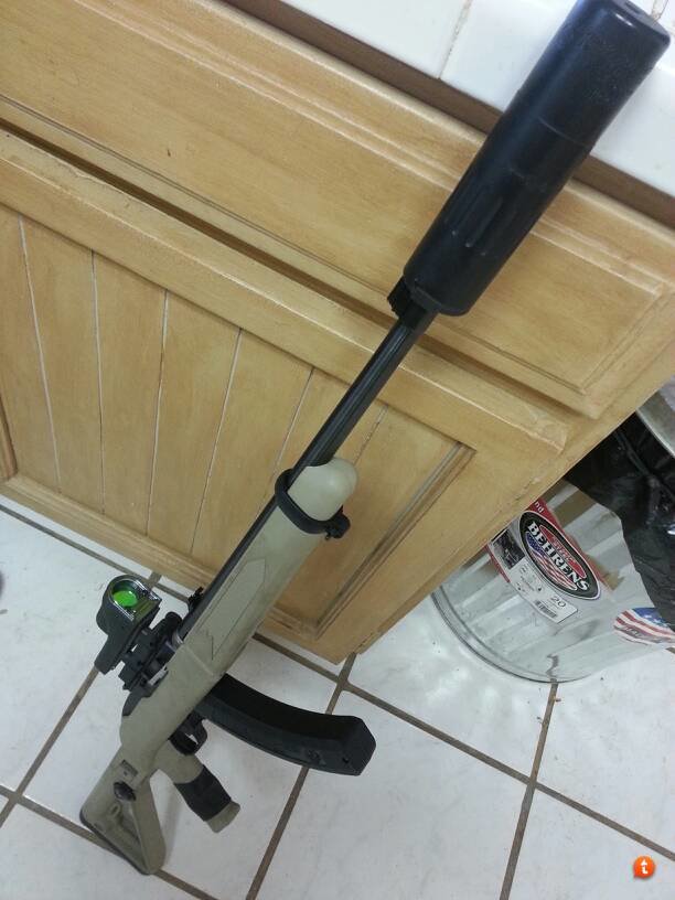

    10/22 Take Down w a folding Stock, and the BX25 round magazine, an INERT AAC demo can for now and a Trijicon reflex.... One of these days I will add a good solid AAC can to this package but it's and AWESOME lil plinker/truck gun....

    Do you plan on shooting a bunch with the suppressor?

    Yep, but I am not going to het a dedicated .22 can rather a .223 can won't be as quiet but will do double duty

    Why a folder on a take-down? If your looking for small and compact, why hang 14 inches of useless crap off the end? Not trying to slam you, just don't really understand the direction you're heading with this build.

    I like the ergos on the folder better than the factory stock, and the side folder makes it even easier to carry in my pack assembled and ready for bunnies. As for the can since its legal here to hunt surpressed it makes bunny slaying a lot easier. Hope that makes sense.

    For now at least this is a decent set up. At some point I will pick up a Ruger Charger thread the barrel and put everything but the stock on the pistol version, making it nice and tiny. And avoiding having to SBR a 10/22. But that will be down the road a bit.

    Not sure of AACs offerings, but I would not recommend using a 223 suppressor on a rimfire. Most center fire cans are not serviceable. .22lr makes a hell of a mess inside the baffles and over time will reduce its effectiveness as it fills with lead and powder residue. I was going to recommend a sealed baffle design or an encapsulated mono core. 22lr is very dirty, just keep that in mind.
