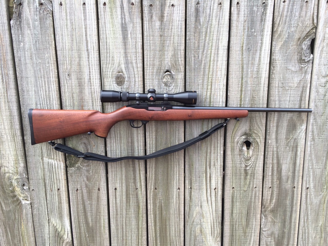

    Two of my very favorites:
    1968 fingergroove sporter,
    Fajen walnut sporter, this rifle placed 6th in Rugers 10/22 50th Anniversary redesign contest a couple years back earning me a brand new Ruger SR 7.62.

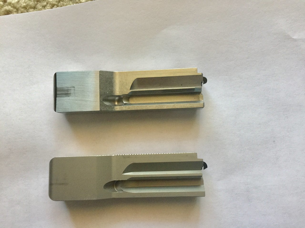

    IMG_8675.jpg IMG_8676.jpg IMG_8677.jpg IMG_8679.jpg IMG_8680.jpg Bolts comparisons top Kidd bolt, bottom JWH bolt both are aceptionally well machine. Note: for stock ruger receiver Jwh bolt seems to slide smoother.
