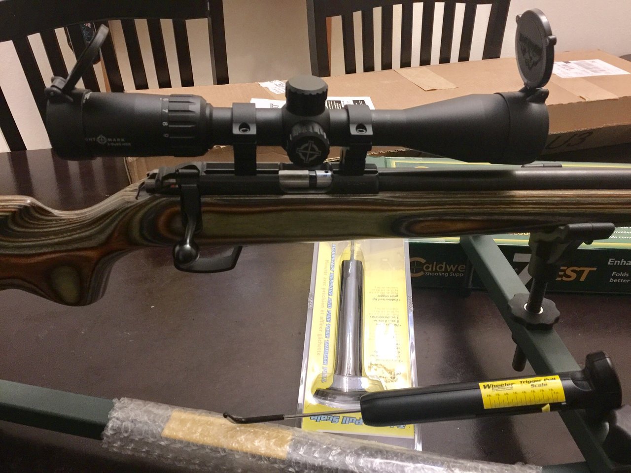

    IMG_8920.jpg IMG_8919.jpg Both Kidd's single stage triggers measured 2.1 lbs
    IMG_8917.jpg Hornet custom trigger 1.7 lbs
    IMG_8915.jpg Ace Hardware spring replacement for Cz455 trigger measured 1.5 lbs

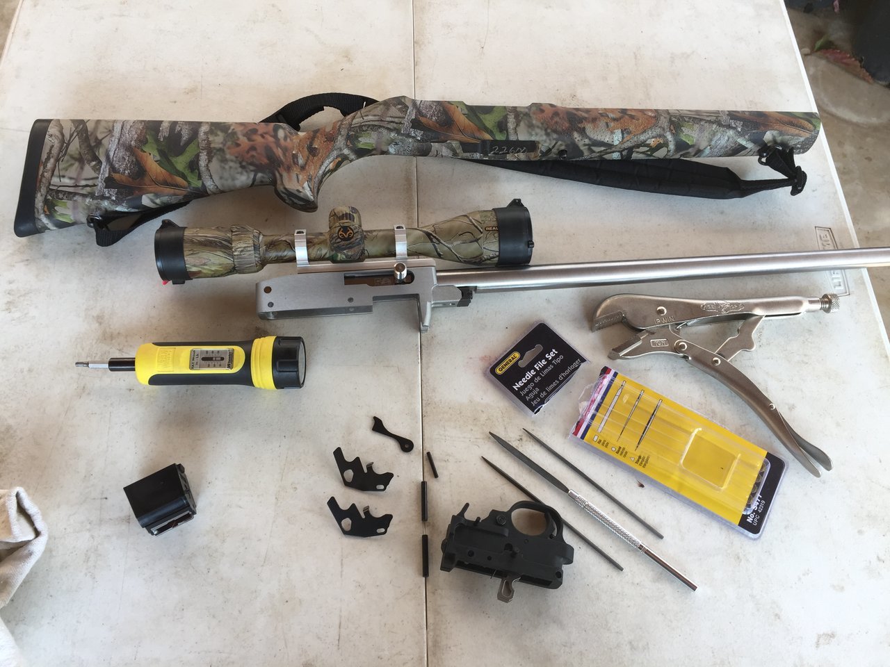

    IMG_8941.jpg IMG_8943.jpg IMG_8946.jpg IMG_8945.jpgModified stock Ruger bolt catchers and the stock trigger from 6+ lbs to a nice crispy clean 2.5+ lbs. Tools to do this job are 600 grits sandpaper, a set of jewelry files and a pair of wise grips with a dirty piece of cloth. Total costs less than $8 plus an hour labor.

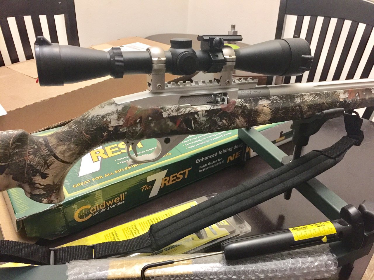

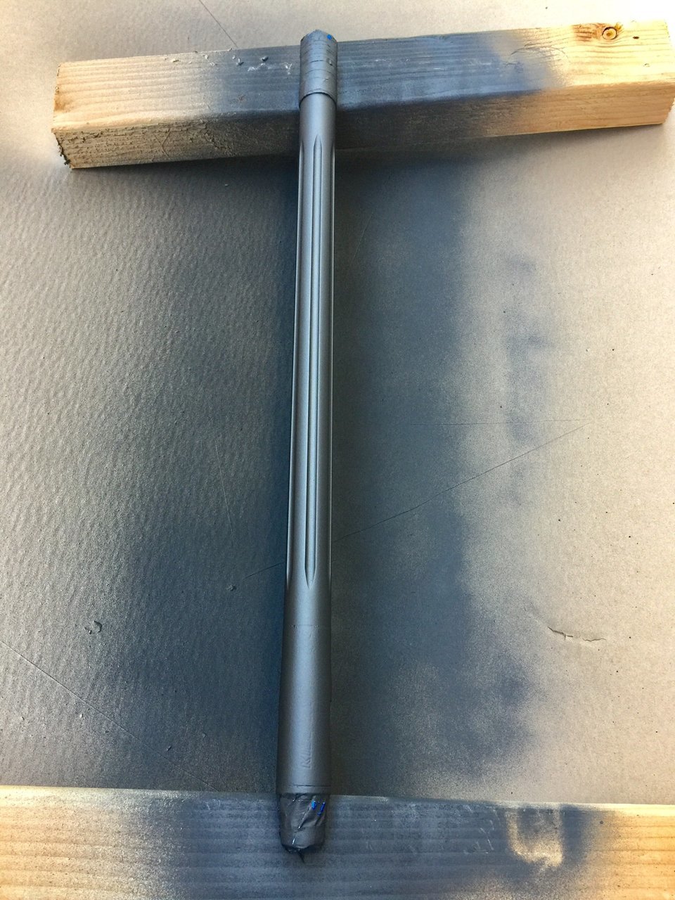

    0C6C97C6-4288-4B8F-BF5C-C3924DB61298.jpg 3B47BB50-33BE-417A-A898-62D507008499.jpg 28E8446A-94F4-4572-A65C-1E13230006F5.jpg When the new receiver is black and barrel is silver..... rattle can does the trick. 2nd Kidd Classic 22lr pew pew pew!

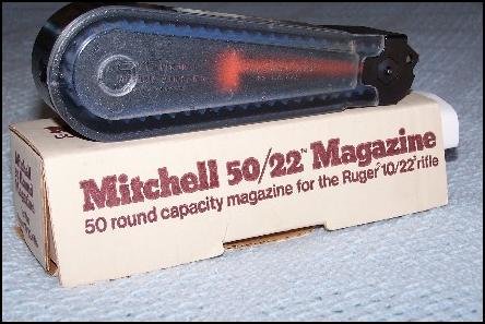

    I don’t have any personal experience with them, however the general consensus is that they are complete crap. Google “Promag 50 round drum review” and you’ll see. If you can find a Mitchell 50 round tear drop mag, they run perfectly.
