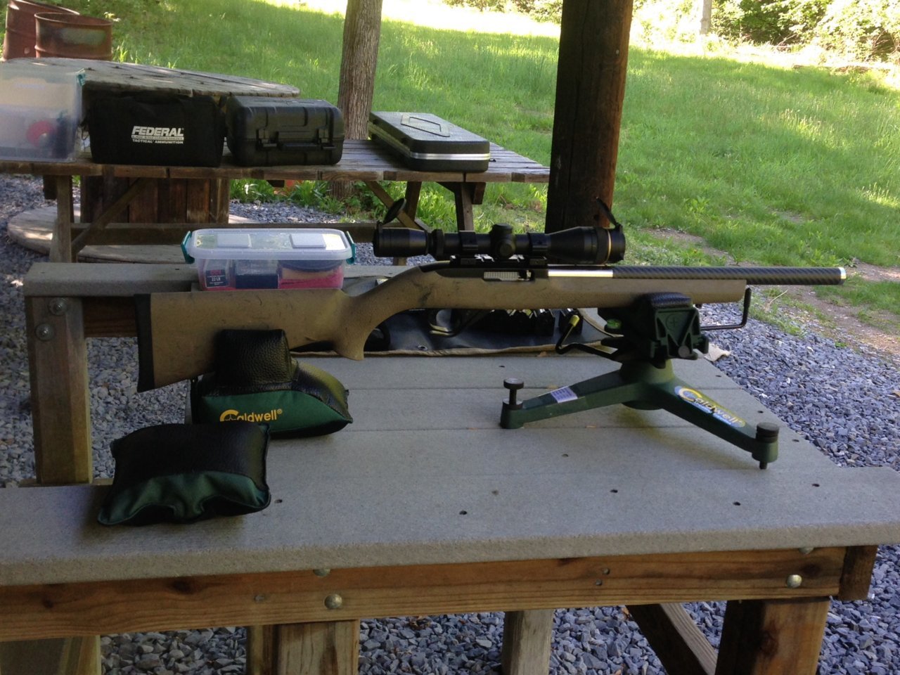

    2F556508-1B34-4DFC-8139-CDB76A4ACC3A.jpg 1344C891-D858-4427-8A54-1683EB98D338.jpg Did someone say 10-22 build?
    Standard 10-22 stripped down, epoxy painted receiver, receiver polished inside, Tony Kidd trigger group set at 1.5 pounds, Volquartsen carbon fiber wrapped tuned bbl, barrel is floated up to about one inch from the receiver, Volquartsen exact edge extractor, Leuipold 3x9 rimfire scope, Hogue overmolded stock, bolt buffer, bolt reworked (jeweled, firing pin pinned, radiused, bolt face squared), Aspirin size groups all day long.

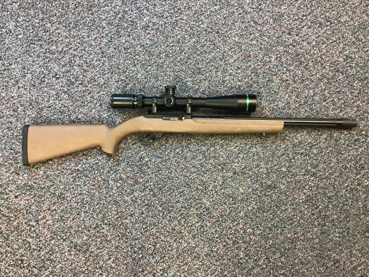

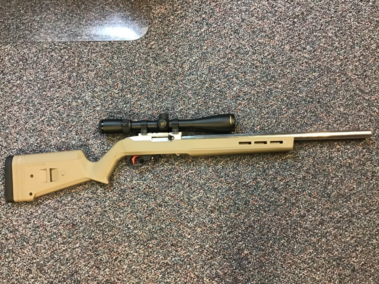

    My memory failed me on the scopes.
    The Charger Receiver, green mountain barrel in the tan Hogue stock has an 8-32x Mueller scope
    The target model in the tan Magpul stock has a 6-18x Nikon
    The target model in the lava colored Hogue thumbhole stock has a 4-20x Athlon Argos scope

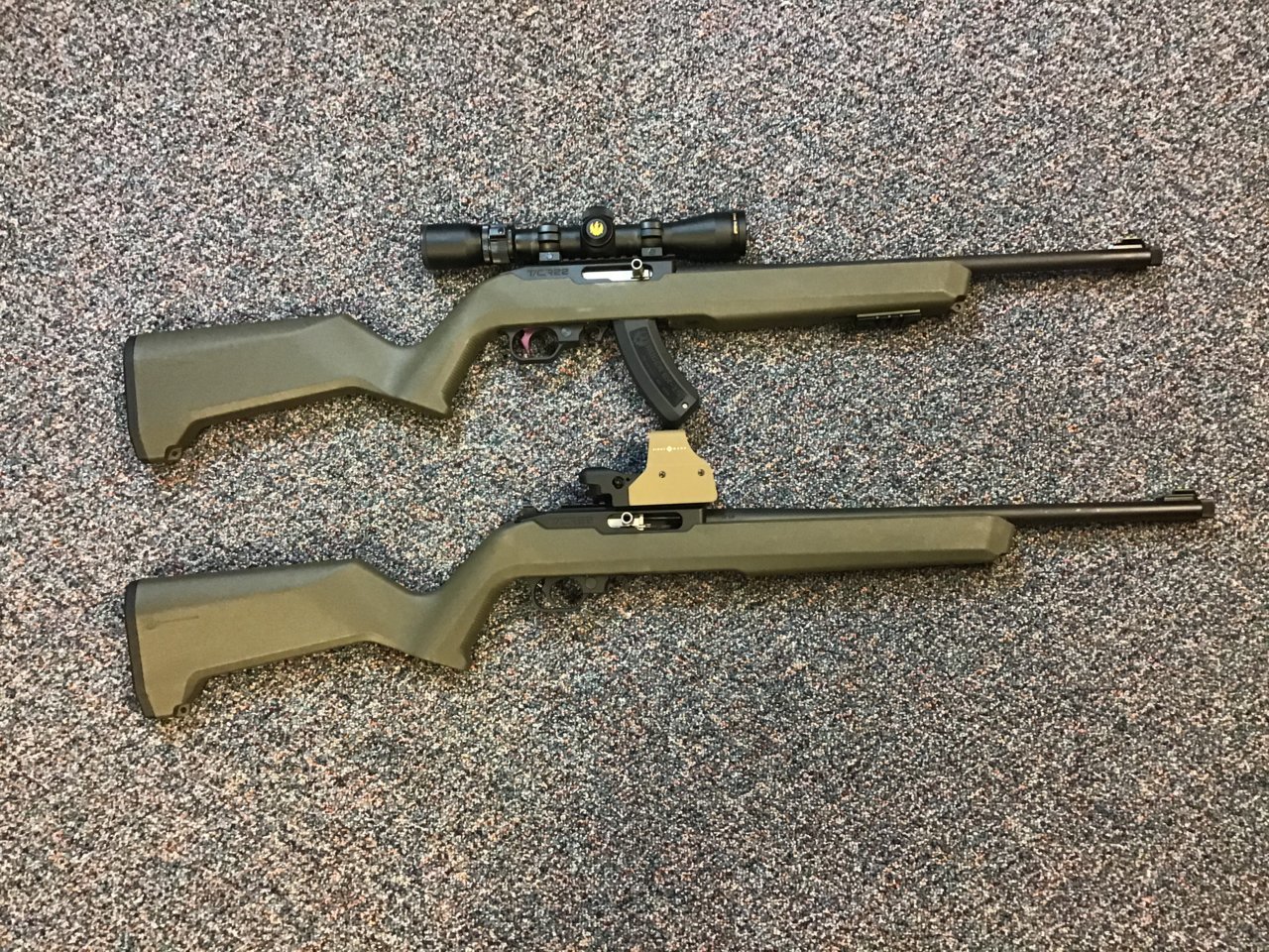

    Top to bottom
    the pair of T/C R22s, one has a 2-7x Nikon scope the other has a Sightmark Ultra Shot Plus sight

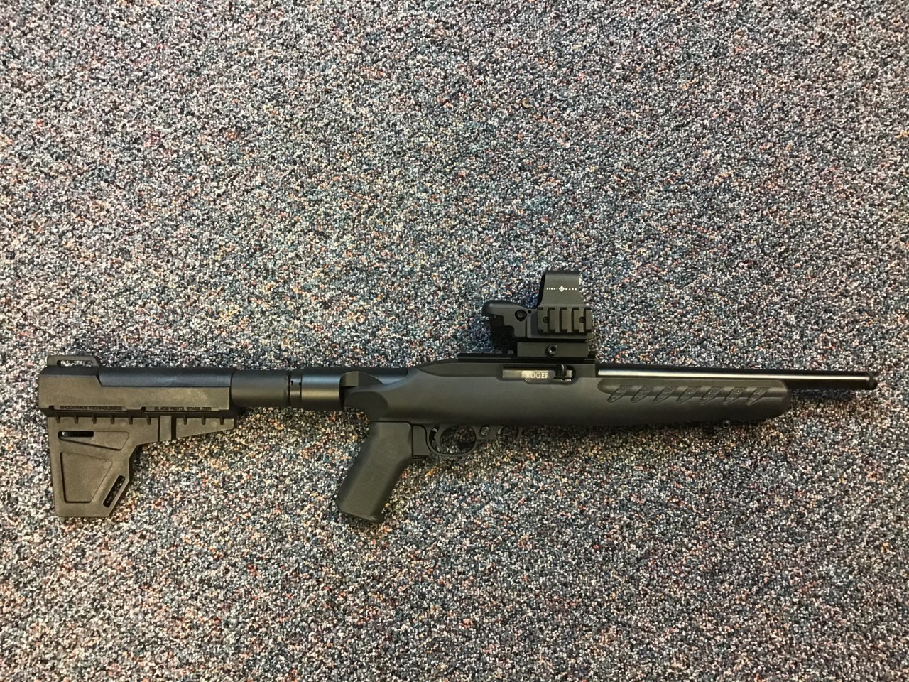

    And finally the Charger, copper customs adapter and Shockwave blade, Sightmark Ultra Shot Zombie sight
