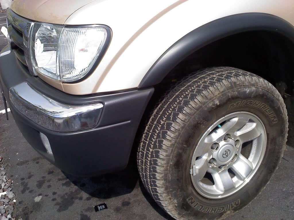

    Michelin LTX AT2's are great as well

    If you are looking for a good onroad AT tire, with good MPG, low road noise, but good enough off road, look at the Bridgestone Dueler Revo. I have not had them, but several friends and some of our work trucks have them, and they appear to be great tires. A little less road noise than the Nitto Terra Grapplers, and long life.

    I didn't run into any problems with them, they had great grip on wet asphault (something I miss now that I have the KM2's) and were whisper quiet.
    only downside is their price
