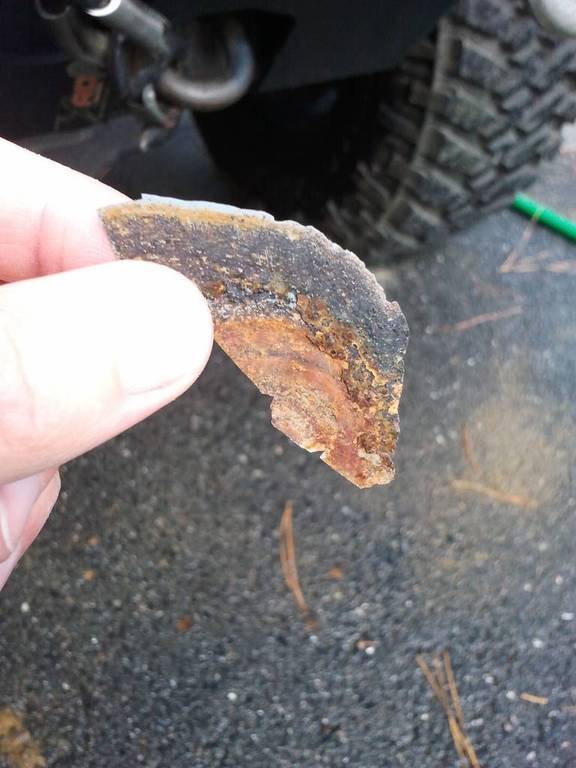

    And god damn allpro bumper!!! Its freaking peeling all over. Guess their new PC didnt work. Lasted much longer than the 1st one I guess

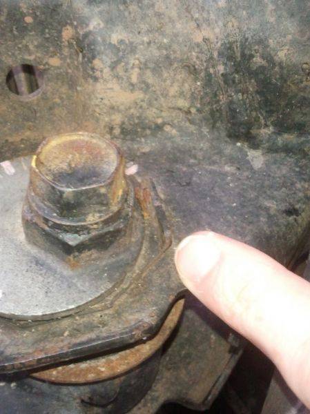

    Truck is off for another alignment today. Spending way too much money on that shit compared to how much I drive the thing.
    I have noticed no matter where I take it there's always space around the alignment cams. Even looking at the gussets offered by a few companies there's still space on one side or the other... which on a hard hit they're going to move. Either they arn't using the correct size spacer or only one option is available. Going to give the 8 cams a tack weld today after I check everything to keep them from moving. Shouldnt be a problem to knock the tack out if I need an alignment later on. Hell one of them the little ears are almost flat :mad:
