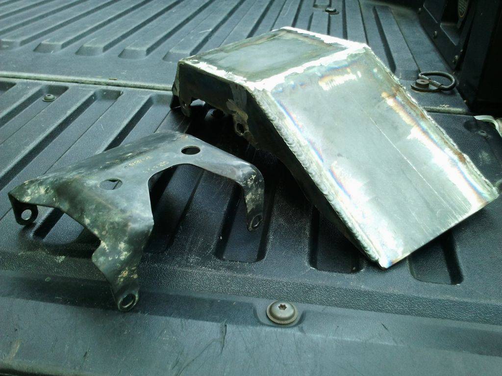

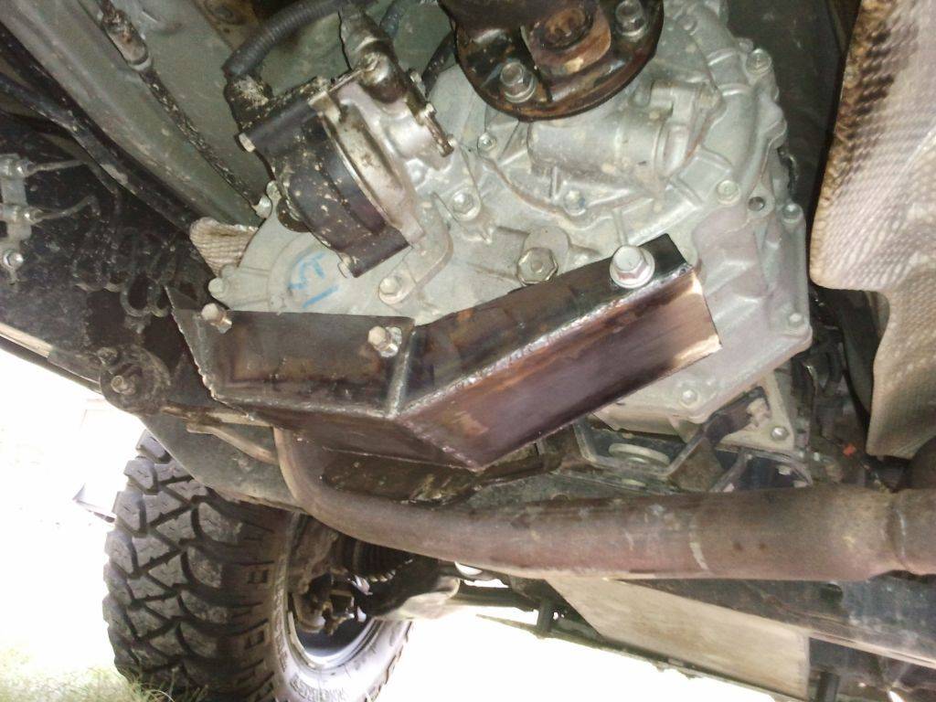

    Couldnt get my transfer case skid to work like I wanted... Was planning on extending my alum transmission skid. It wouldnt tie together without re-doing it... which wasnt going to happen. Made this instead...

    mmm beefy
