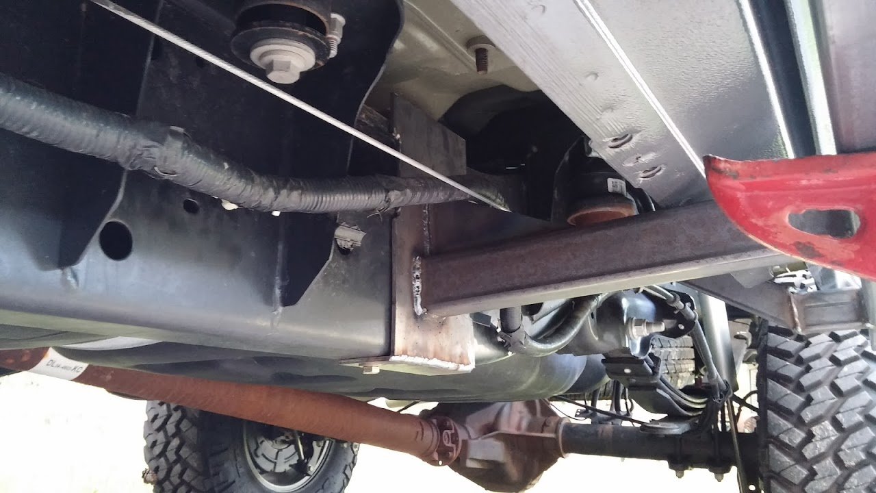

    Reinforce the rear frame where the bumpstop mounts. Pretty obvious weak point.
    Nice use of the intercooler opening in the front bumper. :thumbsup:

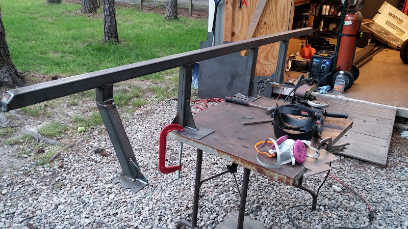

    Tested with the high lift yesterday. Not really happy with how much they flex. Damn long legs... Think ill add some additional gussets in spots wher I noticed some flex and run them anyways. There's zero options out there in the slider world for these trucks so I dont have a choice. And im not welding to the frame because I cannot paint inside. Dont want another frame rusting from the inside out like the poor yota
    Not stepping up to 3/16 wall tube either. They would be god awful heavy.

    ^You sure that's aluminum? (Check with magnet.)
    You may be able to find rectangular tubing for the legs to reduce flex.

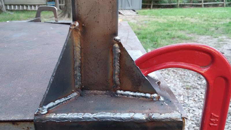

    Making progress... time to start the other side

    good looking welds, im looking to get a bigger welder myself

    Im loving this miller 211! I need another plasma cutter though. Cutting all this plate with cutoffs sucks :bananadead:
