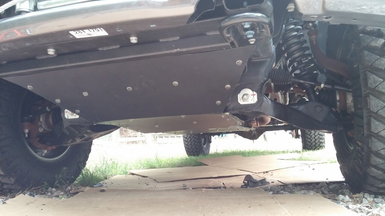

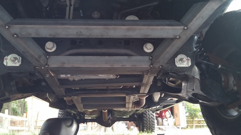

    Got one slider painted and on this weekend, the other one's tacked up and ready for gussets and welding.
    Also started the experimental hdpe skids. Not sure how these will work out but ill keep the info here like I did with the aluminum skids I did for the yota... which worked great btw. The 1/2" hdpe seemed just as tolerant to weight as the leftover 1/4" aluminum I have. All the info I have from race teams say they either skin the backside with a solid piece of steel, or do a skeleton type framework. To keep things lighter I opted for the framework. If its shit... which it might be. I might try some steel sheet behind it. Granted im not going to be launching the truck into rock gardens it may be just fine :crapstorm:

    wow! looks like a bit of work but will pay off i'm sure. i bottomed mine out and put a dent in the exhaust and cross member last wknd.. then i got to thinking that big open hole with the transmission exposed needs to be covered. wish i had the space to have the tools to work on things like you. nice work!

    Yea... worried about a stump or log poking up there out at the property. The rears... cant remember how tight they were. I guessed when I stuck them back together.
