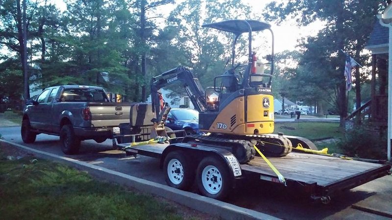

    Fatty's got a new job... did great on the initial pull. The v8 is where its at :D

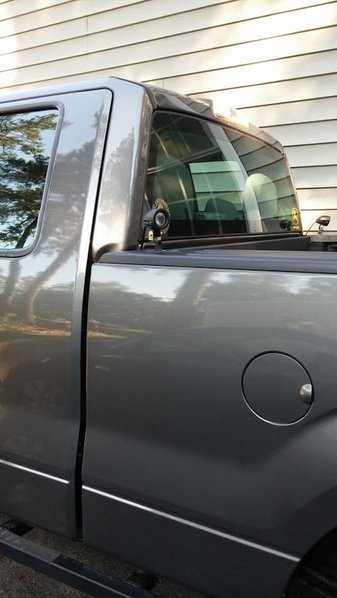

    Changed out the big rectangle lights to some smaller round ones. Dosnt look as obnoxious now o_O

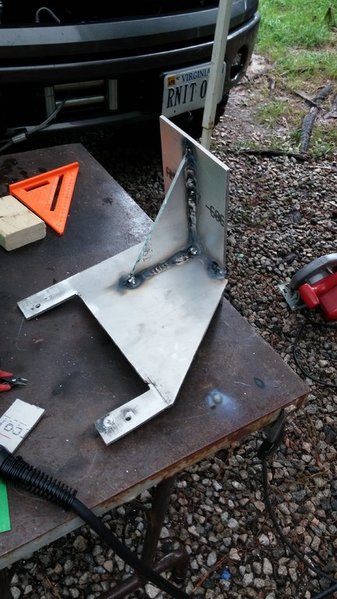

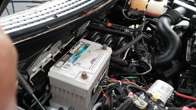

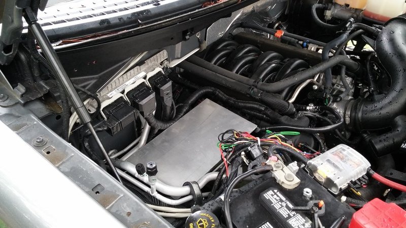

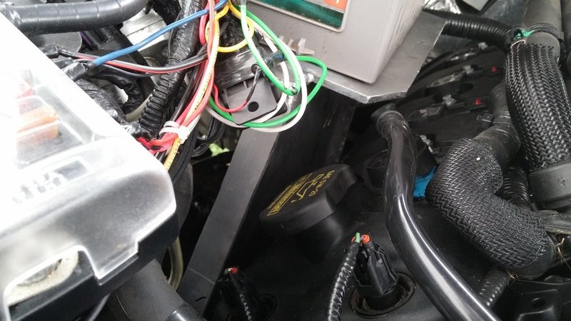

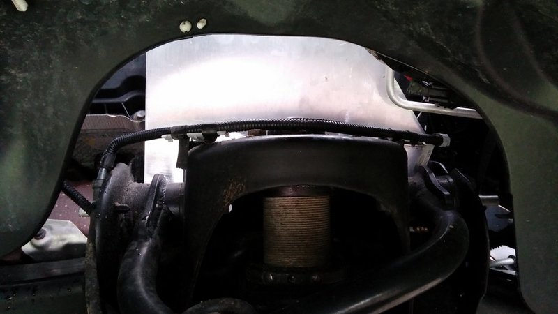

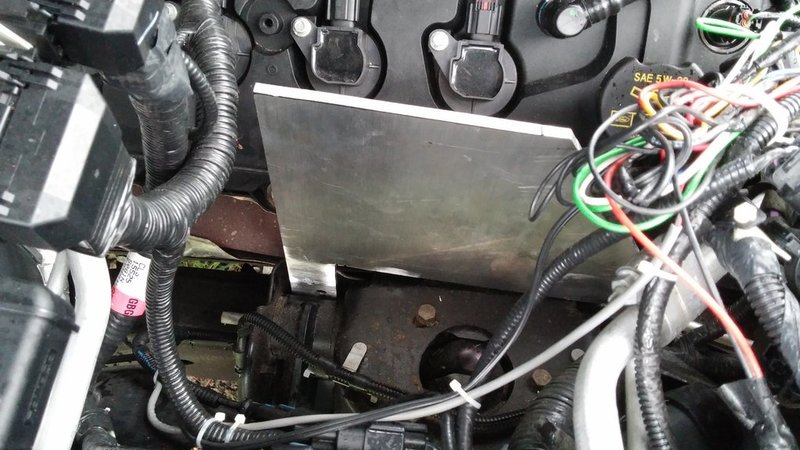

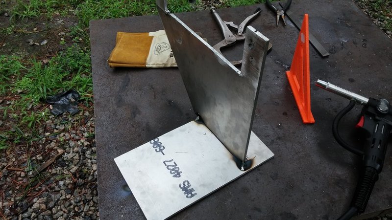

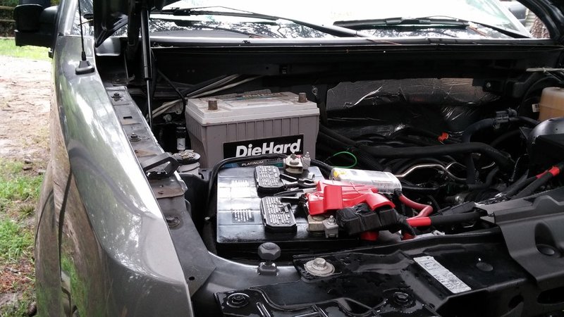

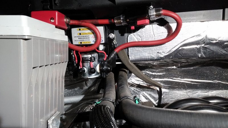

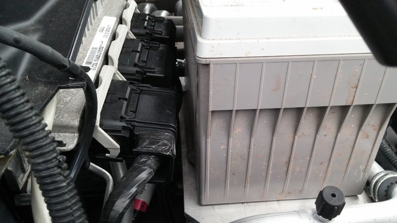

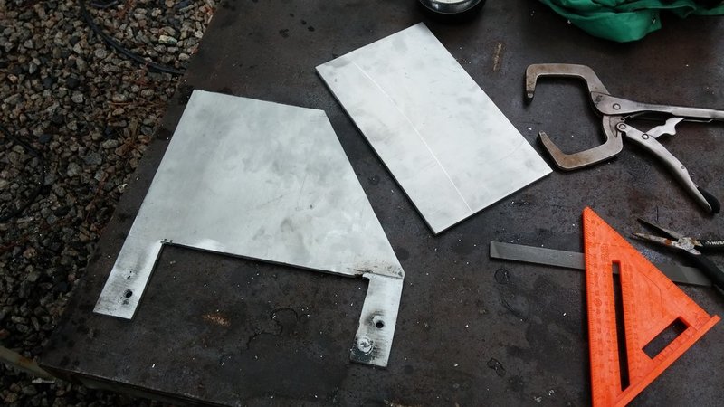

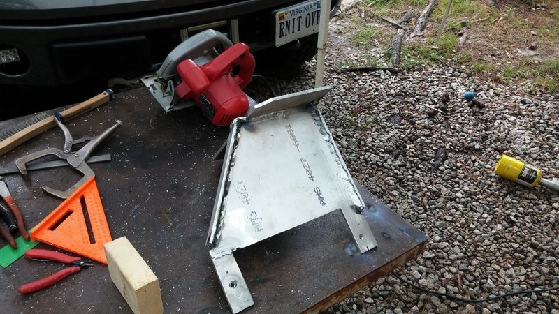

    Finally got the dual batt and the National Luna controller in(Thanks to @SoutheastOverland). Dont hate the welds, havnt done alum since I had the TIG. Done in 1/4" T6061 I had leftover from the Yota skids
    Test fit and mockup:
    Reinforcements and bracing for the bracket:
    Wiring...

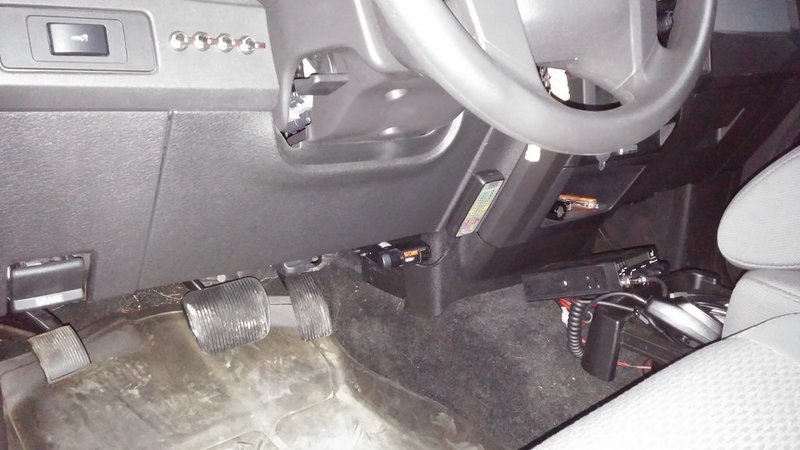

    Only thing im not sure of is if the Luna controller in the cab is supposed to stay on all the time or not. It was still lit up with the batt levels this morning. Hmm

    Where'd you pick up the aluminum? And I assume you're running a separate bottle of pure argon for that?
  20. Jul 13, 2015 at 7:32 AM
    #140
    ruggedT
    ruggedT [OP] The Sticker Guy
    Jun 24, 2011
    #58788
    3,177
    Stan
    Midlothian, Va
    2016 Ford F250
    Diesel on 35's
    From BMG metals - the warehouse by the airport does the Aluminum. Yes my 2nd bottle is 100% Argon. The spool gun is much easier than tig you just gotta get the feel for it. Its like spray painting with a tiny nozzle
