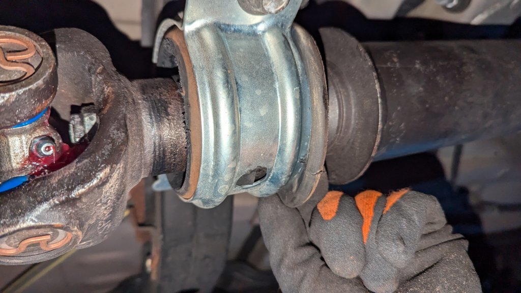

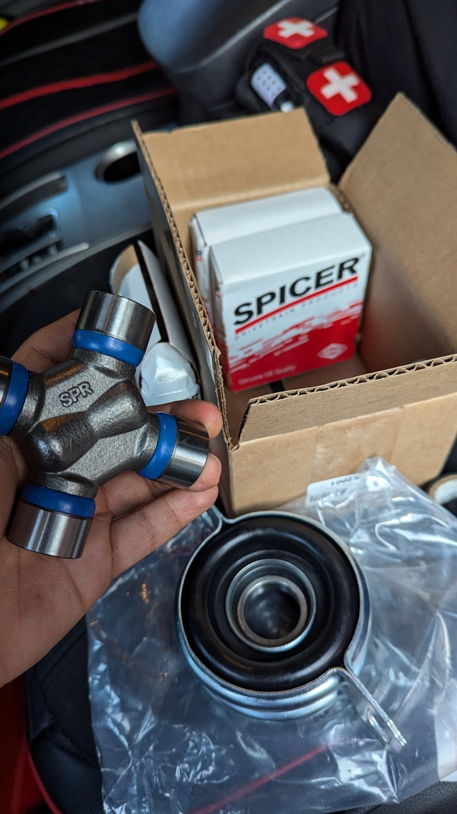

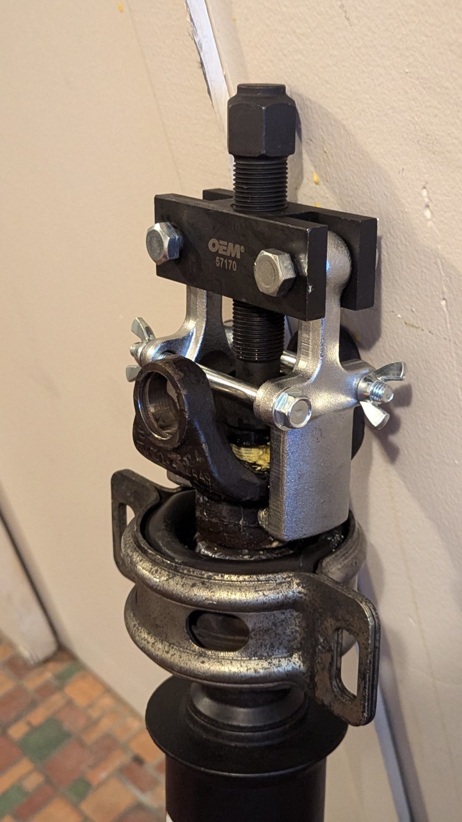

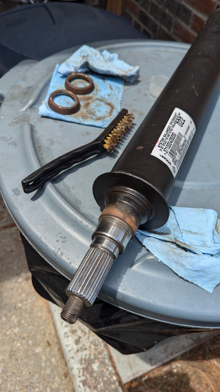

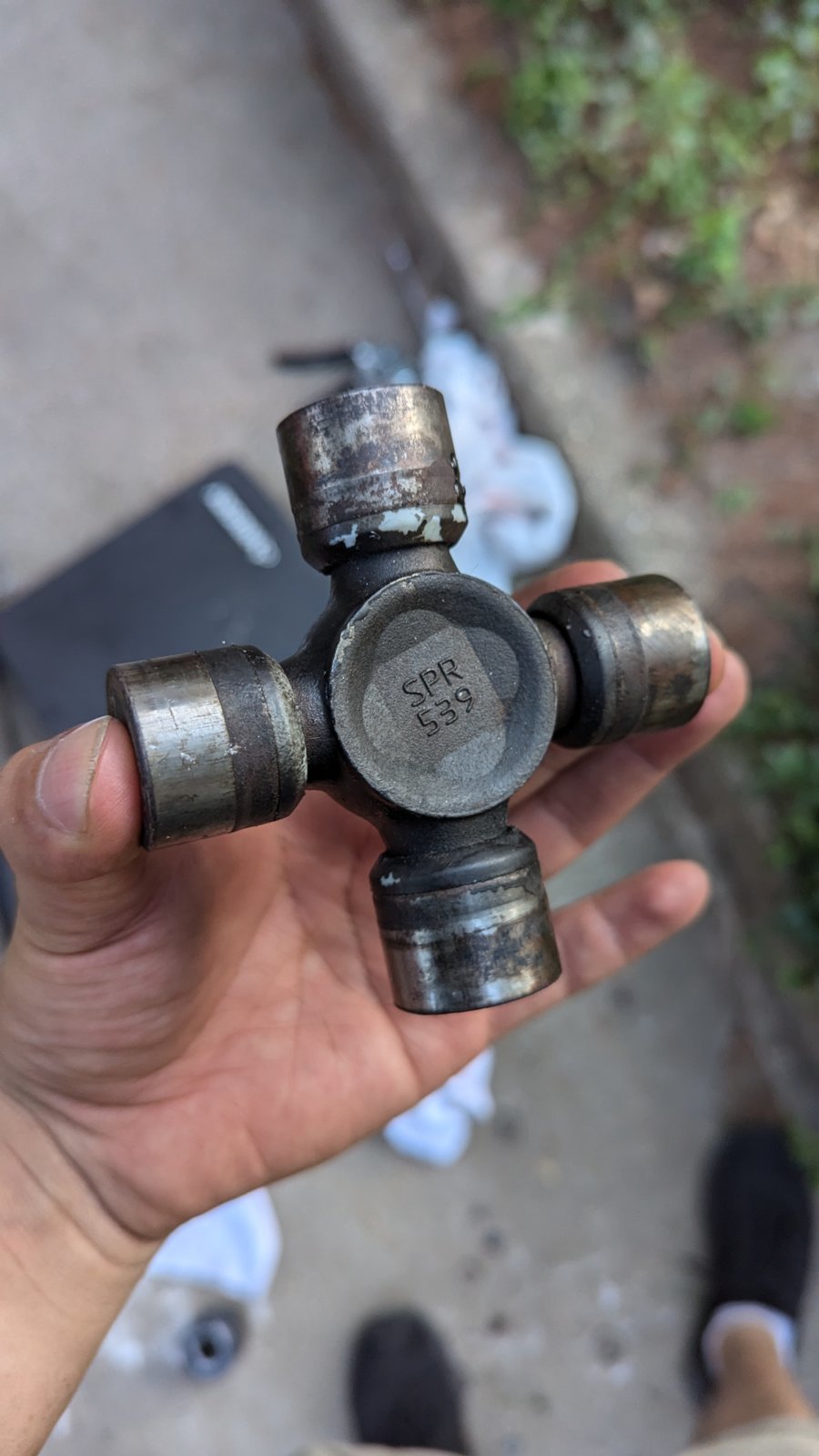

    Hey all, changed all 3 of my U-Joints as well as the Center Support Carrier Bearing! Spicer replacement gear was great! (got greaseable U-joints this time, with zerk fittings).
    All of the Vibrations and Most of the Rumbling went away, especially when accelerating at low speeds / in low gear/
    HOWEVER, there is still some rumbling when breaking at low speeds.... I believe I should service my rear drum brakes next, and front brake rotors as well.

    UPDATE:
    After the summer, the u joints are awesome, less grumbling noises coming from beneath.
    However, in my last diy inspection of the driveshaft, I noticed the center support bearing looked d a bit weird.
    It still drives fine, no noises, no weird things on acceleration either so far.
    I took it to a Driveline Shop in East Williamsburg, Brooklyn (NYC). They specialize in drivelines and driveshafts.
    They came back to me after an inspection and said that the new U-joints I installed were put in too tight, leaving a lot of wiggle room on the ends and causing the end clips to move around when the shaft rotated. As a result, it wore the center carrier bearing excessively - he said I was lucky that there was no more damage beyond that.
    The shop is replacing the 3 u-joints and the carrier bearing for me with sealed (non-grease-able) u-joints and a new carrier bearing, all Spicer. Total came out to over $600 (I'm assuming for labor, OE Spicer parts, diagnostics, and the space my Taco took up in their Shop - in NYC, everything is expensive).
    I'm taking this opportunity to learn from my DIY mistakes, albeit small, it created a much larger issue that luckily I caught in time.
