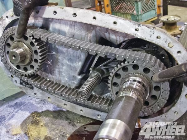

    This is why you should use caution with internet advice and not buy used 4X4's. The trucks owners manual is serious when it says NOT to operate in 4X4 on hard dry surfaces. It would be rare for parts to break just because you drove a short distance on pavement. And driving in a perfectly straight line won't harm anything. Keeping the turns gradual does LESS damage and it takes longer for parts to break. But you ARE over stressing components beyond what they were designed for. And while slow gradual turns do less damage you run the risk of forgetting you're in 4X4 and making a sharp turn off the highway into a business and doing serious, and expensive damage immediately.
    It just ain't that hard to find a dirt or gravel road to do this right. The owners manual "suggests" about 10 miles/month. You don't have to do all 10 miles at once. The local sportsman club and firing range that I belong to has gravel roads. It is about 1/2 mile from pavement to the firing range. I get in about 1 mile in 4X4 every time I go to the range. Some months I may not get into 4X4 at all, but I won't skip 2 months. Some months I may only get in 2-3 miles, other months 200-300 miles. The key is to use it regularly.
    You need to operate in 4X4 to keep things lubricated as well as to keep condensation out of electrical components. Even the owner manual for my winch says most problems are from non-use. Pull the winch cable out once a month and reel it back in under a load. If you don't do so from time to time there is a good chance you're truck won't shift into 4X4 when needed. I've had to pull 2-3 guys out of jams because their 4X4 wouldn't engage due to this.
    Here is WHY you don't do this on hard dry surfaces. And BTW wet rainy roads don't count either. The transfer case uses a chain to transfer the power to the front axle. When you operate in 4X4 on hard dry surfaces you put undue stress on the chain as well as U-Joints. Over time the chain will stretch. Once it gets loose enough it will start slipping on the gears. Most of us have had this happen when riding a bicycle. When that happens you will hear a chattering sound when you press on the gas pedal and the truck stops moving because the chain is slipping.
    It ain't cheap to get fixed. And unlike the guy who I quoted I've actually paid for the repairs due to driving on pavement in 4X4. I don't want to do it again and the solution is pretty simple. It is even spelled out in the owners manual.
    Photo of transfer case internals.
