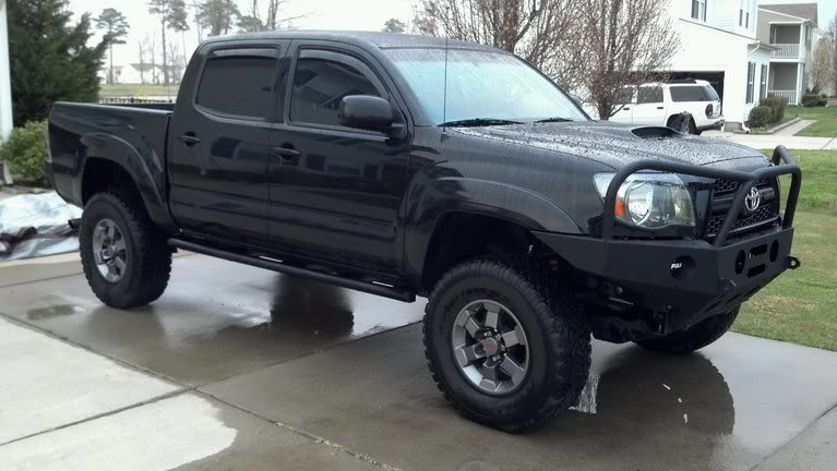

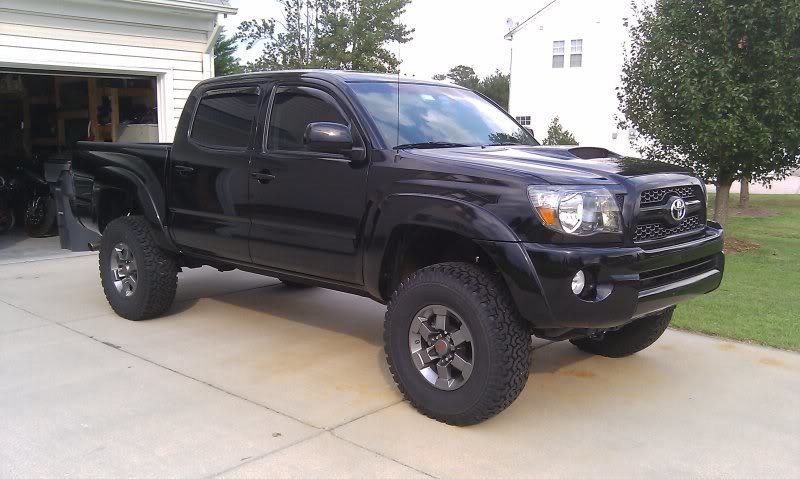

    TRD Super Charger, AFE CAI, URD Cat-back exhaust, URD Short throw Shifter, OME 886 coilovers with Nitrochargers, Dakar Leaves, Desert Products UCA's, FJ TRD Anthracite rims, BFG AT/TKO 285s, Redline Hood struts, Weathertech Ventshades, Weathertech Floormats, Speed Dawg shift knob, Coupe solid shifter, Relentless all around, Eyelids T2, Mr Yo Rearview mirror lift, ejector seats, Rigid D2s front and back, Rigid Light bar in skewp.
    I ran the same set up that you are planning (different UCAs though) for about six months until my Relentless finally got to me. The ride was a little stiffer but not unpleasant in the least. Here is a photo the day after I lifted it:
    Now how it looks after the armor:
    I would just get the 886 now if I were you. Hope this helps.
