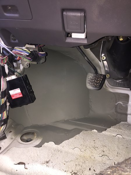

    Firewall Tubbing for 35s - Sealing and Finishing
    This weekend I finished up the sealing and paint on the interior driver side tub. It was kind of a pain in the ass to get to the welds and get them cleaned up, but I think I did a pretty decent job.
    After some grinding and wire wheel work, I hit the sheet metal with an orbital sander and some 150 grit paper. Good enough to get most of the surface rust off and also give the metal a bit of 'tooth' for better adhesion. I then applied Naval Jelly rust remover over the welds and the tub. Clean up involved water, and I was super careful to not go too crazy and potentially trap water in any spaces that would then get covered with seam sealer.
    I hit everything with some air pressure to try to blow out and dry any residual moisture. Then I sprayed and wiped everything with acetone, followed by more air pressure to be certain it was all gone.
    It was at this point that I made a calculated gamble: I sprayed the entire tub area with self-etching primer before I applied the seam sealer. I trust the chemical etch process in the primer to promote good adhesion for both the primer itself and the seam seal.
    Self-etching primer applied after cleaning the entire area.

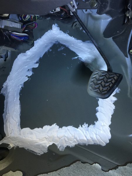

    After three coats, I let the truck sit overnight. Then the next day I started laying down seam seal.
    At first, I went very slow and forced sealer into all of the irregularities along the welds. Then after letting that sit for an hour, I came back and laid down a thicker bead over the welds. Finally, I smeared a bead by hand across the first two and onto the sheet metal to make sure that I had good coverage. It ain't pretty, but it should work.
    Three coats of seam sealer.

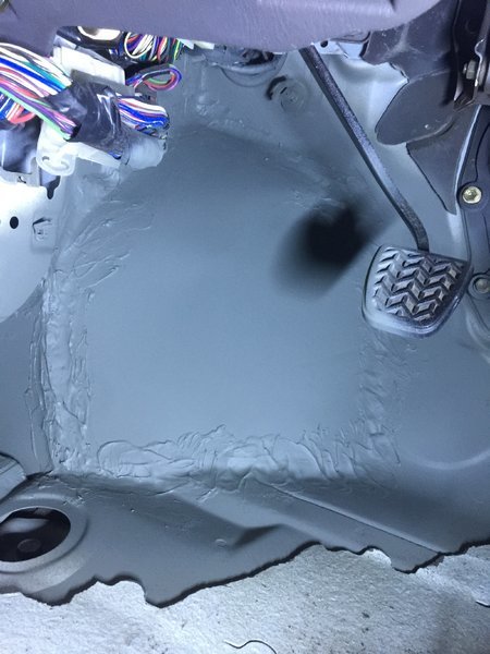

    Finally, after letting the last coat of sealer dry for three hours, I hit the entire area again with primer. I considered spraying white paint, but the factory finish under the sound deadener is gray primer as well. I think I'll roll with that. None of this is visible anyway.
    Moar primer. Three coats and done.
    At this point, I need to secure the wiring harness and 4WD ECU, trim and mount the kick panel, and slap the door trim back on. Then the interior will be done!
