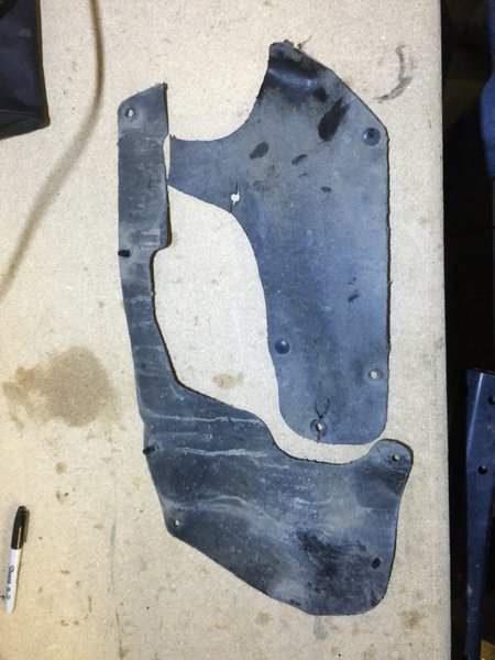

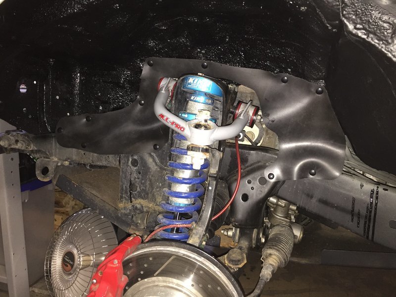

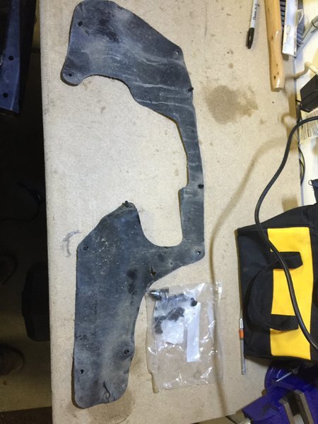

    1. The engine skirts. Despite the truck being in great shape, the stock skirts were falling apart.
    2. The void between the outer fender and the inner fender at the door. Basically, mud, water, mag chloride, whatever has a free shot at the door and hinge.
    3. The same void toward the front. Once the liners were pulled, the elements had free access to the back of the corner light and part of the headlight mount.

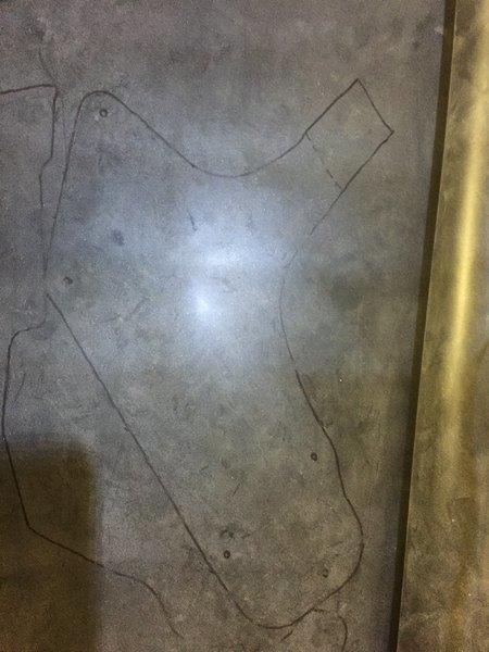

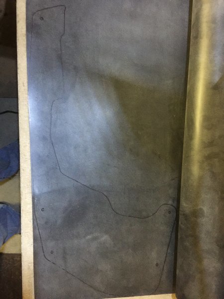

    The goal for today was to replace the engine skirts. Using the old ones as templates, I cut new ones out of some rubber sheet that I bought from McMaster-Carr.
    All in all, they turned out great. I had bitten the bullet and bought new clips to mount everything back up, and that proved to be a good call. The only thing is that I might re-cut these down the road. The factory skirts still have some coverage gaps, but are definitely better than nothing.
    Stock engine skirts. They were in way worse condition than they appear here.
    Stock skirts cut into two pieces to minimize wasted rubber material.
    Cut lines and hole positions for punching. I used a 5/16 punch to make sure that the holes weren't too small.
    New skirts cut and punched.
    Installed!

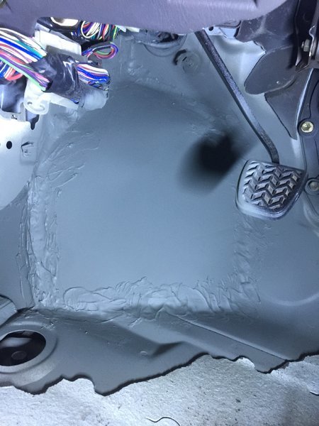

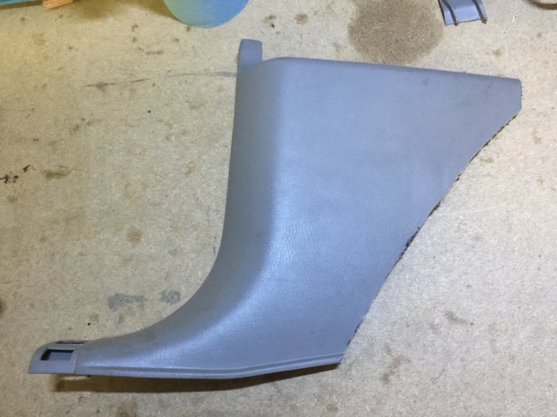

    Firewall Tubbing for 35s - Driver Side Interior Wrap-Up

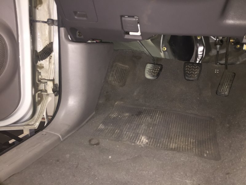

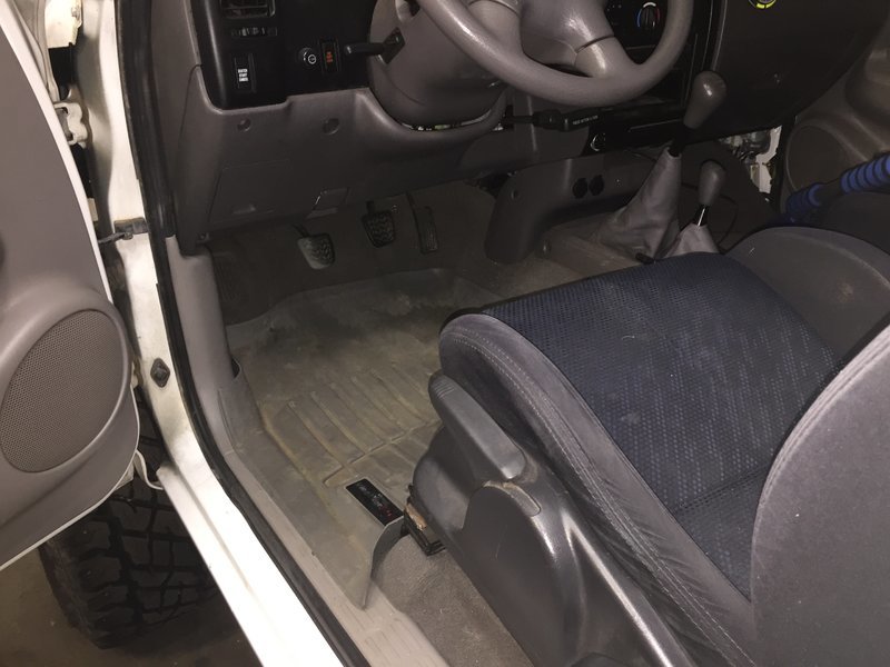

    Well, I made some more incremental progress on the tubbing stuff... I buttoned up the driver side interior for what I hope is the final time. I may come back at some point and touch up a few things, but honestly, it's good enough. Anything more is just indulging my OCD, which isn't always a good thing. Anyway, here's the low down:

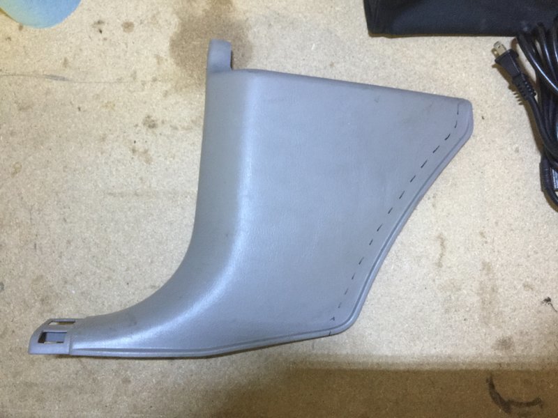

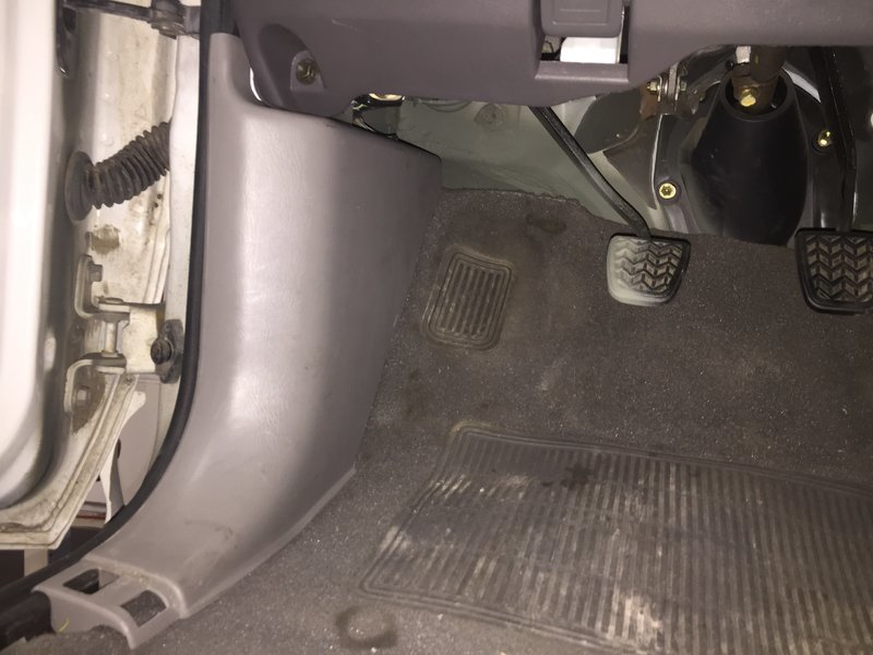

    For starters, I trimmed up the kick panel. I did kind of a hack job with it despite trying to slowly walk into to it. Turns out I really didn't need to cut much up toward the dash, as most of the material that got removed was down near the floor pan. Regardless, it turned out well enough.
    Today's starting point. Interior tub sealed and painted.
    Kick panel, pre-trim.
    Kick panel, post trim. Took too much at the top. Oops.

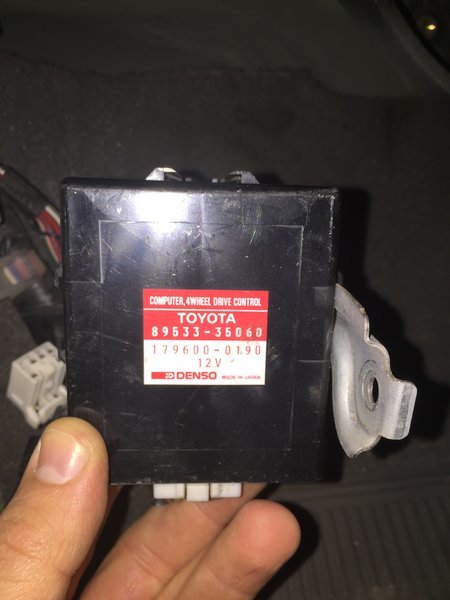

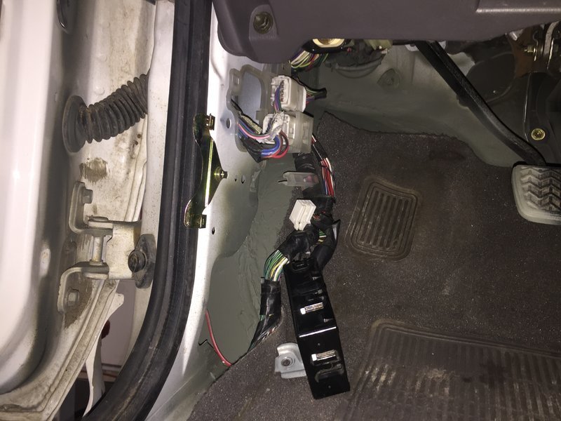

    Messy wiring. The mount for the 4WD ECU was obliterated as part of the tubbing.
    Homeless 4WD ECU.
    Can't see it, but I used two layers of double sided machinist tape to stick it to what's left of the interior body panel. The cable tie is added security. Good enough.
    Not the best fit for keeping the carpet down at the top, but fuck it. It'll work.
    Door trim installed.
    WeatherTech finally back in the cab. Almost looks factory.
    Almost.
    Seat installed for what I hope is the LAST TIME. Fingers crossed.
    It isn't much, but I'm really stoked about this. I can actually sit in the damn thing now and not have to worry about jamming my foot through a gaping hole in the floor!
