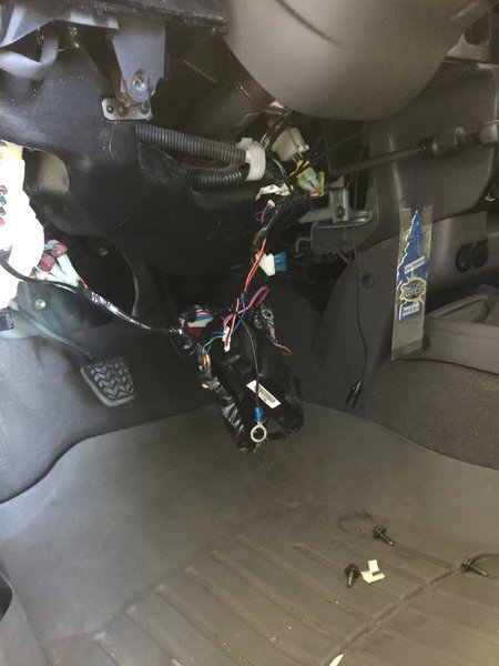

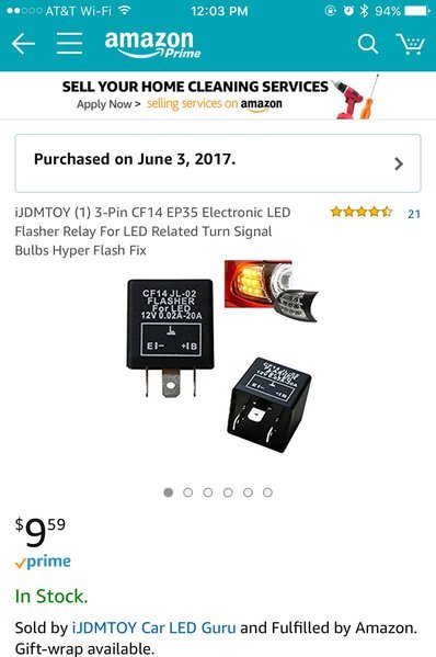

    I've heard a little bit about those. They're supposed to be a better option over uniballs, right? It would be cool to see those in person!
    :rofl:
    I really didn't mind it at all, but I saw that relay for like, 9 bucks, and I threw down on it.

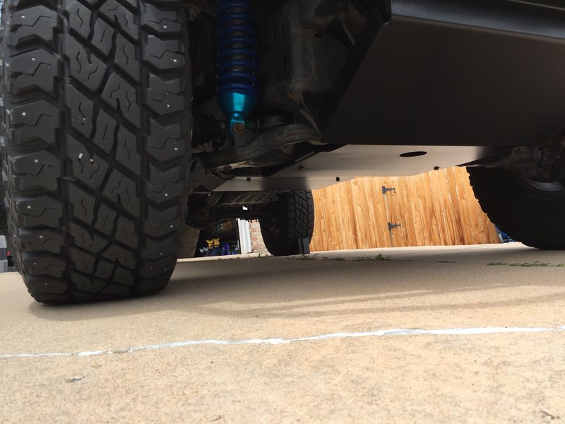

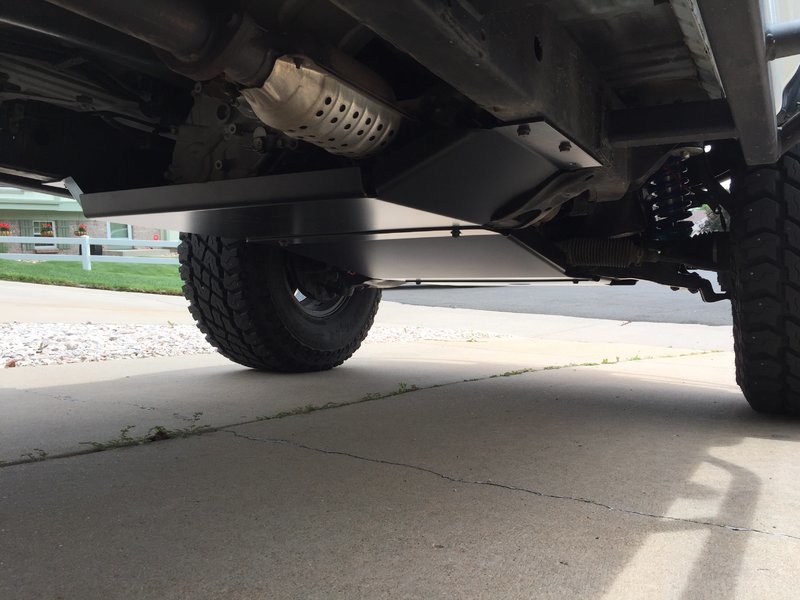

    Skids Achieved!
    Thanks again to @TMFF for cutting and welding the IFS skid extension. Everything lined up perfectly!
    I'm going to use rivet nuts in the front bumper crossmember for the IFS skid mounting bolts. They're being held with stop nuts right now, but it was a bitch to get to those damn things. Rivet nuts will make that a cool breeze.
    At this point, I believe the truck is ready to wheel with some buddies (and their gear). I still need to gather the rest of my recovery stuff and wire up the winch contactor, but that will come soon. The winch itself will sit on the shelf until then.

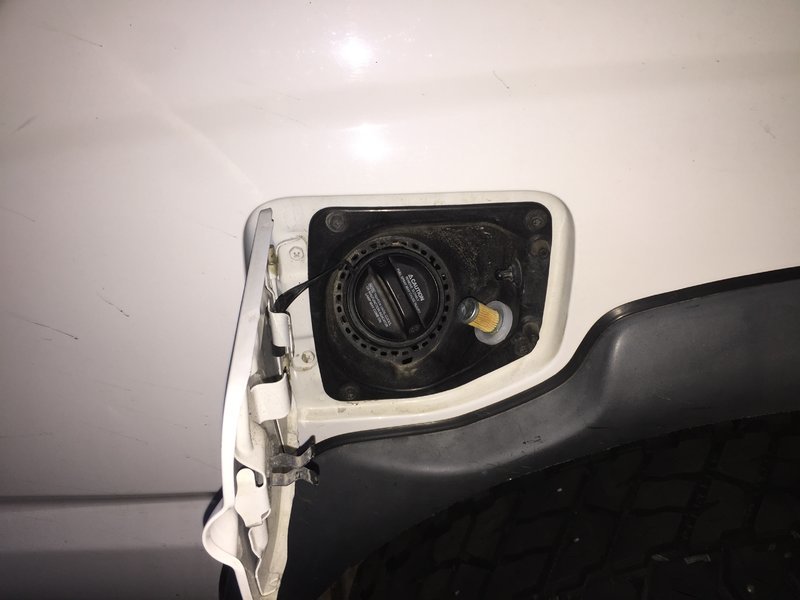

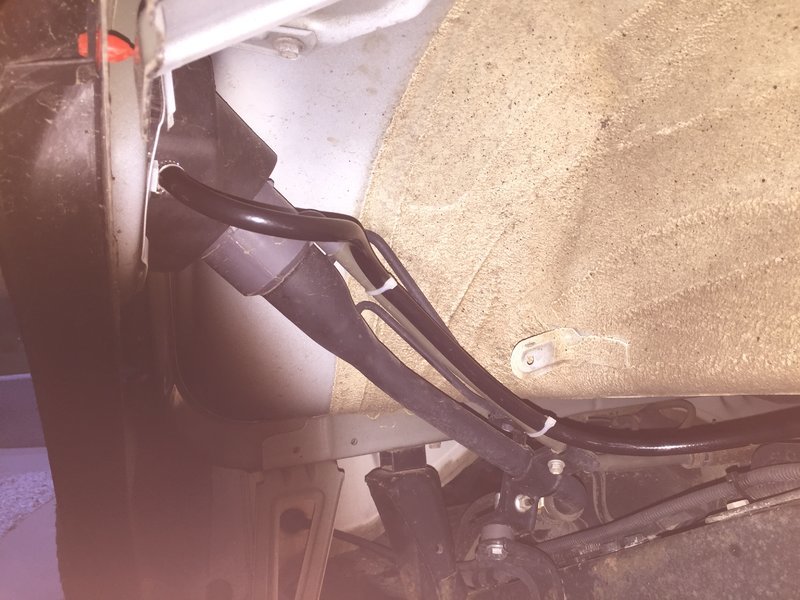

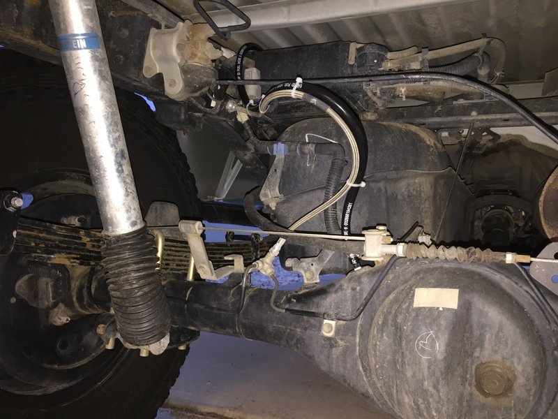

    Rear Diff Breather Mod (finally) Achieved!
    Glad to have this one done. There are quite a few creek crossings on a lot of the trails here in Colorado, and this is cheap and easy piece of mind.
    I relocated to the standard spot in the fuel door compartment, but eventually, I'd like to relocate all of the breathers to a common location on the cowl just under the hood.
    Brace for shitty phone pics...

    Definitely an easy and very money saving mod
