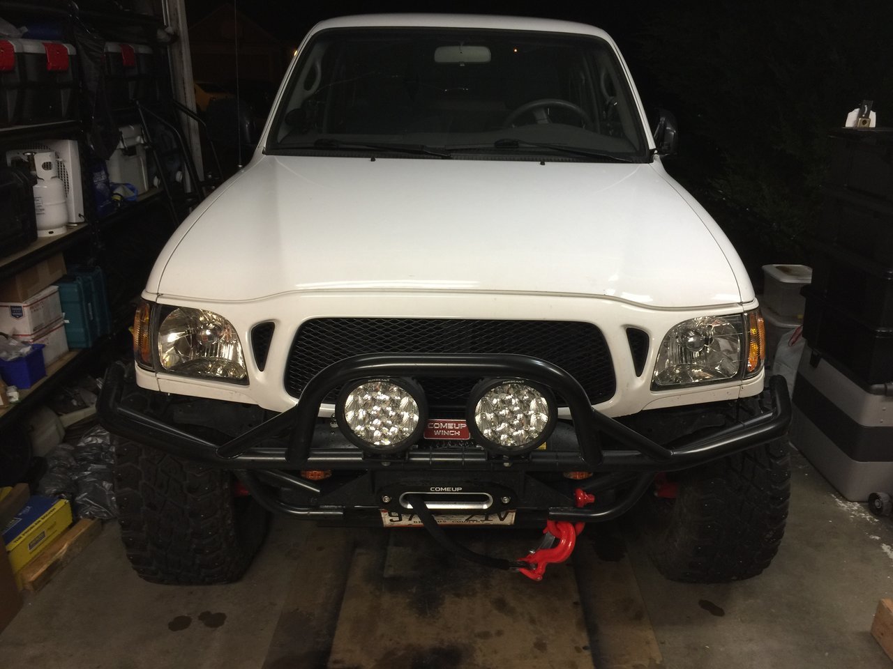

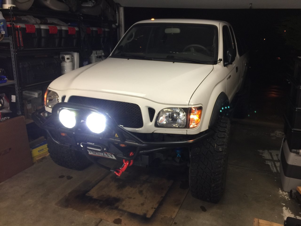

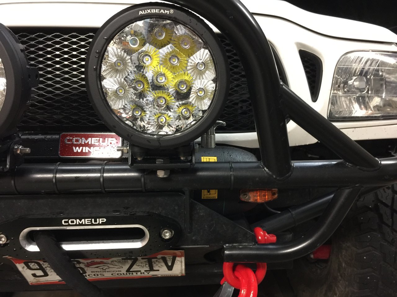

    Well, I didn't get out of work until later this evening, and I had to hit the grocery store, but I still managed to get my driving lights hooked up! I need to fine tune them, but I'm pretty happy with the bang for the buck that I'm getting from them!

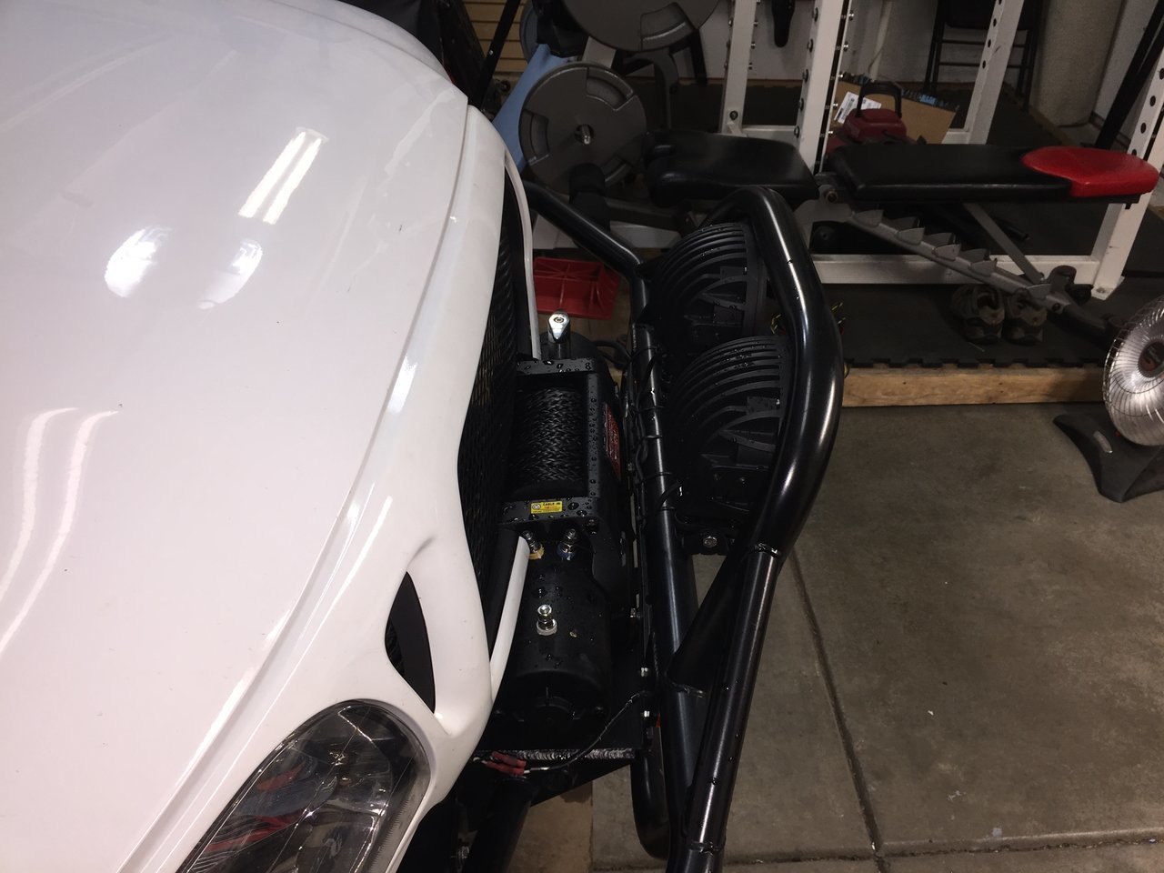

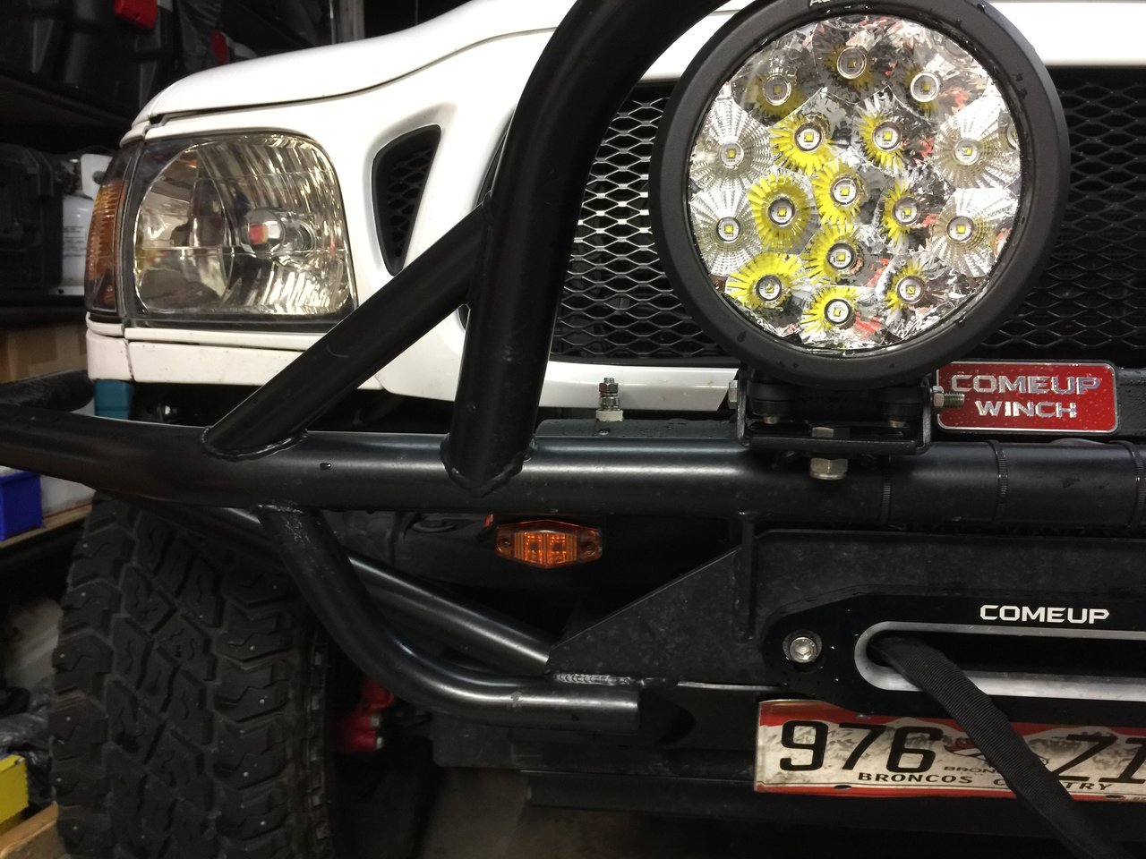

    I also got a chance to take a few pics of the winch and the trimming that was required to get it to clear the grille. I had to completely cut through the bottom lip of the satoshi, but all in all it came out looking pretty good, I think! Hopefully this weekend I can get the winch wired up and do the initial spool on the synthetic line.

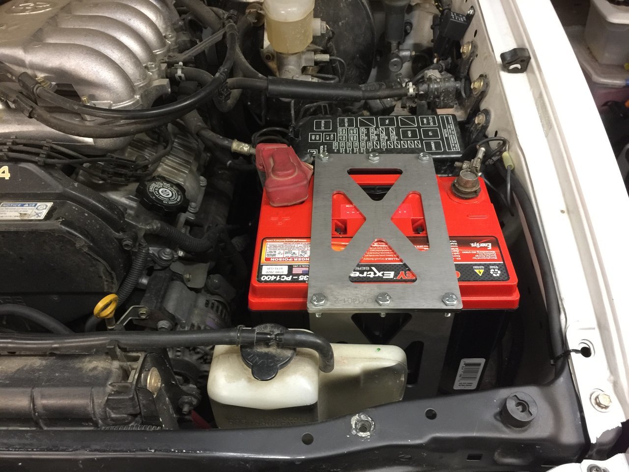

    Got my battery cage mounted that will allow me to mount my winch contactor off to the side. I’d love to get it mounted and wired tonight, but I’ll be working a double shift instead. Not like I needed this evening to keep prepping or anything...
    :mad:

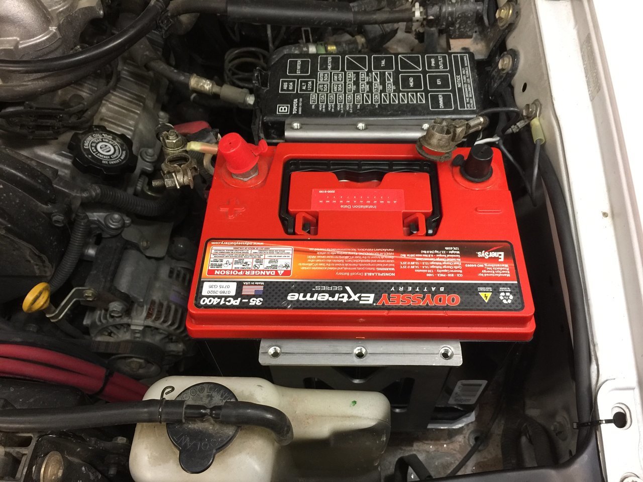

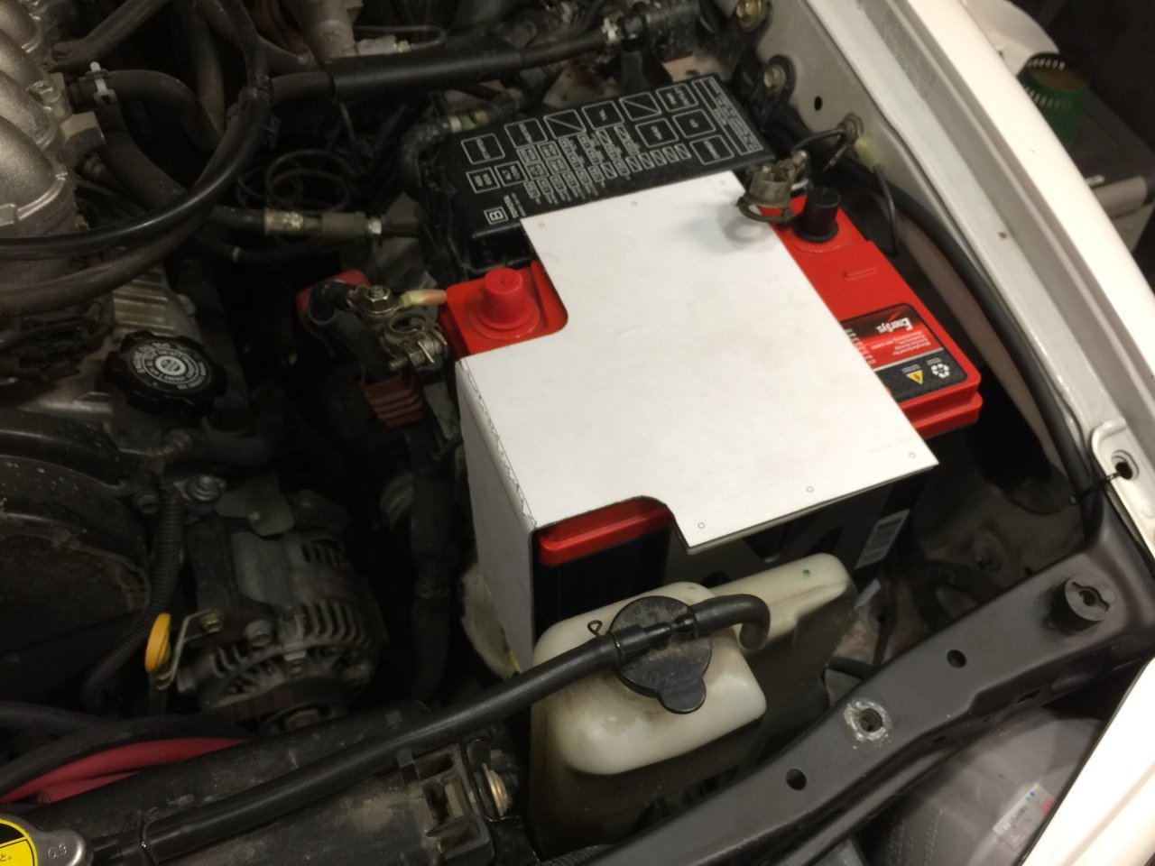

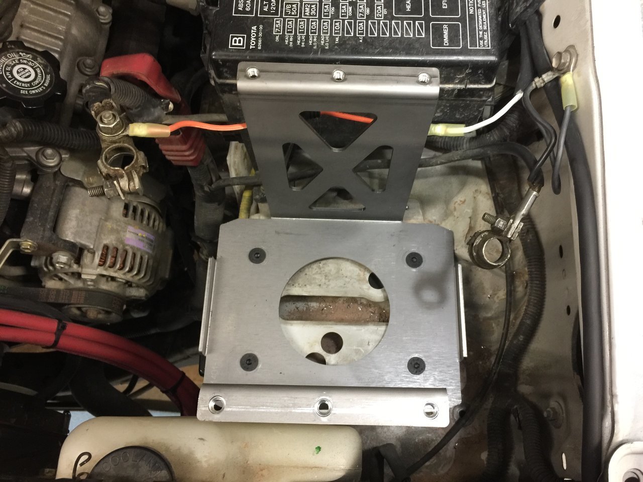

    Battery tray secured. I freakin’ love rivnuts!

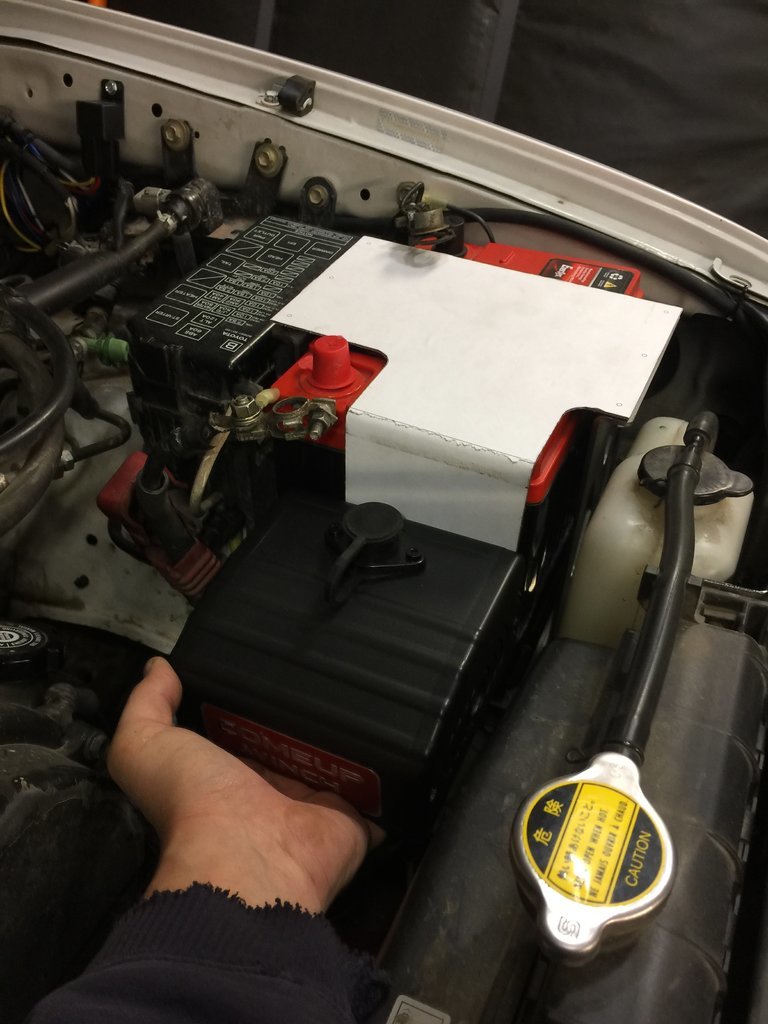

    Odyssey PC1400 G35. One of two, but I didn’t have time before RT to get my dual setup done.
    Bracket for my winch contactor and possibly whatever else I want to mount to it (fuse block, breakers, etc.) The paper is a 1:1 drawing from AutoCAD that I used for a cutting and bending template. I still have holes to drill, which is why it’s still on there.
    Battery tray lid. I like this tray, but there is a bit more slop than I’d like. I have a ton of rubber sheeting that I’ll use to shim things up. My winch contactor bracket will mount between the battery and the tray lid.
    This is where the big ass contactor will live. I have a 1-1/4” electrical nipple that I’ll run thru the core support sheet metal for the 1/0 winch cables to pass through. They’ll come in right underneath the contactor.
