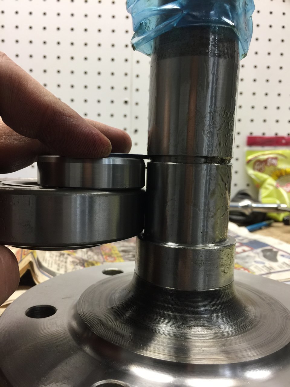

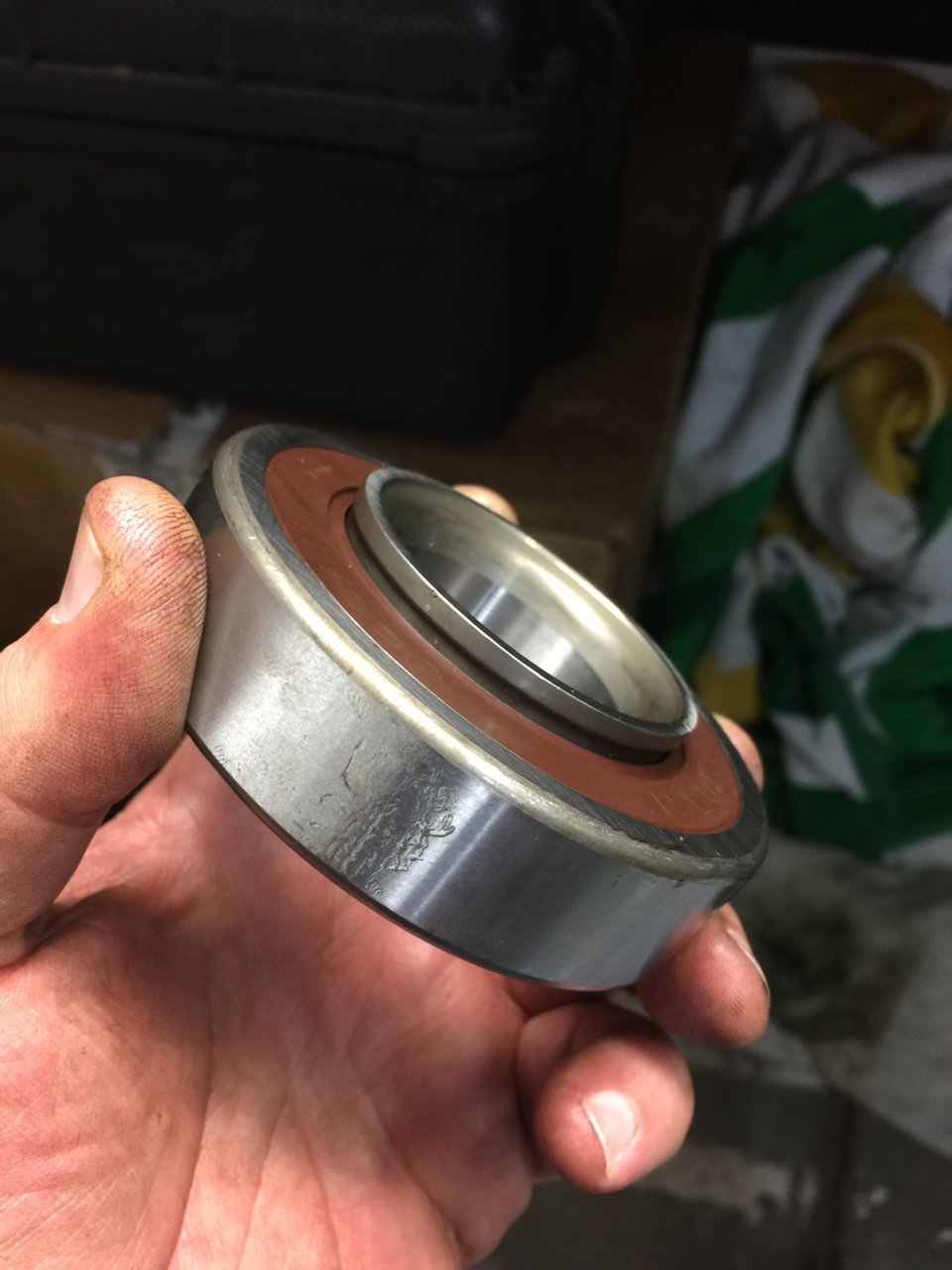

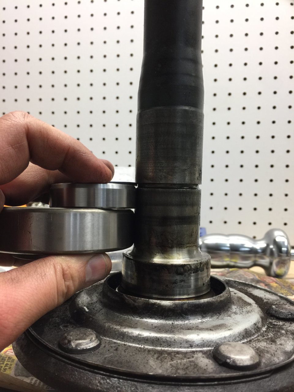

    Turns out the Yukon shafts that we’re advertised to fit 95-04 Tacomas do not work with the stock bearings for my 2002. Where the stock shafts have a radius that matches a radiused lip on the bearing, the Yukons have a hard right angle step. Turns out Brett @Squeaky Penguin ran into the same thing tonight (because I suggested the Yukons to him).
    After some searching and some investigation, it appears that the 95-00 bearings do not have the problematic lip feature present on the inner race like the 01+ bearings do, but are otherwise exactly the same. So off to Amazon I went and found these:
    Genuine Toyota 90363-40020-77 Radial Ball Bearing https://www.amazon.com/dp/B00GKHEV5W/ref=cm_sw_r_cp_api_sGeZAbS4YN7QD
    I’ll have to press off the other bearing and the outer retainer (again), but whatever. I just want this to go together and get the truck back on her feet again.

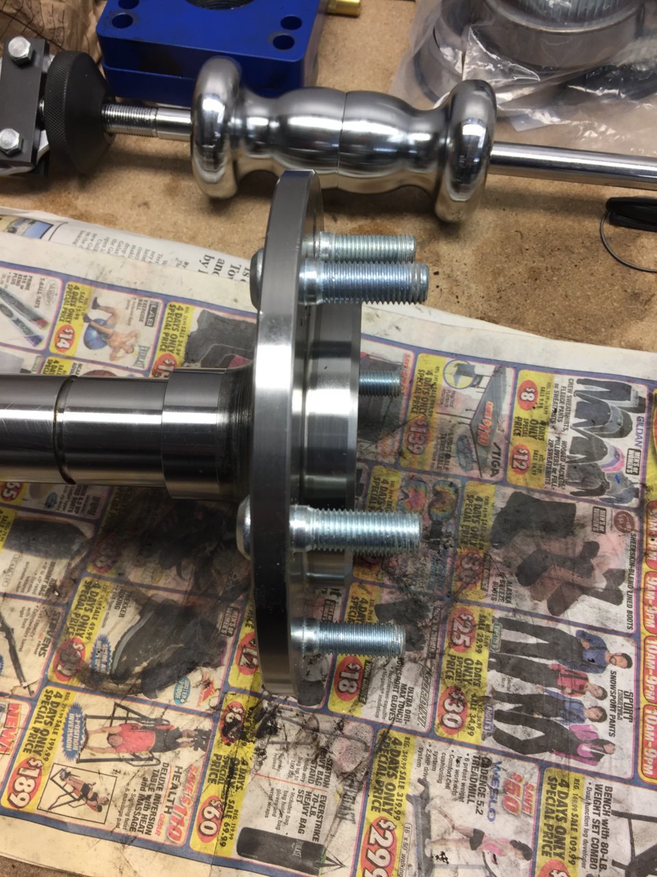

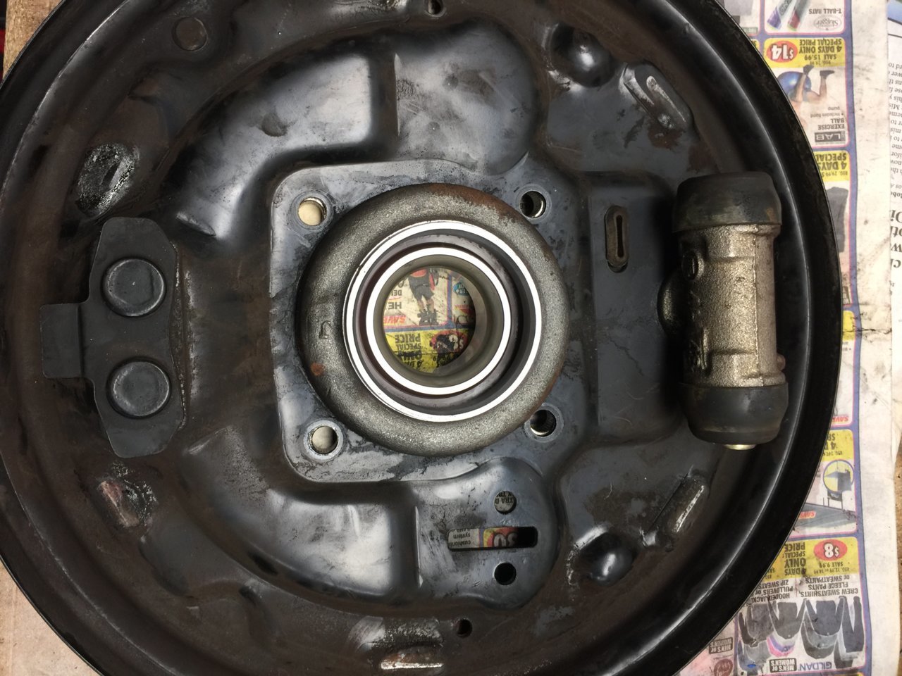

    Hey @Squeaky Penguin and @thefatkid , how big of an issue it it to have whatever the stuff is that is captured between the axle shaft and the lug studs present? I think it’s the drum brake oil shield or some shit?
    I may have gotten ahead of myself and pressed in my studs without all of that...

    Which part are you talking about? Not sure I follow.

    I protects the seal a little, more important though, it is supposed to keep the gear oil off the brake shoes in the event of an axle seal failure.

    See Brian’s response below. It’s the shield that is captured between the 3rd member side of the axle shaft and the lug studs.
    That’s good news. I think I’ll do the same, as I’m now $150ish into new bearings.
    Thanks, Brian. Much appreciated!
    Is it worth pressing off the studs on the new axle, getting the shields off the old one and then pressing it all back on the new shaft?
