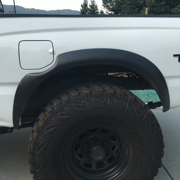

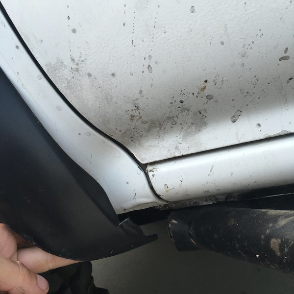

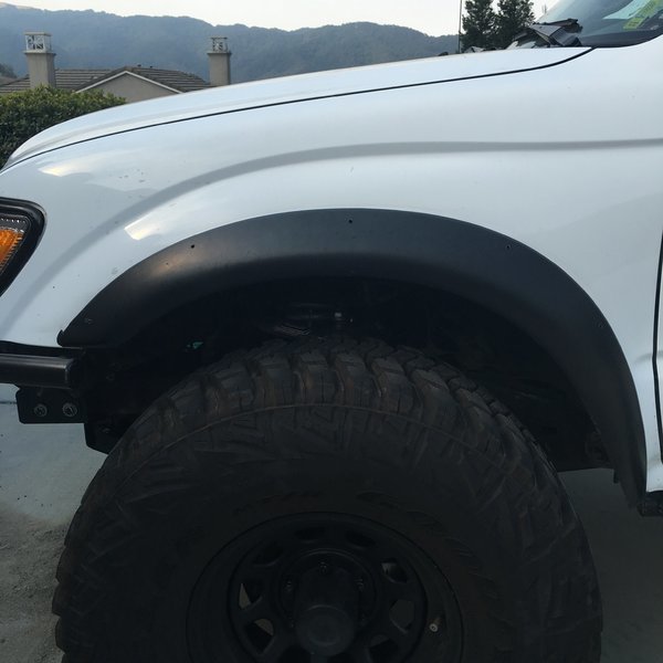

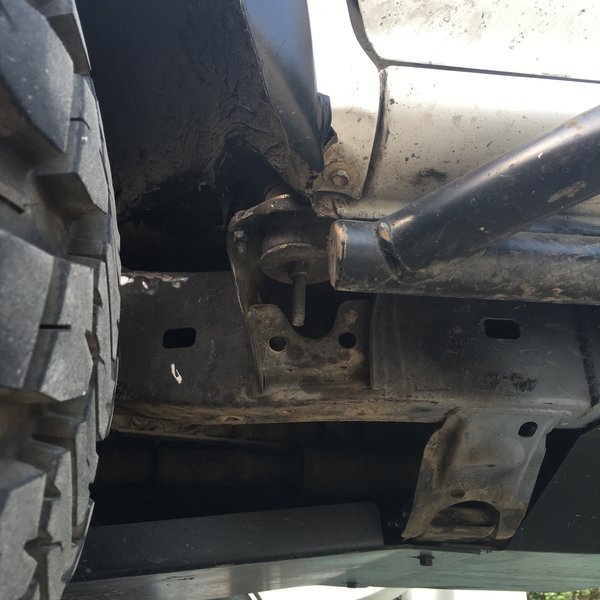

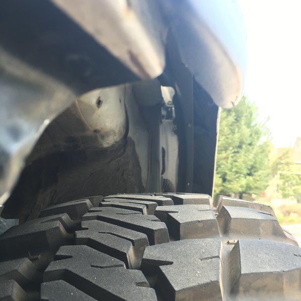

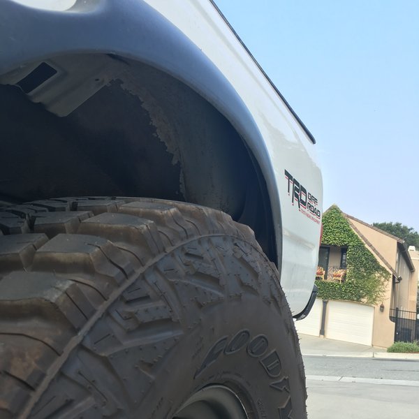

    Alright friend I got those pics for ya.
    Front fenders I started by gutting the under flat part to the edge. I used a cutoff wheel on a dremmel for better prescision.
    After you have the underside how you want it
    I did the mounting hardware and drilled the holes for the allen key. Once all the bolts are in the flare I went ahead and mounted them up. Then it was really an eyeball game. The front flare you can do a wheel turn test to see how much to cut out of the rear of the flare see above pic.
    Also for mounting the lower end of the fender I drilled and tapped a new hole right at the edge of the flare and used the original bolt to mount it. There were little "spacers" under the flare that I reused as well so the fender lip lined up with the rocker panel.
    And the low end of the plastic flare hangs there with everything bolted up.
    Rear fenders are the same deal, gut the underside. Drill holes and secure mounting bolts. Mount them up and with the rears you have to cut your own eyeballed lines from the front and rear. I tried my best to measure and cut equal amounts out of each.
    In the end I did a light sanding on the edges and went over them with a razorblade to clean them up and make the lines look neat.
    Let me know If I left anything out that you need!

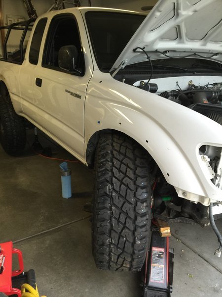

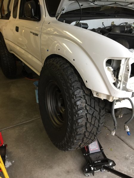

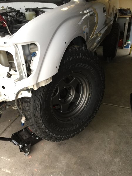

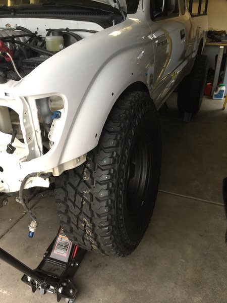

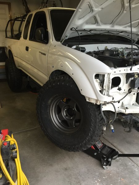

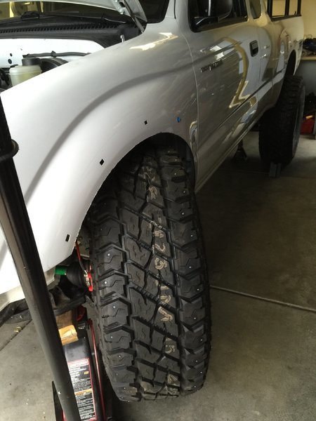

    Firewall Tubbing for 35s
    Well, I made the first real progress on the truck yesterday in at least three weeks. Got the outer front fenders trimmed up, and applied a BFH to the front of the inner fenders under the battery and the air box. I also pulled the washer reservoir knowing that is hit it at full stuff. Time to plagiarize @Robmonster117's reservoir idea!
    Today, I'm gonna replace a body mount bolt that I over torqued, throw the grille and lights on, and take it for a quick drive around the block. If everything looks good, the next stop is my buddy's to finally get the welding done!
    Here are some cool full stuff pics after I cut the front fenders!
    DRIVER SIDE
    PASSENGER SIDE

    Well, it moves under its own power! Took it around the block, and it steers like a champ! Just had to remember to keep my left foot outta the gaping hole in the firewall...
    Gonna put the grille, lights, and bumpers back on and make sure everything still works before I hit the road to weld up the firewall. Might have to hack up the front bumper, but fuck it, it's going away in a few weeks anyway and getting replaced with one of these!
