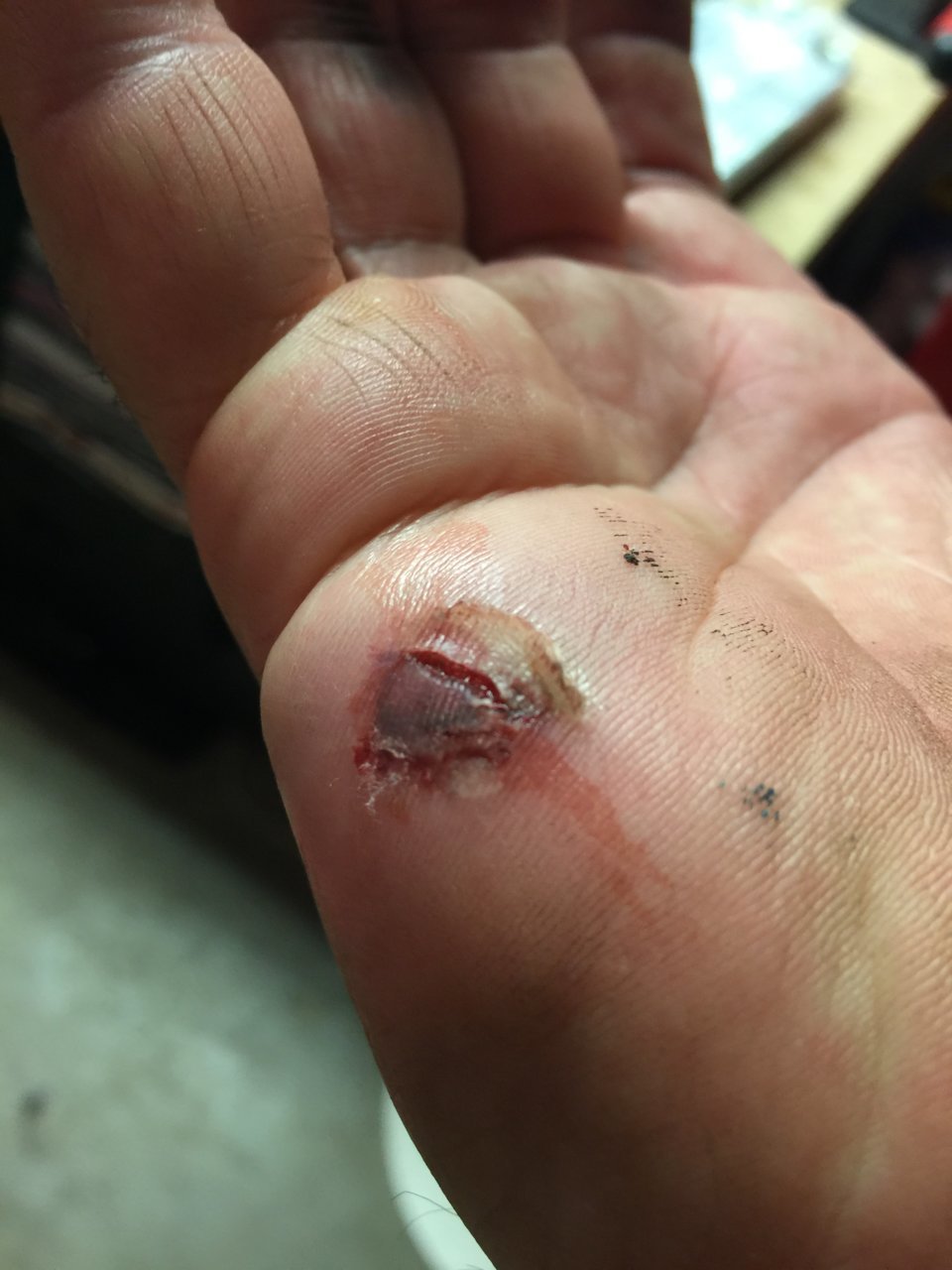

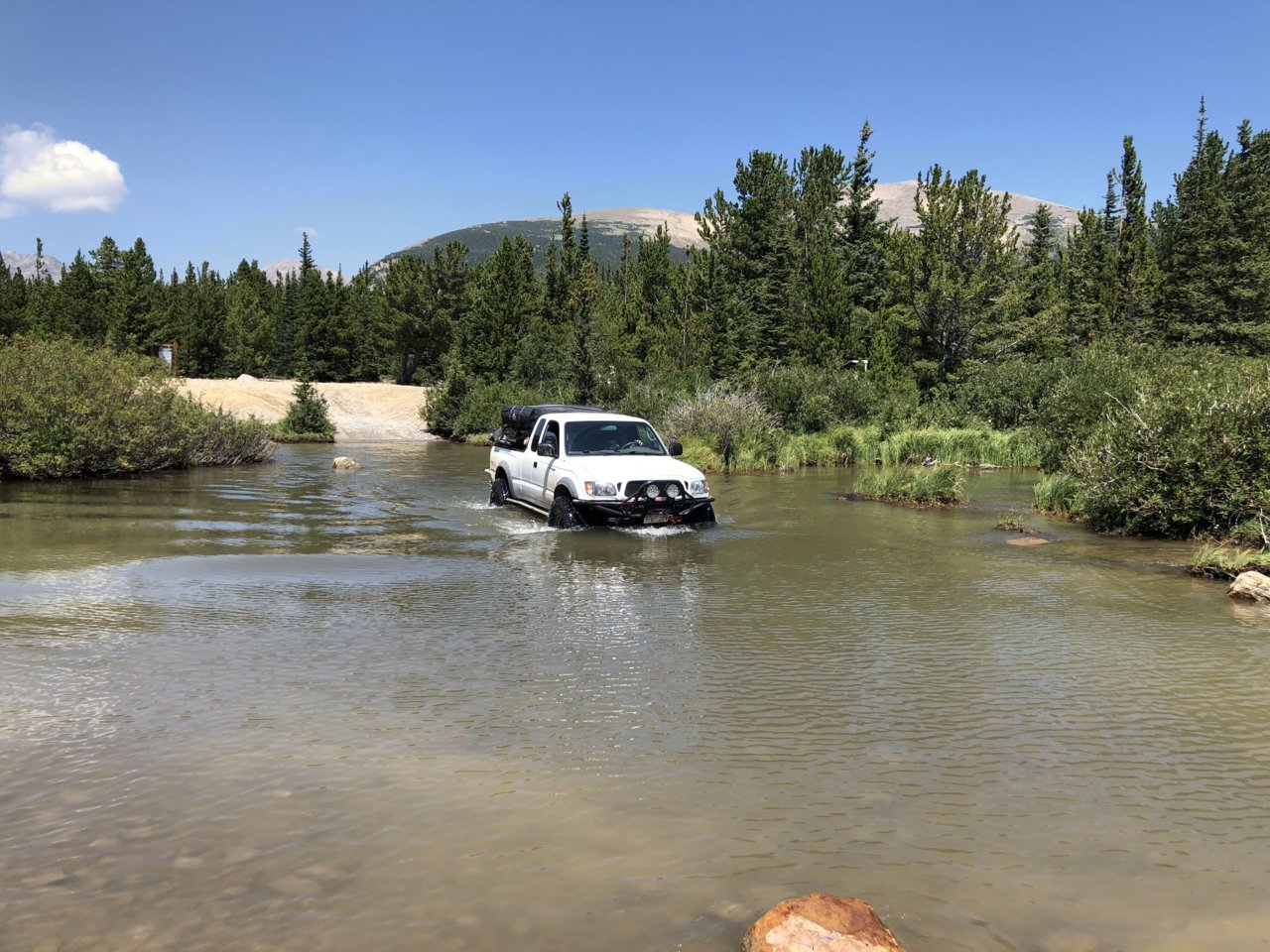

    Last weekend I finally got around to swapping out my leaf spring and shackle bushings for some greasable units. It was pretty straightforward. I didn’t take any pics of the work because I was trying to get done before a wheeling trip with my buddy the next day, but I did take a picture of this... My jack stand bit my hand pretty good, and I got a nice bruise/cut. Good times!
    After the swap, I noticed a huge difference in noise right off the bat, but I’m still getting some squeaking that sounds more like metal on metal. Pretty sure it’s the leaf pack and not the bushings. When I (finally) get around to relocating my shocks, I’ll have to break down the pack anyway. I’ll re-arch the driver side a bit and then clean everything up, hit the spring surfaces with some dry moly lube, then reassemble and repaint the pack. Hopefully that helps.
    The wheeling trip was super fun, and you can see my weak write-up here. The weather was good, the trails were awesome with some challenging spots mixed in here and there, and there was pretty minimal traffic.

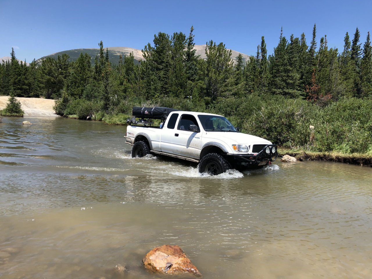

    Wow water level is low.

    Yeah, I’m sure it’s completely different in the spring. Still pretty fun to cross!
