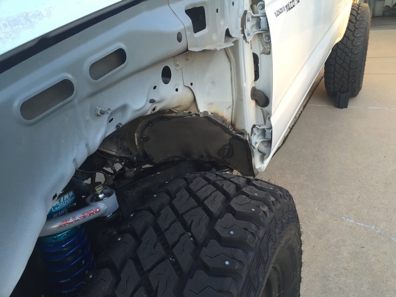

    Firewall Tubbing for 35s
    More progress on the tubbing!
    The welding has been challenging for sure, due to the fact that the stock steel is super thin and not exactly high quality. But my friend is getting shit done, and I'm happy about that.
    Here's the driver side with the bottom section welded in and ground, and the top section tacked and partially welded.

    That's looking super clean dude!

    Thanks, guys! I can't tell you how stoked I am right now. Got a camping trip lined up in a couple weeks, and I WILL have this thing ready to go, with the RTT, for that trip.
    The Kings ride like a dream. The only thing I have an issue with is the spring rate. I have 600s on there now, without a bumper and winch, and I'm pretty much assuming that I'll have to jump to 650 once the bumper arrives. But we'll see, the weight difference may not be all that much.
    You know as well as I do how much of a PITA the whole tubbing thing is, but when you start to see it come together, you just start grinning like an idiot :D
