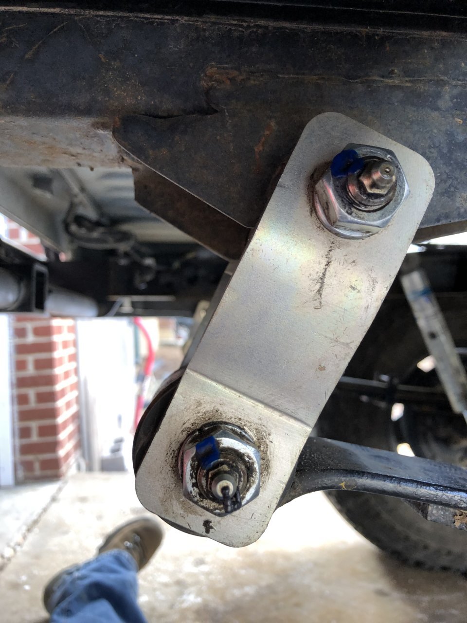

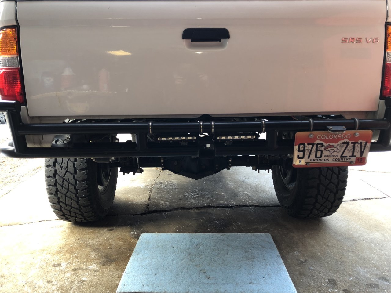

    So I’m fighting some nasty taco lean and it’s pissing me off because I can’t seem to find the cause. Up front on the driver side, I’m running an extra two threads on the Kings and I’m still a half inch low at the frame when I measure at the cab mount. Out back, you can see the sag as well, with the bottom of the bumper showing daylight on the passenger side when you line it up with the axle on the driver side.
    I’ve been thinking that I fucked something up on that side when I bent the driver side axle shaft, and when I look at the shackles from the side, they’re definitely at slightly different angles. Strangely enough, it looks like the passenger side shackle lower bushing is further back than the driver side, which I thought would be just the opposite if I had somehow clapped out the driver leaf pack.
    Long story short, I want to get my alignment done, but it’s gonna fight the tech not being level I would think. I really don’t want to crank up the driver side coilover or drop the passenger side anymore, nor do I want to add a shim under the driver side leaf pack either...
    Everything was dead level when I originally installed the Kings and the Expos, so it’s looking to me like I definitely jacked some shit up. I was way too heavy in Moab when I bent the axle shaft, so that probably contributed.
    Any thoughts, fellas?
    Apologies for the shitty pictures.

    It is not uncommon to have up to a half inch difference in coil position to get level ride height. My 4runner is over 1/4"

    You’re talking a half inch difference of exposed threads above the collar on the coilovers, right?
    ETA “difference”.

    Yep, I'd shoot for just over a quarter and drive it down. Alignment, if far enough off can change ride height.
    Make sure you are rolling it back and forth between checks, straight off the jack stands doesn't work unless you have slide plates

    Are your leaf packs side-specific? Could try swapping them to see how that affects it.
    You’re running 650 lb coils right?

    As far as I know the Expos are NOT side specific, but swapping them did cross my mind. I’d most likely wait until I do my rear shocks because I’ll need to break down the packs anyway and I’d want to inspect them to see if the current driver side has been flattened.
    What I’m having trouble with is the shackle angles. I have no idea how it could be a clapped out driver side pack but yet the shackle on that side is more vertical. But leaf spring geometry still kinda blows my mind, so there is that.

    Hmm I thought all pro leafs were side specific

    Shit, maybe they are... I know the Dakars are, but I swear I never found any markings or anything denoting that. Regardless, if they’re different, it’ll be obvious after pulling and comparing both packs and I’ll probably just swap them like Dan said and go from there.
    I don’t know what else could be going on.

    Bent the rear frame haha
