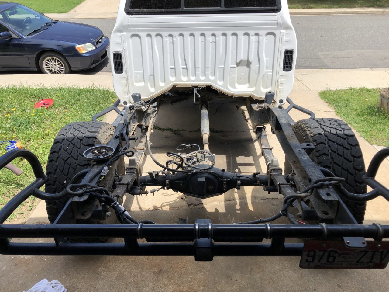

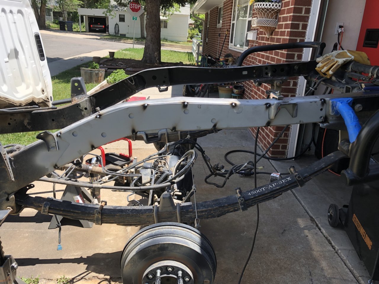

    Almost time to start cutting stuff off the frame...
    I have tons of progress pics that I’ll do a write up with later, but here we are after a good morning wrenching.

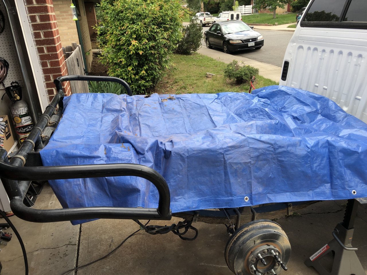

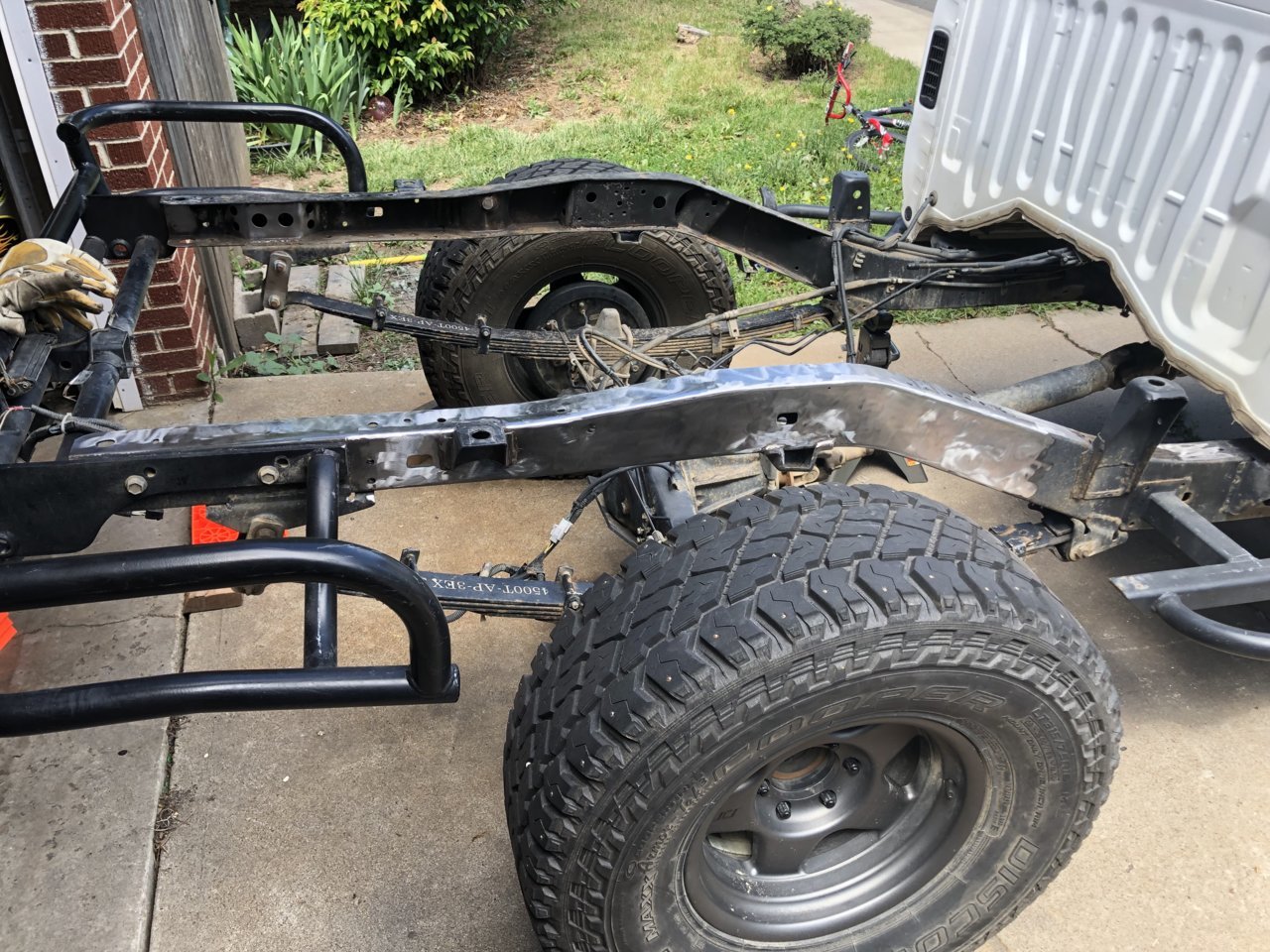

    I’m trying hard not to get really irritated with the weather and more specifically the fact that I have to work outside.
    I’m halfway through welding the outside frame plates on and the wind kicked up and now it’s raining.
    Current status :mad::
    I’m getting a 10lb roll of 0.03” FCAW wire and as long as it’s not pouring rain, this motherfucking welding is gonna get done.

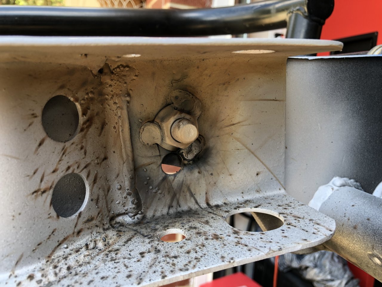

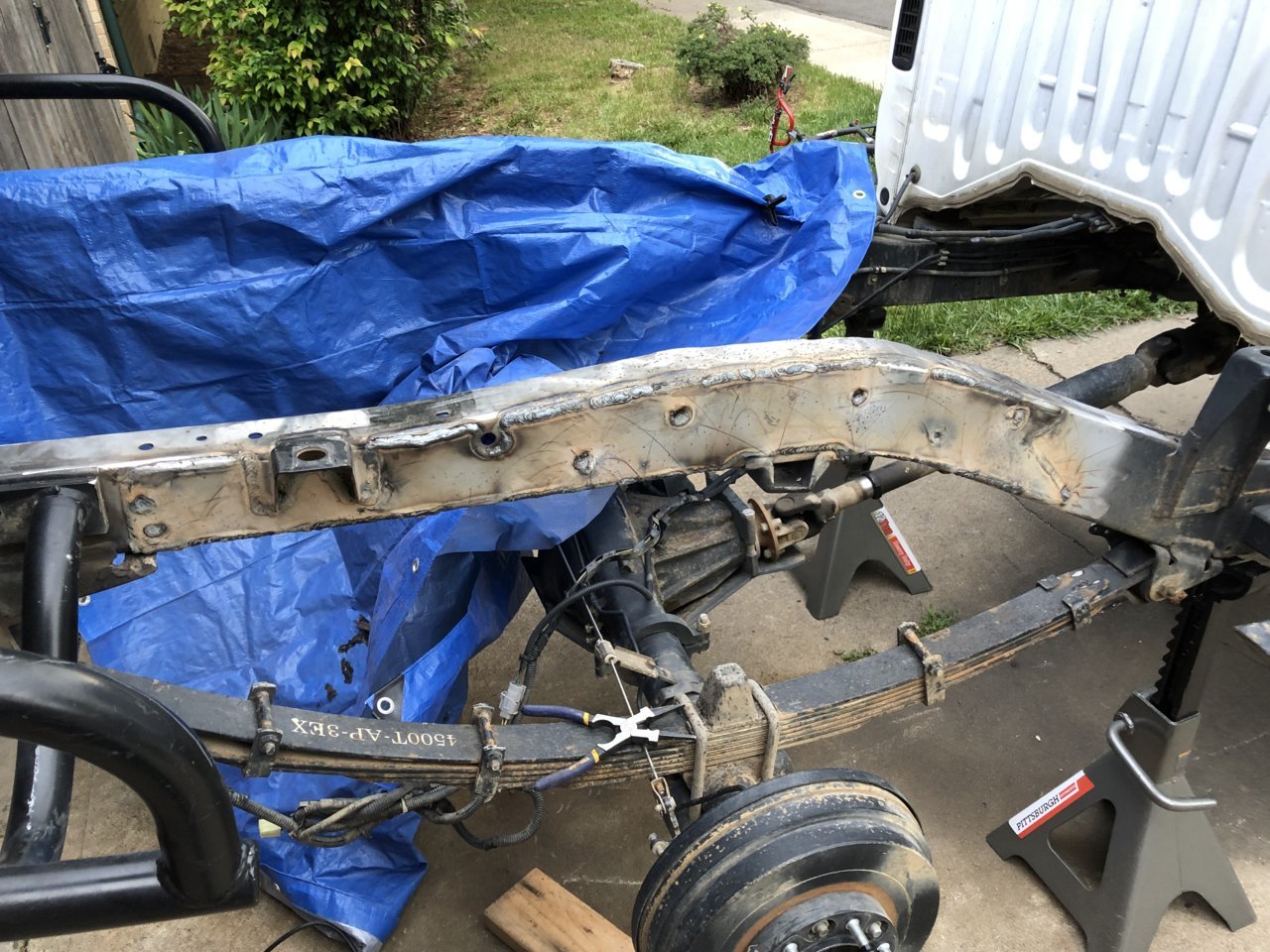

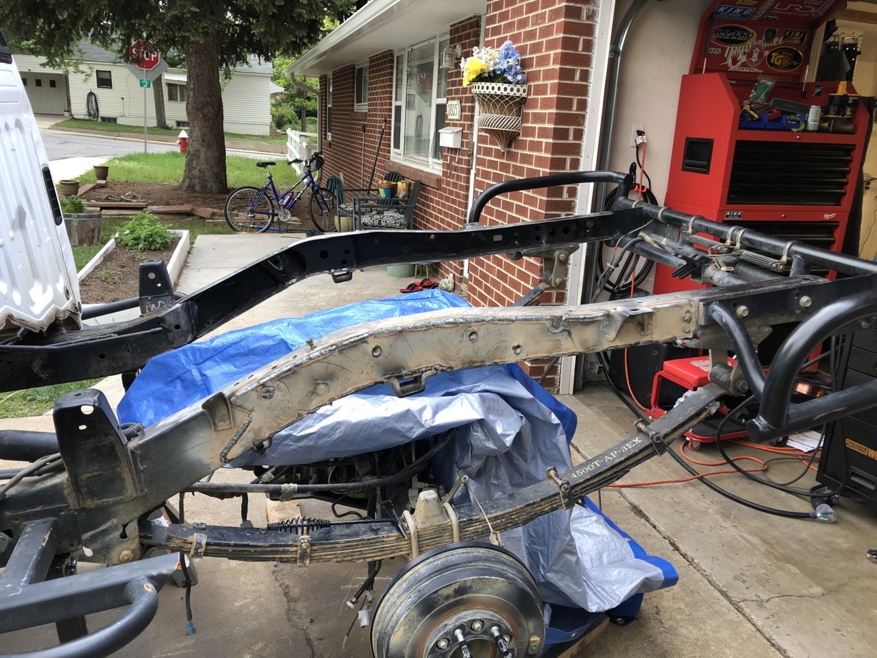

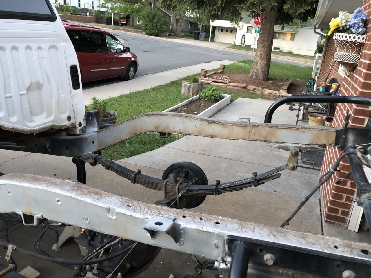

    Got the outside frame plates welded on today despite the weather. It took a while to get the frame prepped, but the welding itself took me the longest. I tried to only do 3-4” stitches and switch between sides to keep the frame from heating up too much. Before the wind kicked up I was getting pretty good results, but as soon I lost the shield gas, things weren’t so good.
    After switching to flux core and getting over the dull looking welds, I was able to plow through the rest of the welding and get these done, which was nice. I did find out that I suck ass at plug welds, but it’s nothing a grinder won’t fix :D
    Since it started to rain again and I had to tarp the truck (again), I decided to go ahead and pull the brake lines off the axle to get ready for shocks.
    The plan for tomorrow is to clean up the inside of the c-channel, hit it with weldable primer and then get the box plates tacked and welded. Then I just need to hit all the welds with a wire wheel and grinder as required. Gonna take a while, but I’ll be able to start the shock relocation on Monday, hopefully. I also got the last of the shock mount stuff from Ruff Stuff, so that’s all good to go.

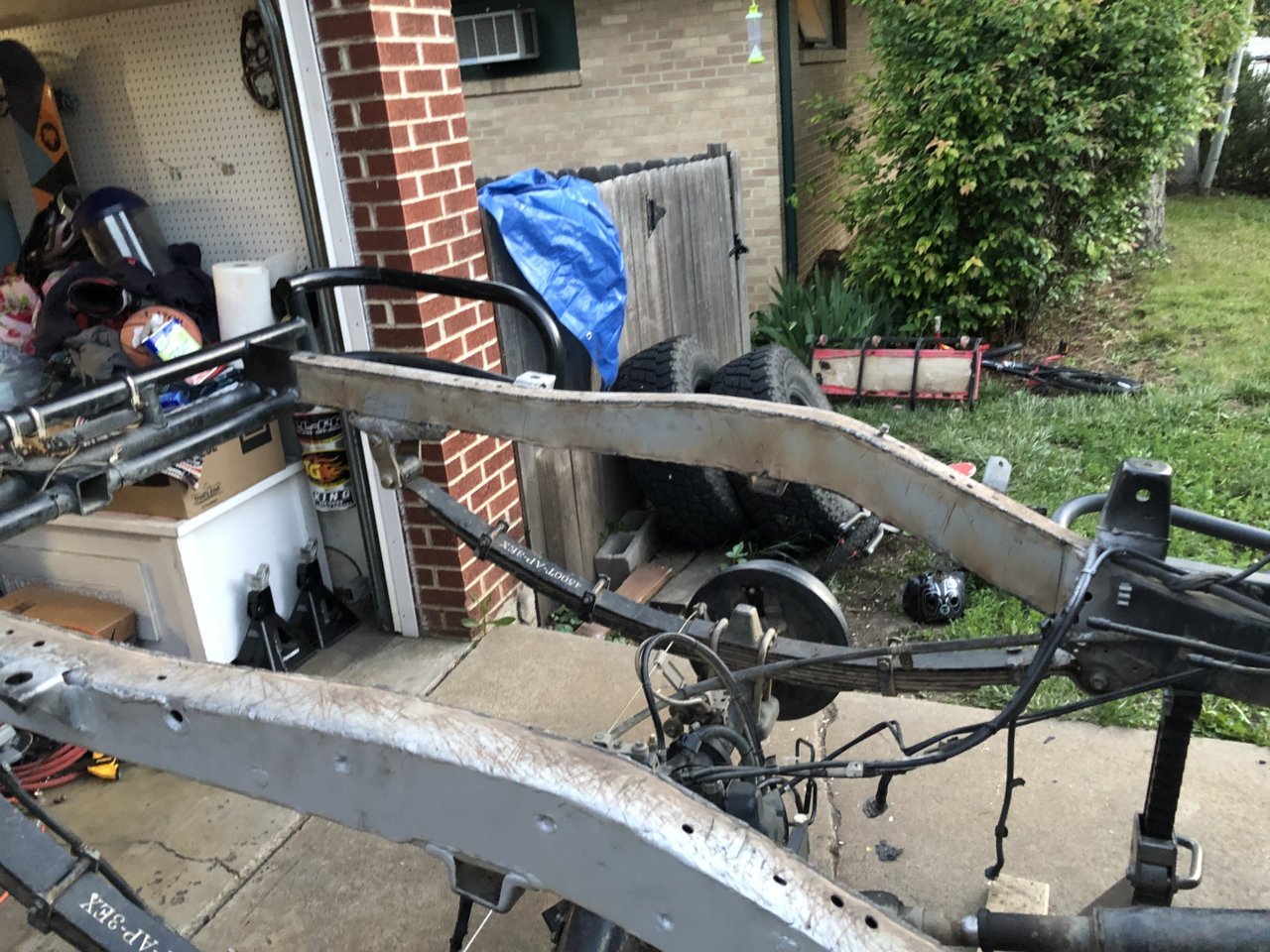

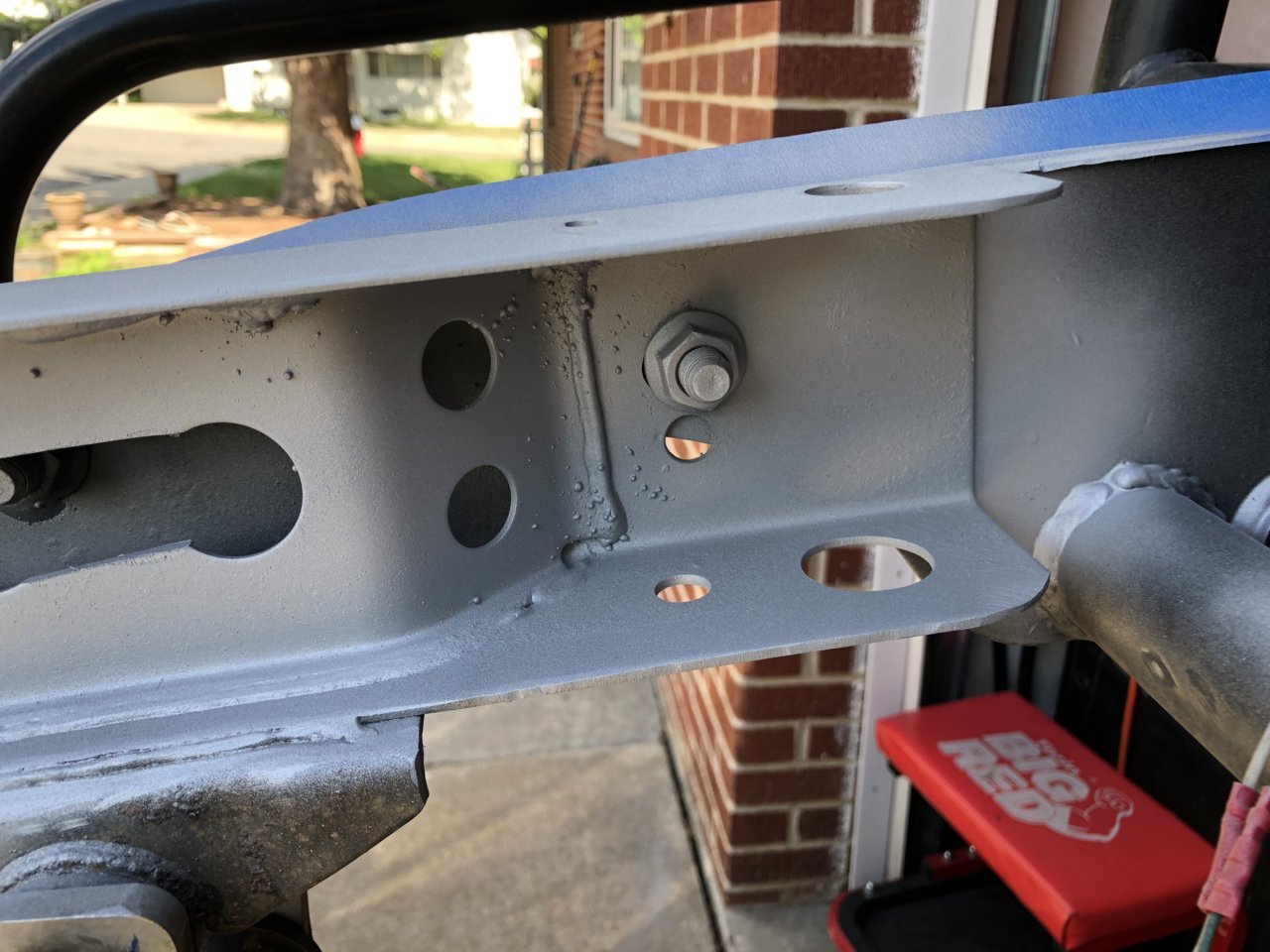

    Frame is 98% boxed.
    I need to weld in a little patch plate to overlap the new plate onto the frame, and then I’m ready to move on to shocks.
