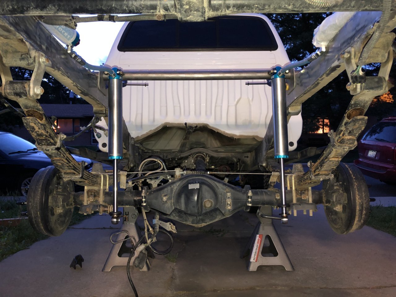

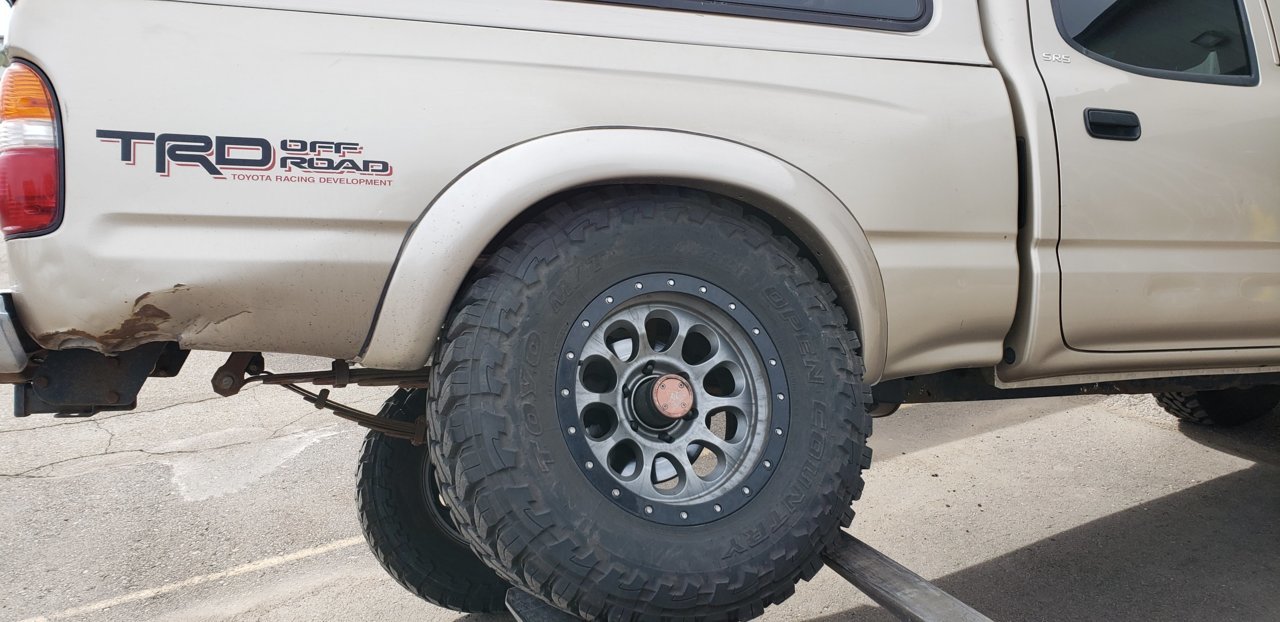

    About 30.5" center to center.
    It's not a super critical measurement though. Just make sure the shock bodies don't hit the ubolt plates or anything when you flex it.

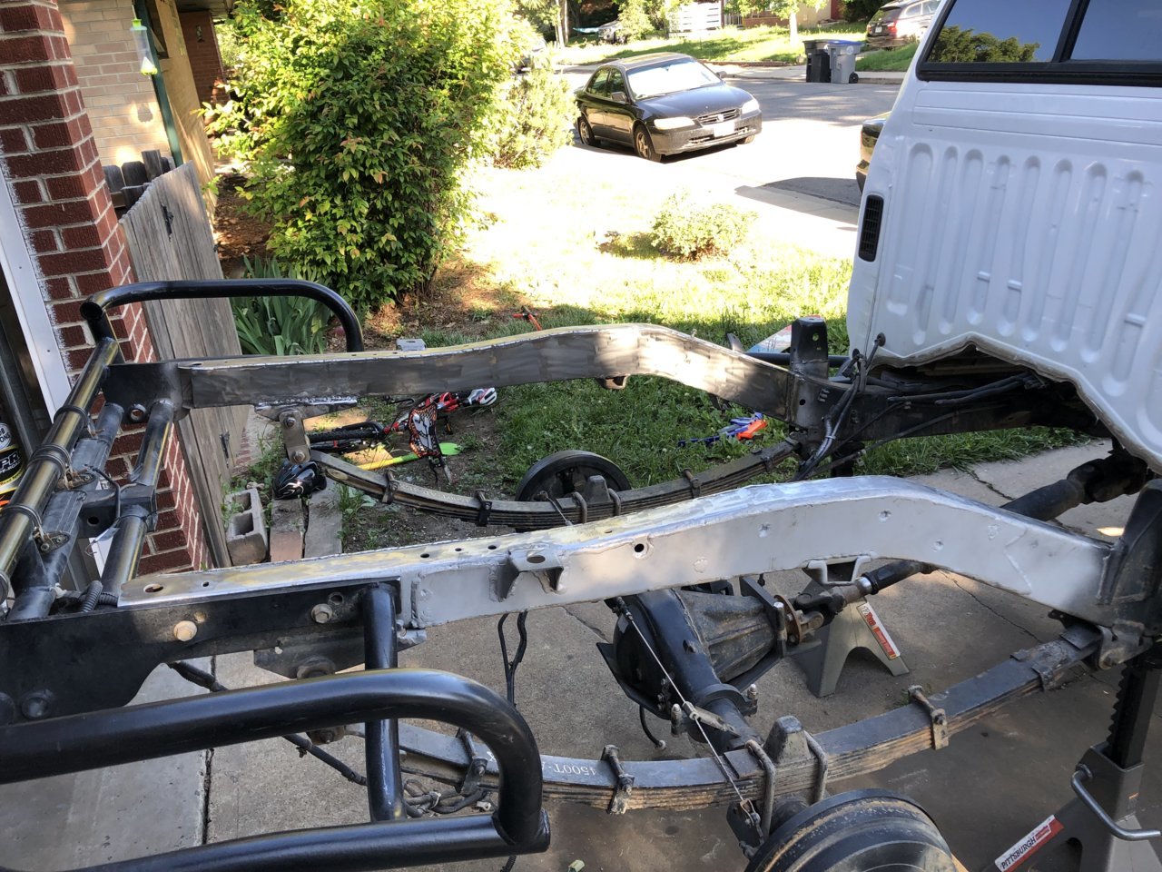

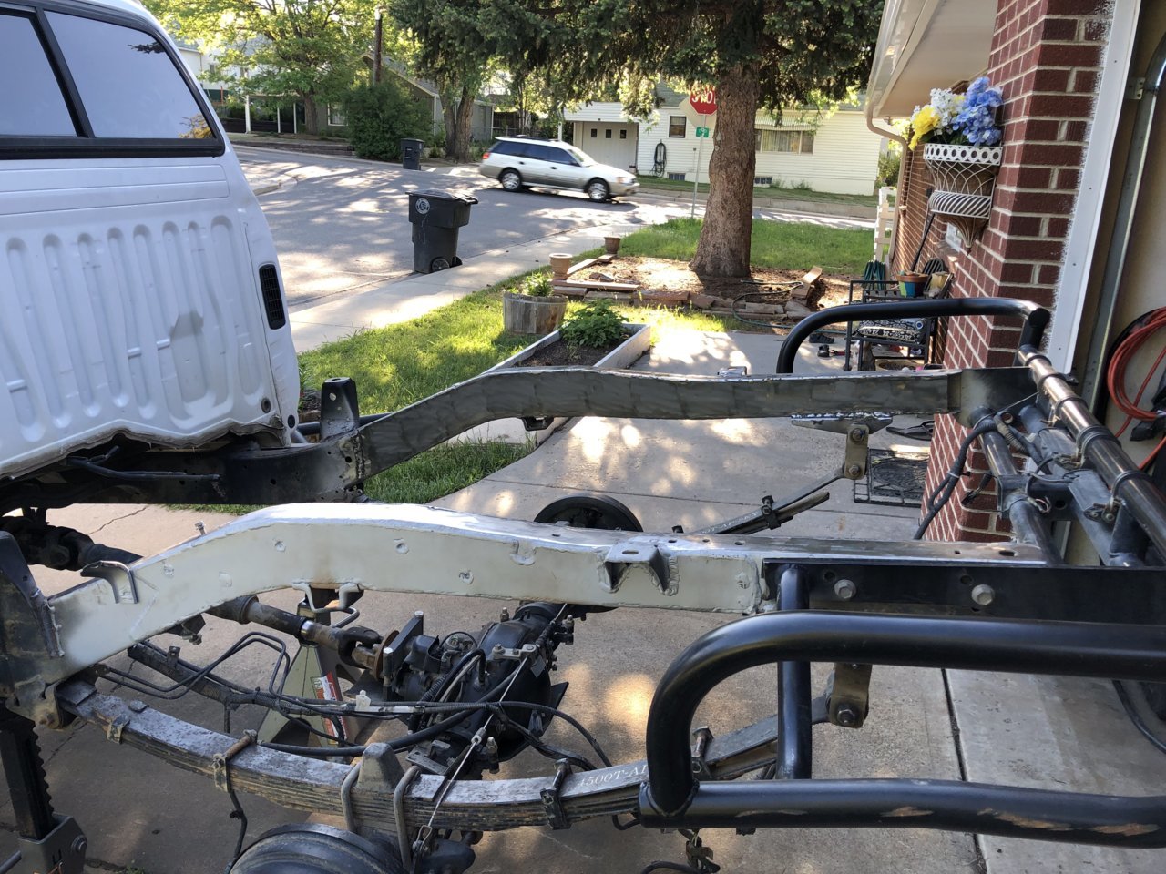

    Not much changed since yesterday, but I got the last couple areas welded up on the frame box plates and got everything cleaned up.
    For now, I’m leaving the ends of the frame open. Once I have the upper shock mount crossmember welded in, along with the other two crossmembers, I’ll pull the bumper and weld in some plates to close it out. Right now the bumper is in the way, and since it’s the only thing locating the two frame rails, it has to stay put.
    Anyway, the plan is to start the shock relocation tonight!
    :headbang:
    ETA: I wish I would have taken a picture of the pile of grinder dust that I swept up. It was pretty damn impressive!

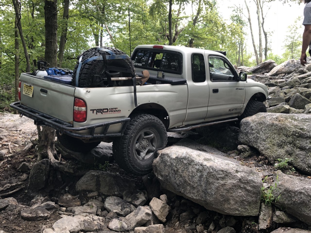

    FWIW You have seen the shit I hit in the off-road parks, and I’ve made it this long with a stick skid, even if it did dent up. And like I’ve always said, the skid/gas tank protects your drive shaft a lot. Considering it’s the thing that gets you home, it’s a nice thing to have protected.
    Unless you are in this shit more often than not I’d consider it, but otherwise it’s not worth it :notsure:
    Another good thing to look at is how many scratches does your current skid have? If not many, I’d say don’t worry too much.

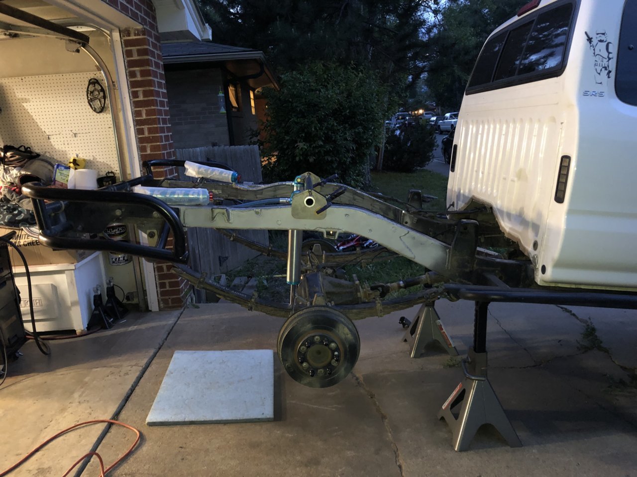

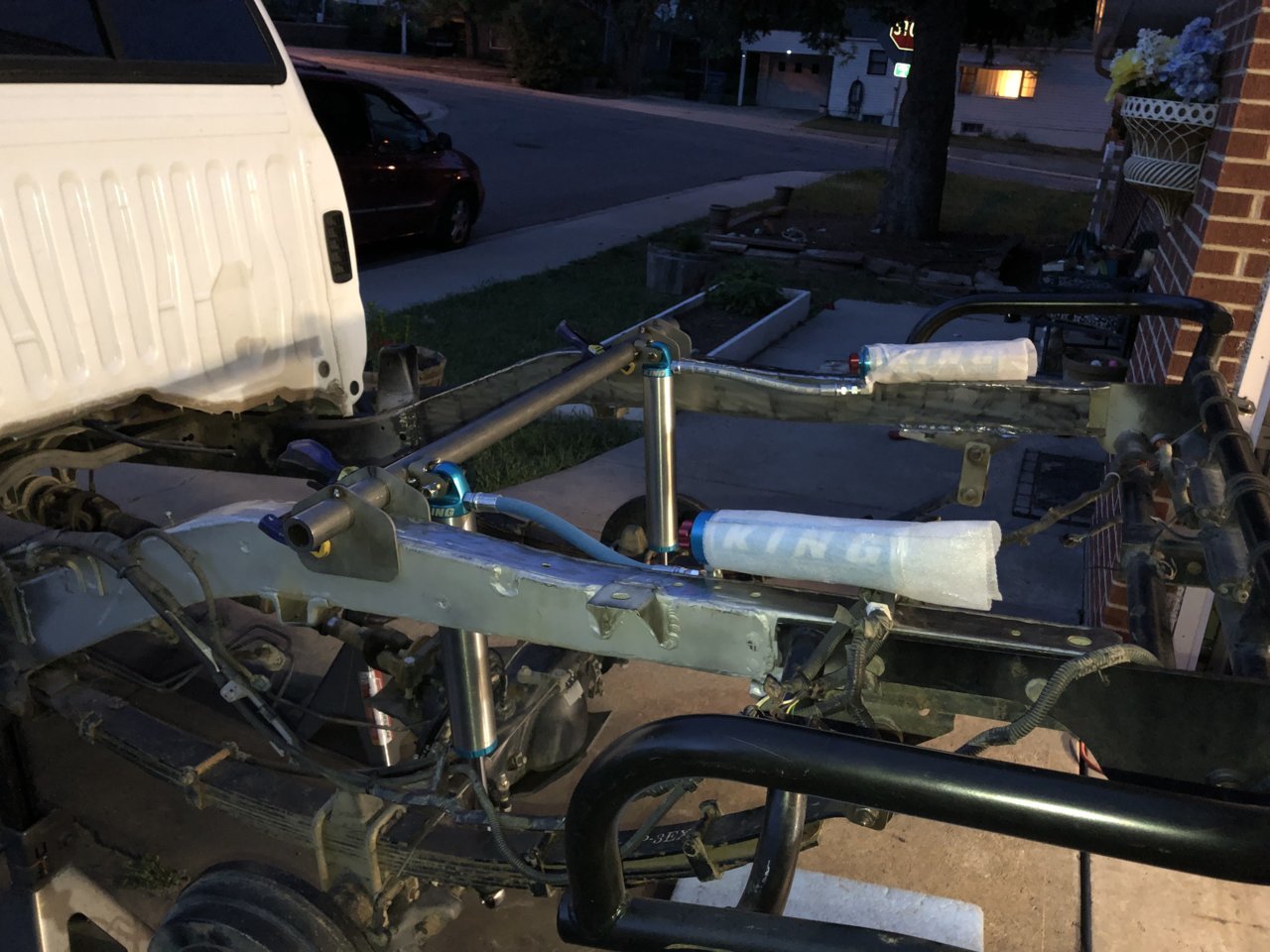

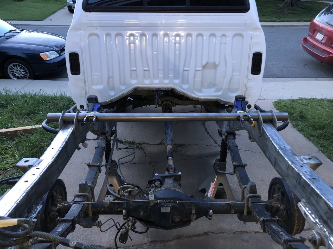

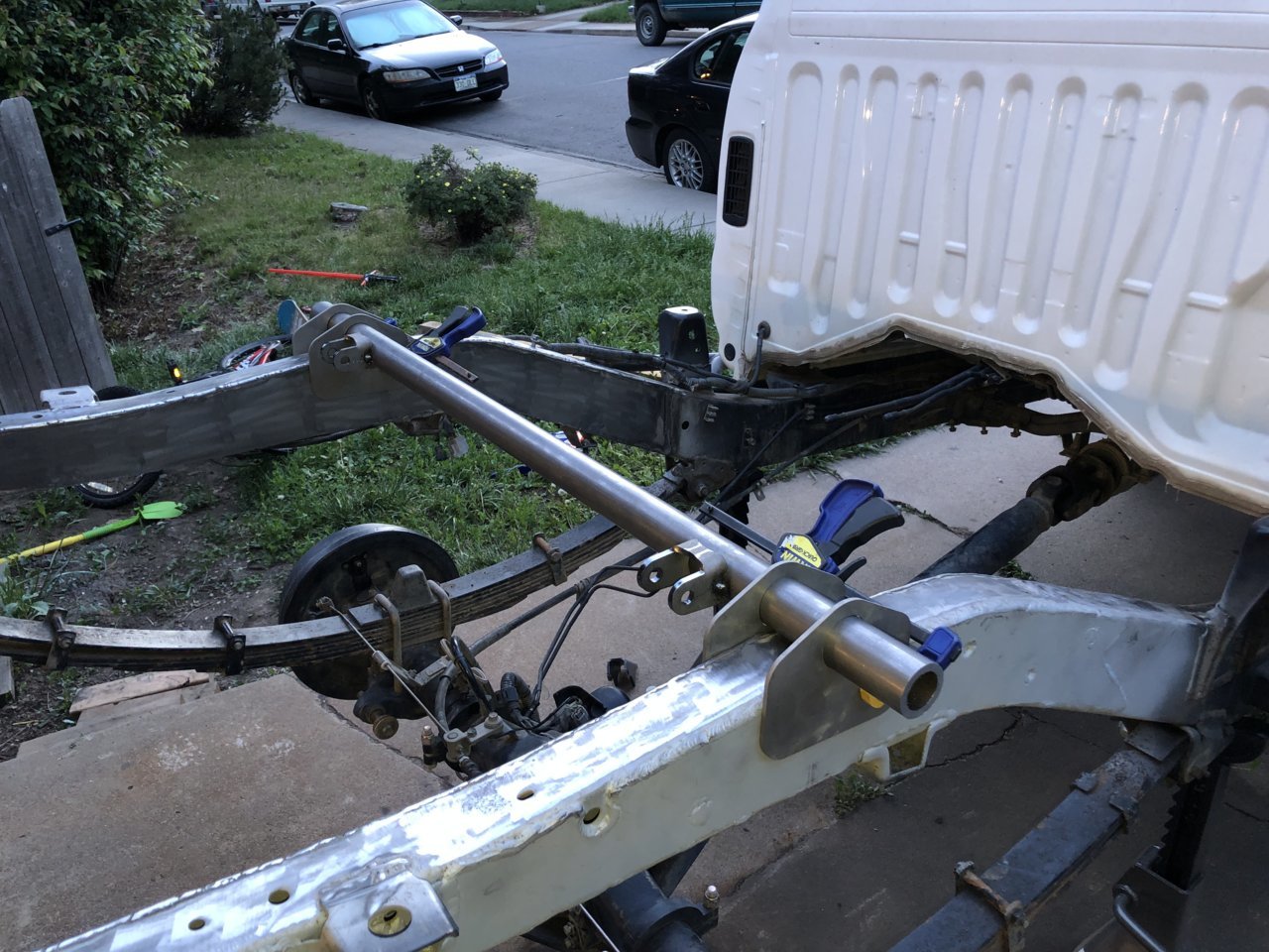

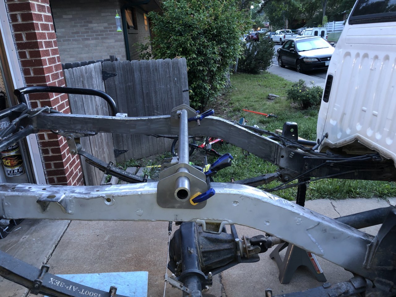

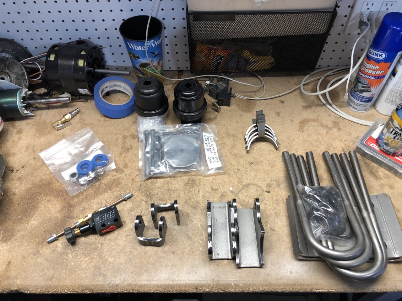

    Did a parts inventory and then started mocking up the upper shock mount crossmember and stuff. I think this is a pretty good starting point for cycling the suspension.
    I gotta admit, seeing the shocks in there finally, even if they’re just temporarily hanging from the mounts was pretty fucking cool :cool:

    Nice I like those tube mount plates
    SilverGhost and jubei[OP] like this.

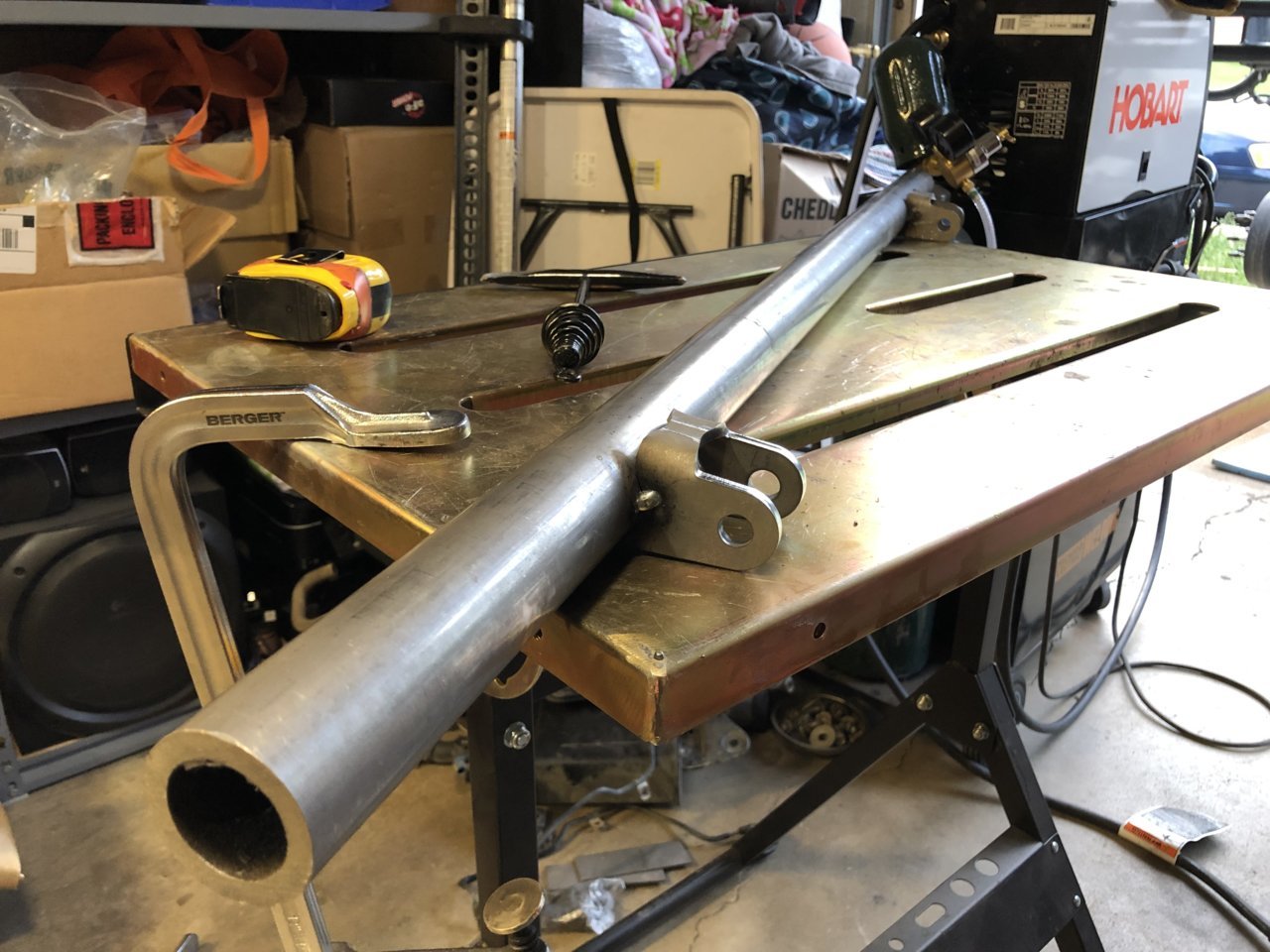

    Thanks! I drew those up and @TMFF cut them out for me on his water jet.

    He really is a good person to know... and be on his good side :burp:
    The cross bars he made for his GX to hold the RTT turned out freakin awesome

    It's not MY waterjet but.....
    That tube 0.188 wall! fucking overkill to the max!
