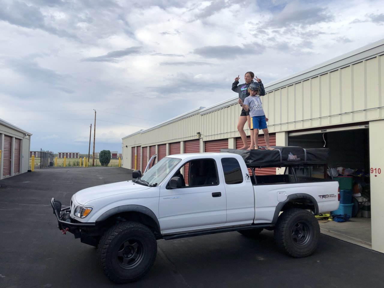

    I think it is crab walking a little. In my internet research, which basically makes me an expert, if the rear axle is rotated slightly the truck would need to turn the same direction as the rear steer in order to drive straight. Pretty sure that’s exactly what is happening because I wasn’t as careful as I should have been on the reinstall.

  13. Jun 25, 2019 at 8:15 PM
