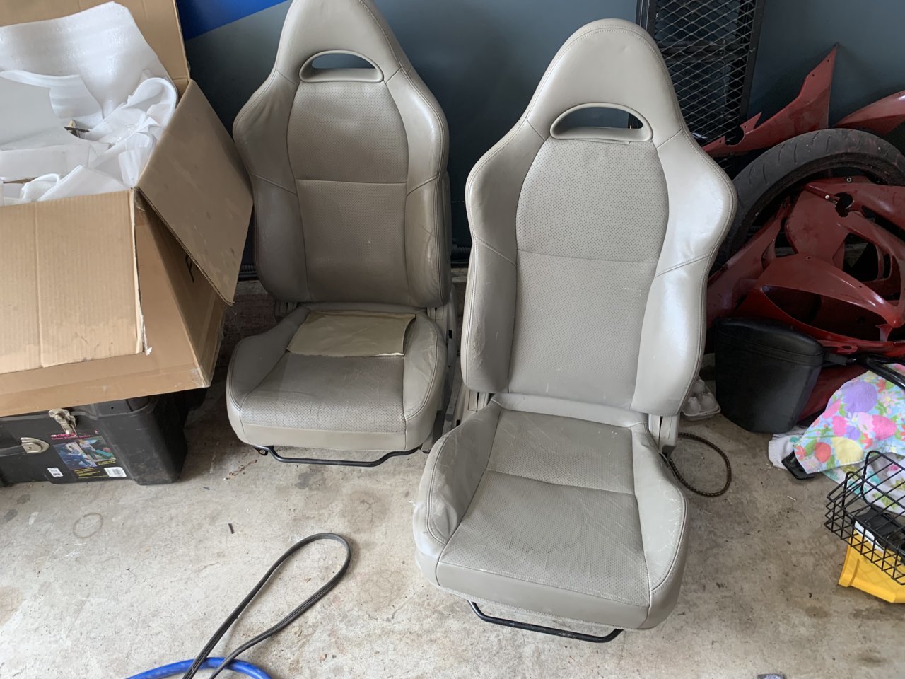

    Nice! Those will be worlds better than the stock seats.
    I’m gonna pull both of my seats tonight to steam clean them and then finally get the seat covers on them later this week. If you want, I can take some pics of the rails for you so you can see how mine ended up.

    Yeah man for sure, I'd appreciate that. I am going to test fit mine first and then decide how I want to handle seat repair. I am sure I can find a way to lower them a bit with some fabrication work. I'm stoked that the drivers side has adjustable lumbar too.

    What do you have to repair on the seats?
    And I’m jealous of the lumbar adjustment! The WRX seats are awesome, but oddly enough they only have height adjustment.

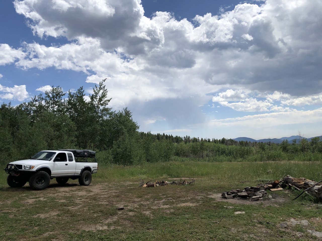

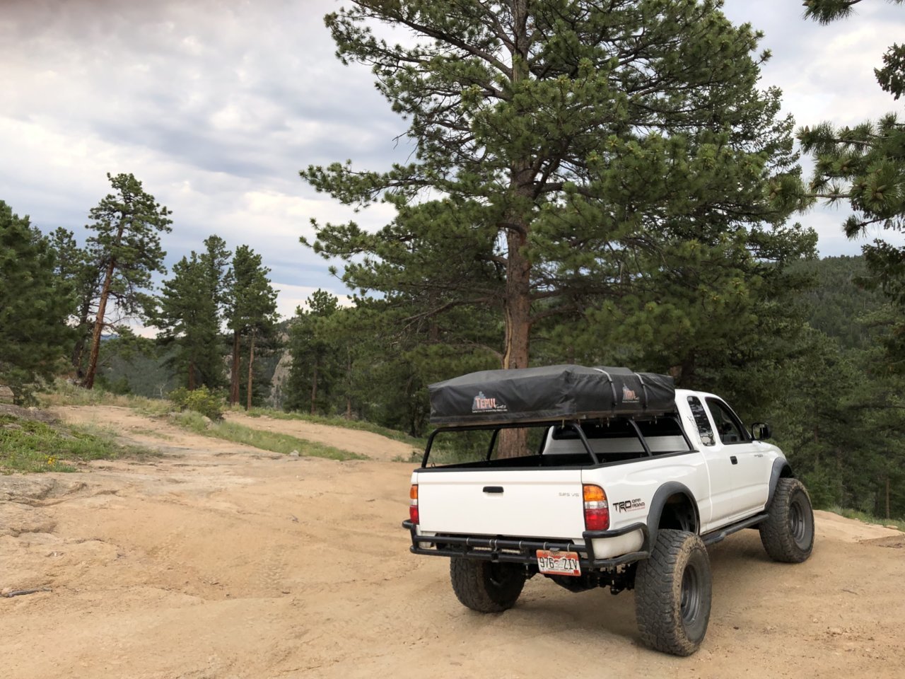

    Had a few hours to kill and I was up in Loveland so I decided to cruise up Big Thompson Canyon and then wander around on some dirt roads. I ended up taking Storm Mountain Road FS128 until just past the junction with FS153 when I had to head back to Longmont.
    The road was super washboarded but the impressive views of Mt. Meeker and Longs Peak made it worth it. I also found a sweet campsite with an awesome rock pile to play on.

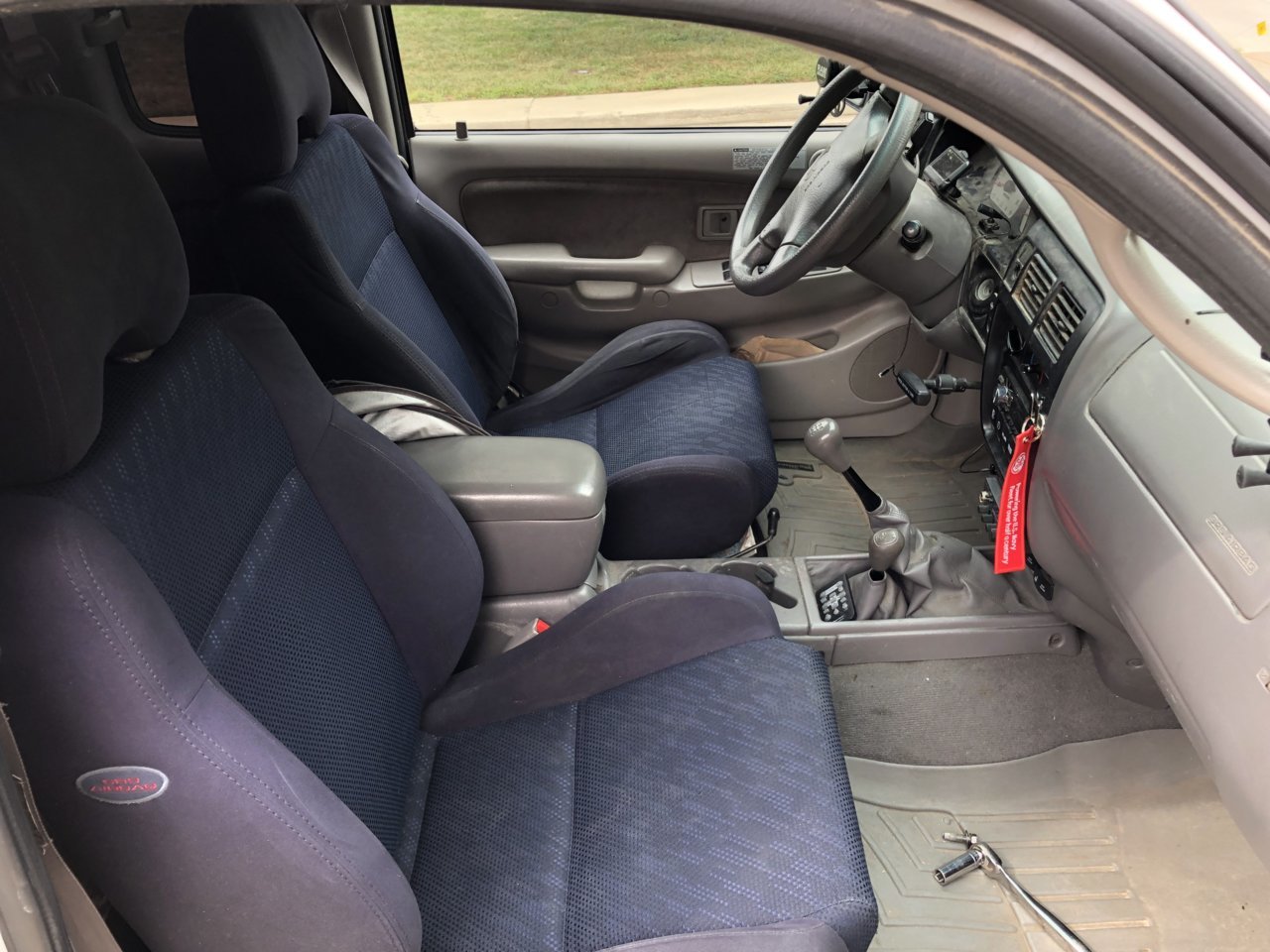

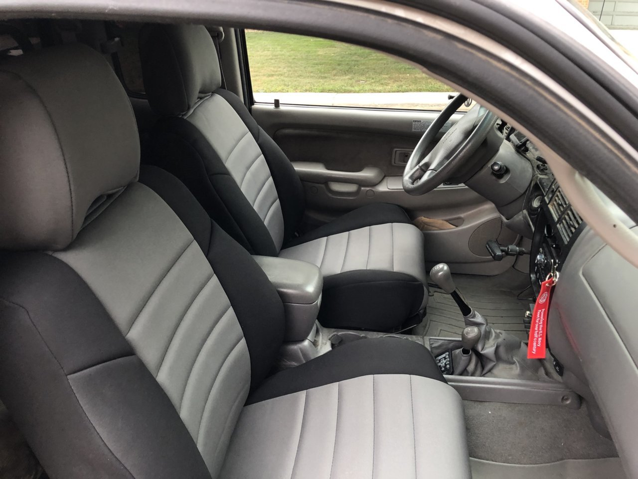

    When I got home, I finally installed the Wet Okole seat covers that I’ve had sitting around for a year or so. I’m looking forward to seeing how much comfier the WRX seats are now. Also, bonus points for having seats that match the rest of the interior again.
    Before and after:

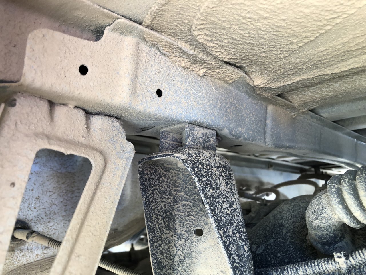

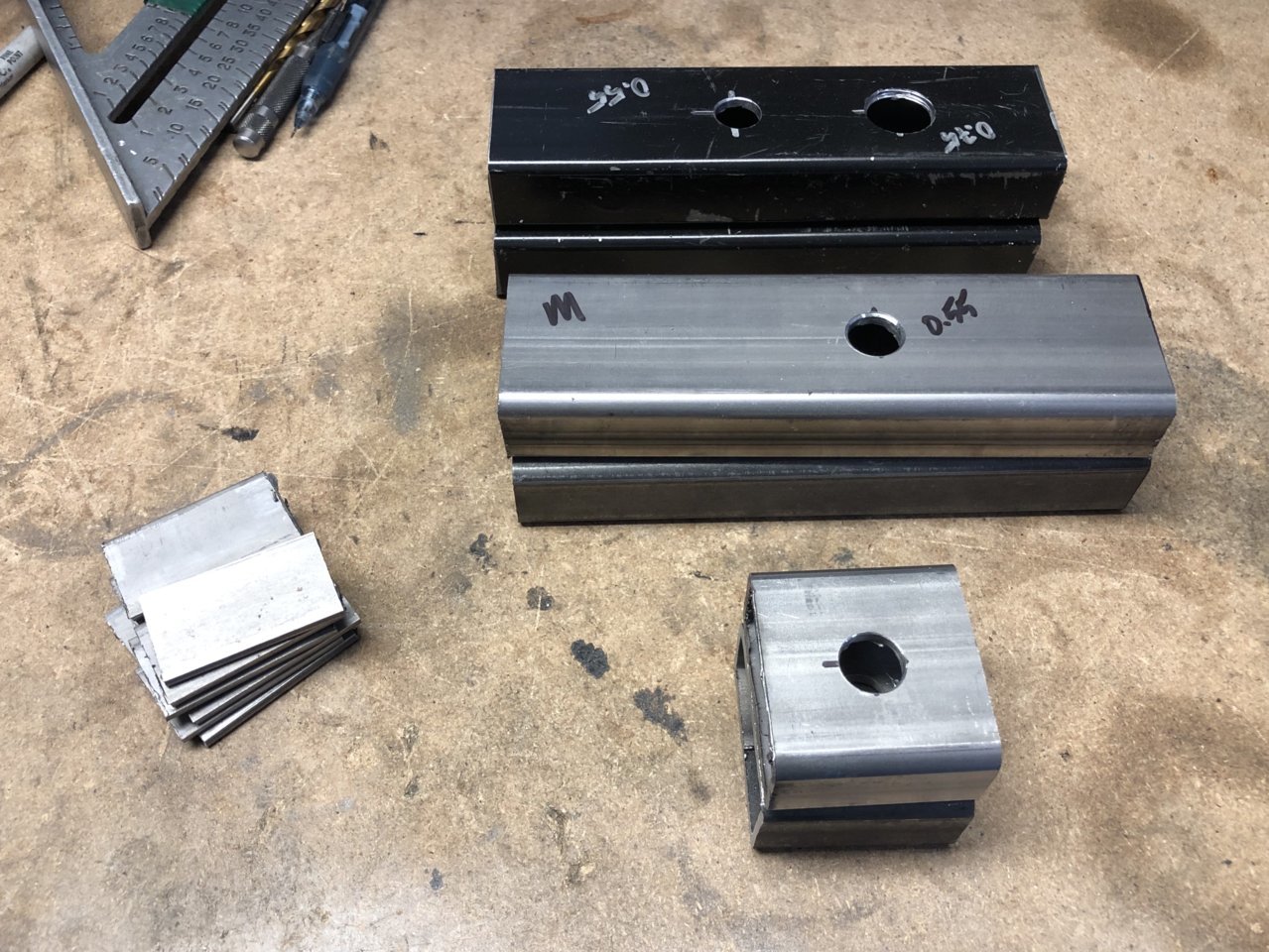

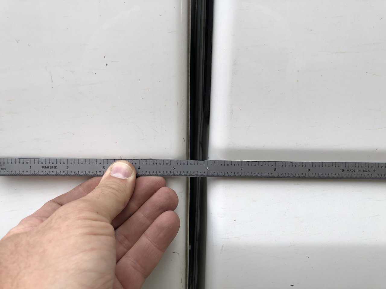

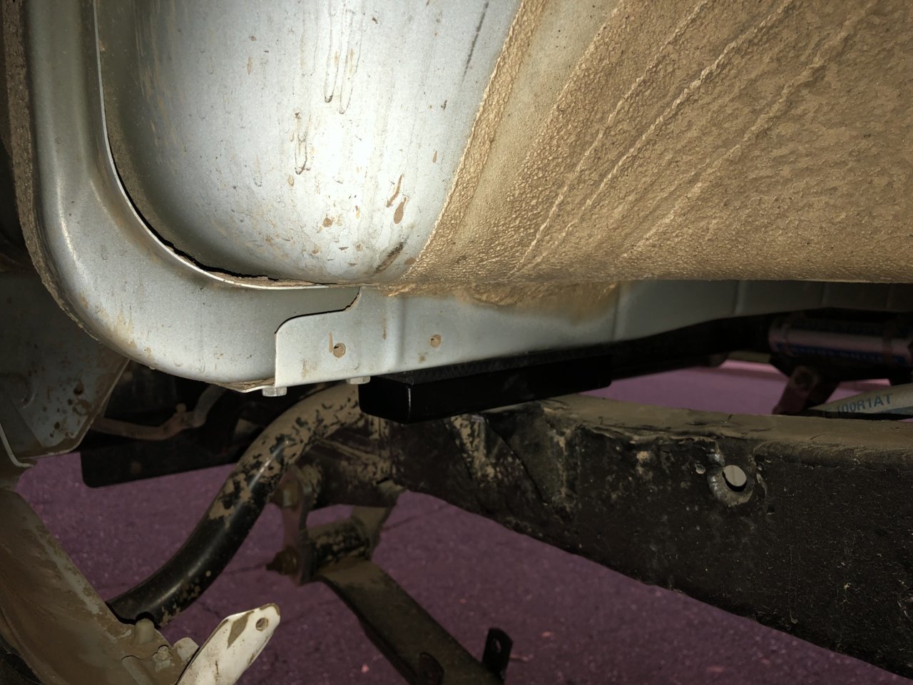

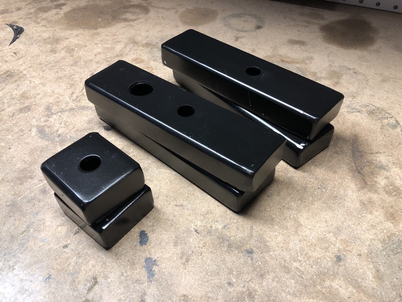

    Earlier in the thread I mentioned that the spacers supplied with my 1” body lift were too small and that they were punching themselves into the sheet metal cross brace under the bed. So much so that the body lines where the bed meets the cab are noticeably off.
    My solution was to fab spacers that were wider in both dimensions. The ones supplied by Daystar have a load bearing surface that is only 1.25” square, but the new spacers are all made out of 2x1 1/8” wall tubing. The two forward mounts are now seven inches long and the two in the rear are two inches long. I also capped off the open ends of the spacers, welded them, ground them flat, and painted them.
    They turned out pretty decent, I think. It’s little projects like this that make me happy that I have the tools to do shit like this!

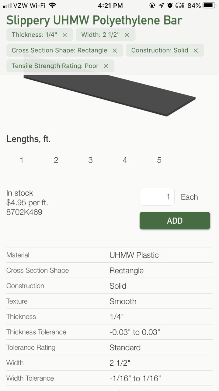

    The last piece of the puzzle is some UHMW shim that I’ll use to fine tune the body lines. It’s really good stuff that can hold up to the loads between the bed and the frame.

    That interior looks amazing. Should probably clean mine up.

    Yeah, your spacers has fully punched through the crossmember, right? I got lucky and mine are just starting to dimple a bit but I’m sure they would end up like yours eventually. I’ll be looking forward to seeing what your fix is when the time comes.

    Yes, had one completely punch through then added some 3/16 plate to help disperse the weight a little better until I could get around to doing something like you just did. But after the last trip I lost a spacer and noticed the center crossmember is cracked on both sides as well. So the whole bed will be coming off and new crossmembers made along with raising the fuel tank.

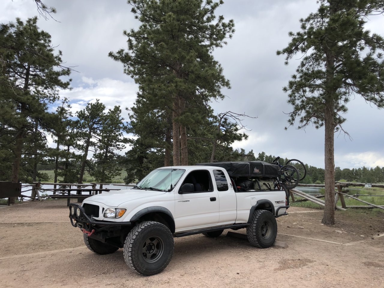

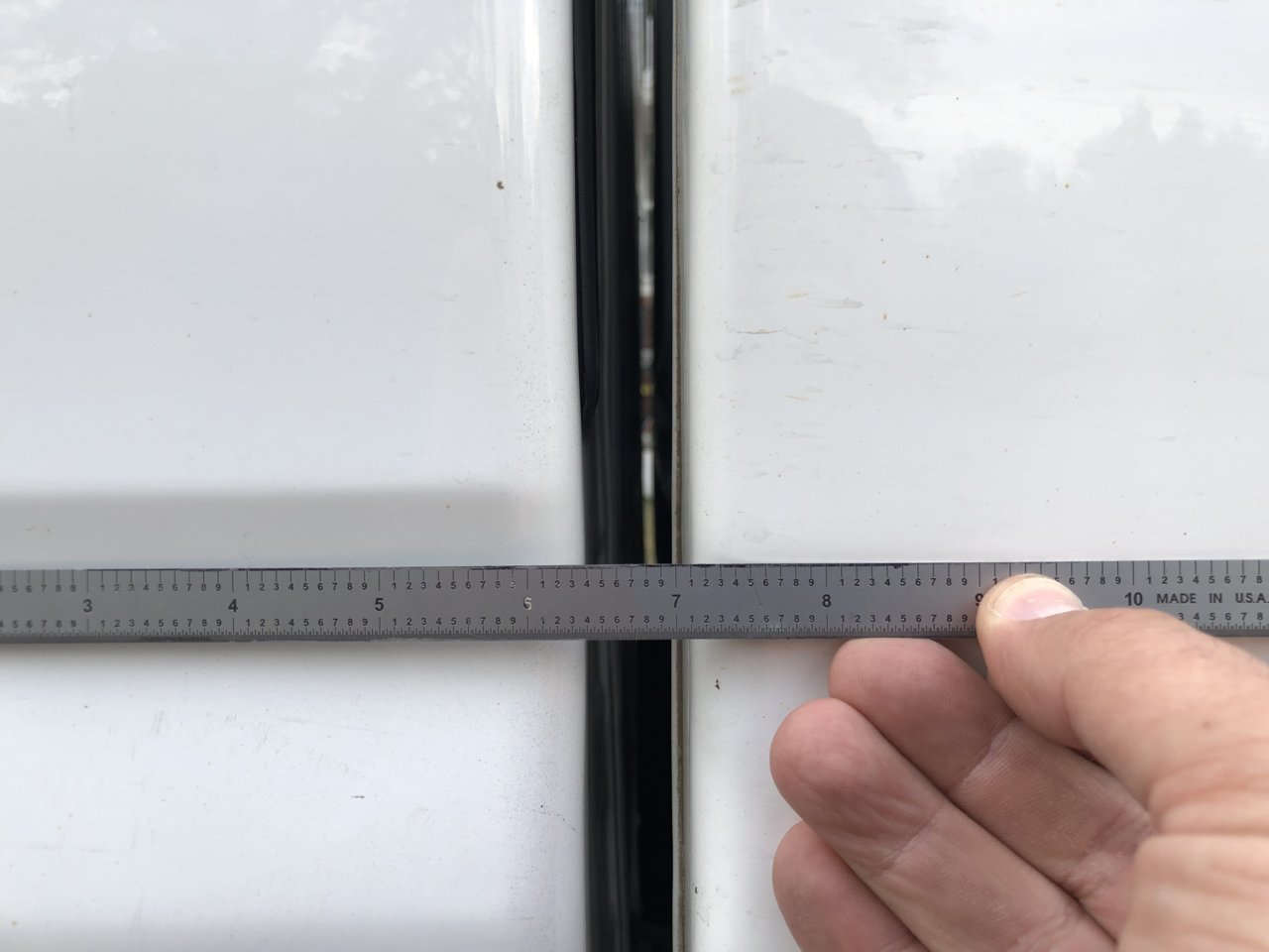

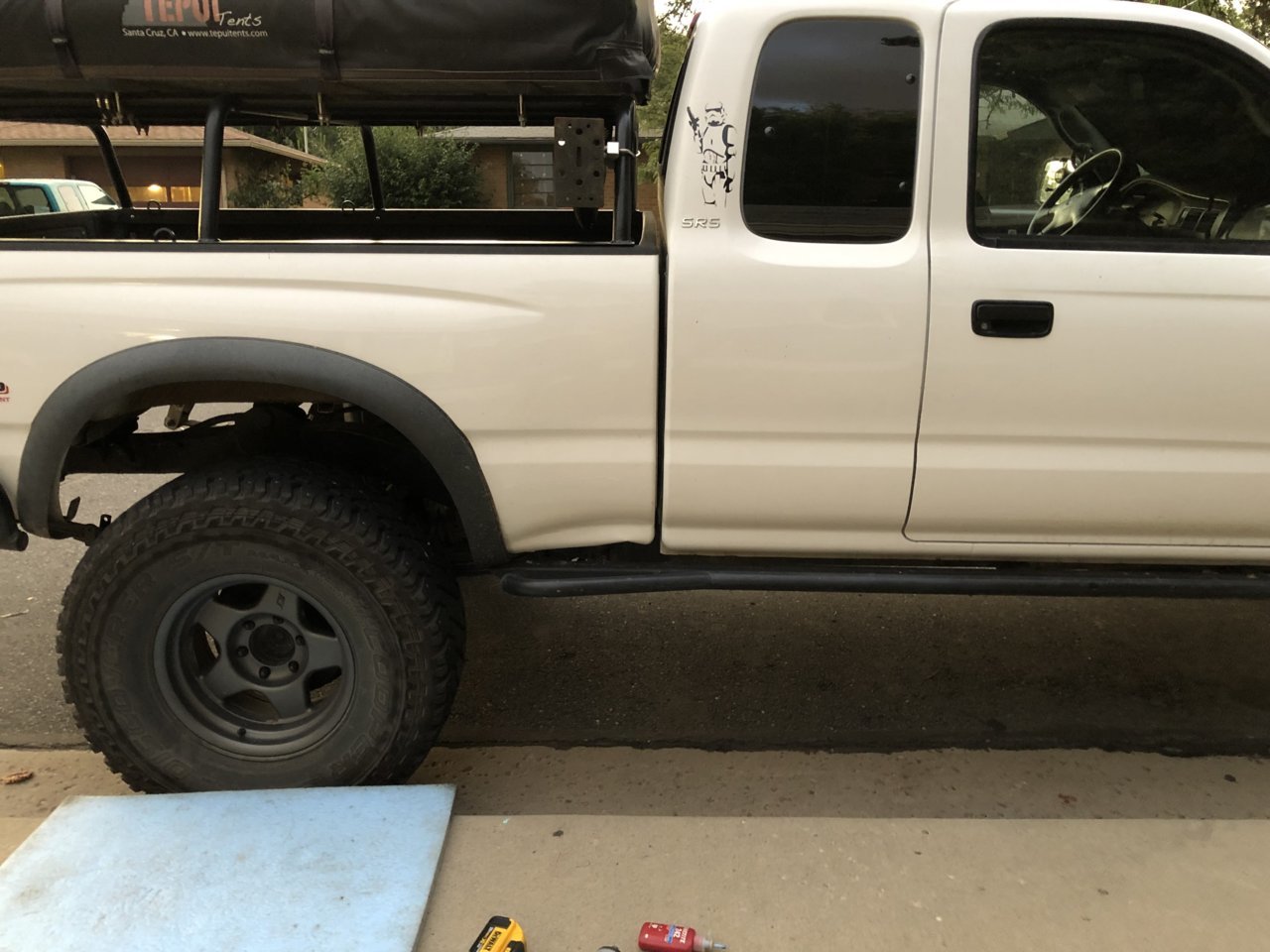

    Got the bed spacers in after scrambling to find some 10.9 bolts that were 10mm longer. Turns out there’s a kickass fastener store that specializes in metric just down the hill from my house. The bolts were literally 20% of what they would have cost me at Fastenal :eek:
    Anyway, the 1x2 rectangular tube spacers and the 1/4” UHMW shims worked perfectly for getting the body lines between the bed and the cab to line up again. You can see in the pics below that the bed line was almost 1/2” below the cab line on the driver side and around 1/4” on the passenger side.
    This was a cool little project and I like how it improved the truck both structurally and aesthetically. Now I need to save up for a drill press and vise and get away from using a hand drill for this shit.

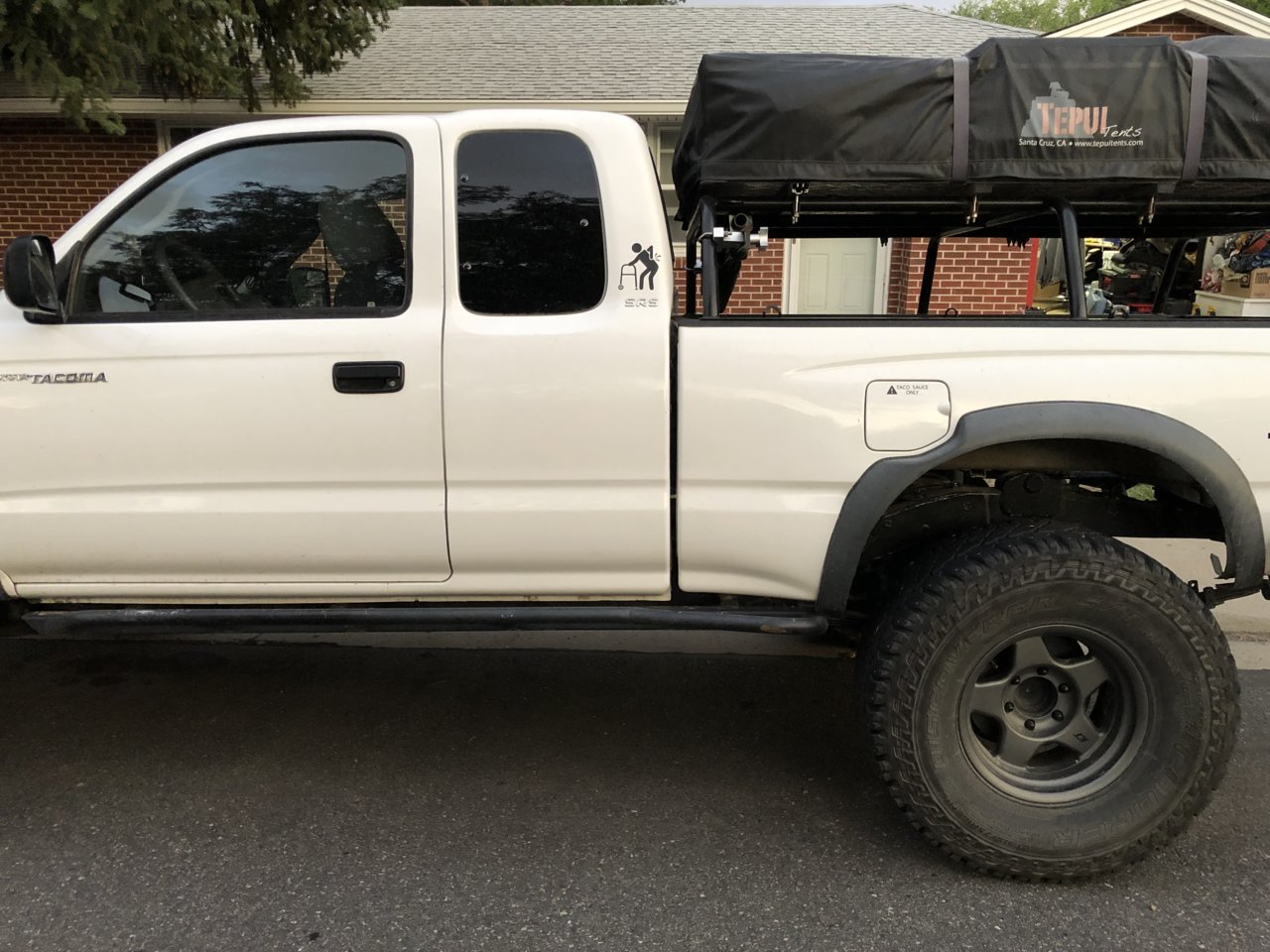

    I didn’t take any wide angle pics of the truck before the work, but you can see it in the pictures below, especially on the driver side. You can see exactly how much in the close ups.
    BEFORE:
    AFTER:

    It's very subtle but once you point it out it's hard to not see it. I always hate those type of issues but it's very satisfying when it's fixed. Looks a ton better :thumbsup:

    And yeah, it was only gonna get worse up to the point where the shitty Daystar spacers finally punched through the bed crossmember. It’s nice to have it fixed finally.
