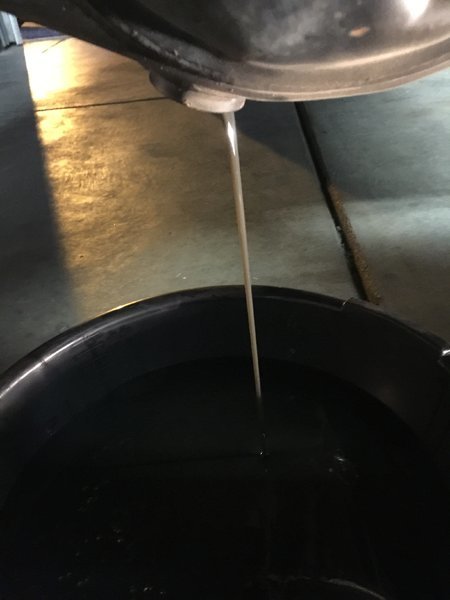

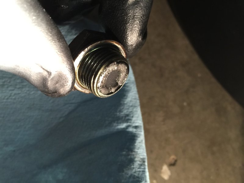

    Regear - New 3rd Member and Clamshell w/ARB
    Hit my 500 miles on the new rear gears today. (Well, according to the trip meter it was 560, but that's on a mismatched speedo gear...)
    Anyway, I drained the oil and replaced it. Nothing unusual. As expected the oil wasn't black, but it was more of a metallic gray. Here's a shitty picture with my shop light.
    The drain plug definitely had some shavings, but it was all the expected small particles; no big chunks :)
    After cleaning up the drain plug, I threw it back in and filled it up with three quarts of Lucas 85W-140, per ECGS recommendation. Torqued both plugs to 36 lb-ft, per the FSM, and that was that.
    As for the front, I'll go ahead and change it tomorrow, despite the fact that it's nowhere near 500 miles. I'm thinking seriously about changing both diffs again at 1000 miles (for the rear), and then proceeding at the usual intervals.

    I changed mine at 500 and again around 1000, The 2nd change had some shavings in it too.

    Well if Ray and Brett recommend doing it, then I'll do it! I really want to take care of these gears.
    I'm going to try hard to get some dirt/gravel road time in as much as possible to keep the front diff break in going. I figure if I'm lucky, I'll have maybe 200-300 miles on it by the time I get to 1000 in the rear. Regardless, it'll get changed with the rear, which can't hurt.

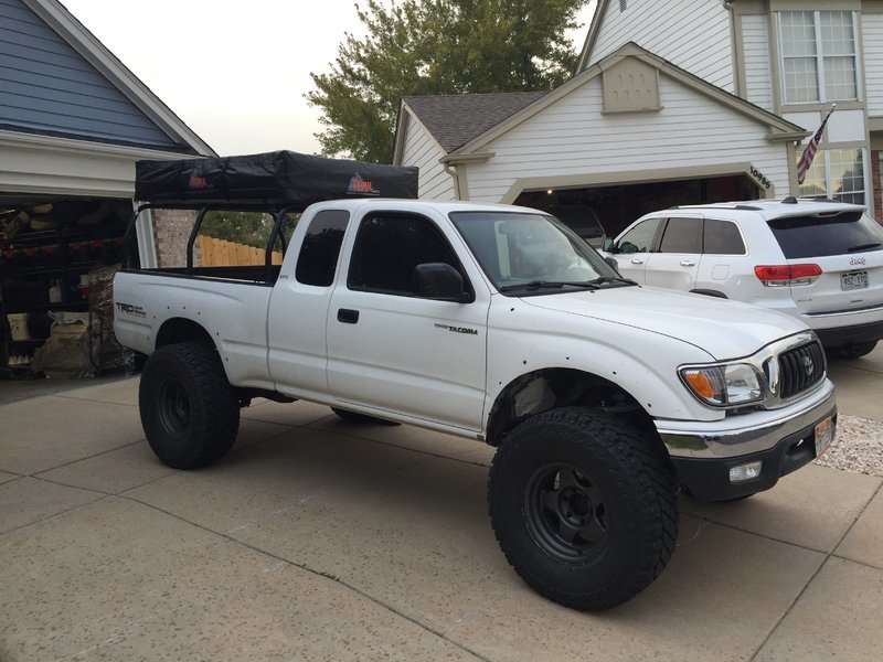

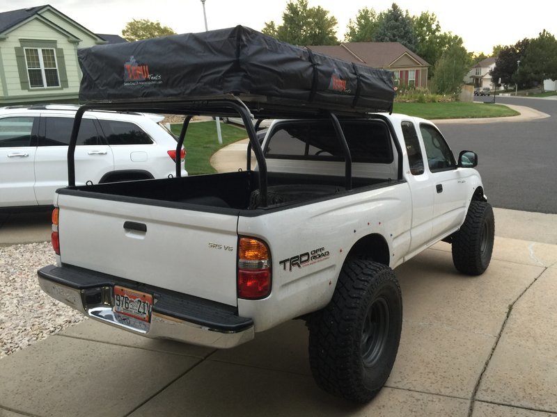

    Roof Top Tent
    Finally.

    Looks good bro! Bet it feels great to be done......well we are never done modding, but you know what I mean.

    Lol "done." Looks awsome dude! Buuut :notsure: Where them big metal bumper things at!?!

    Looks great! Love how the trucks progressing man. Your wheels are 3.5" BS with 1.25" spacers right? I'm considering going 4" BS with 1.25" spacers just so overall BS won't be 2.25" but instead 2.75".

    Great looking truck man. When I saw your thread title, I immediately started singing the song. I was happy to see you had the youtube link in your OP. Hadn't heard that in a loooong time :)

    What tires do you have? Of course after I pretty much decide on SCS SR8's I see your F5s :annoyed:

    You're close! I have SCS F5s on 16x8x3.5BS, with 1" BORA spacers, for 2.5 total backspace. So far, that has worked out perfectly along with the (still not quite finished) tubbing. I'm amazed at how well this sexy beast turns with those big ole tires :thumbsup: I think you'll probably be just fine with 2.75, honestly!
