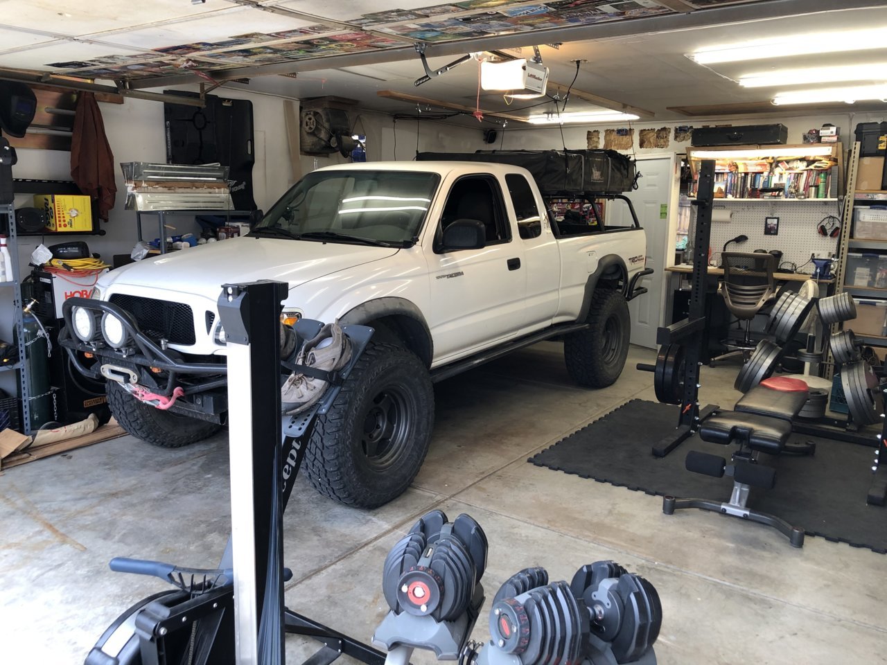

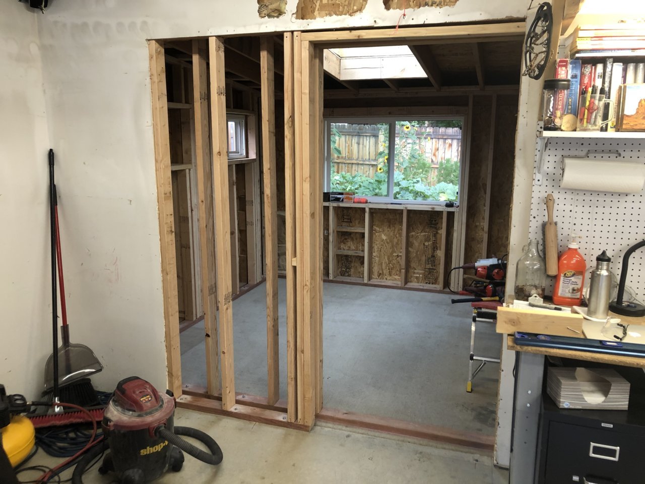

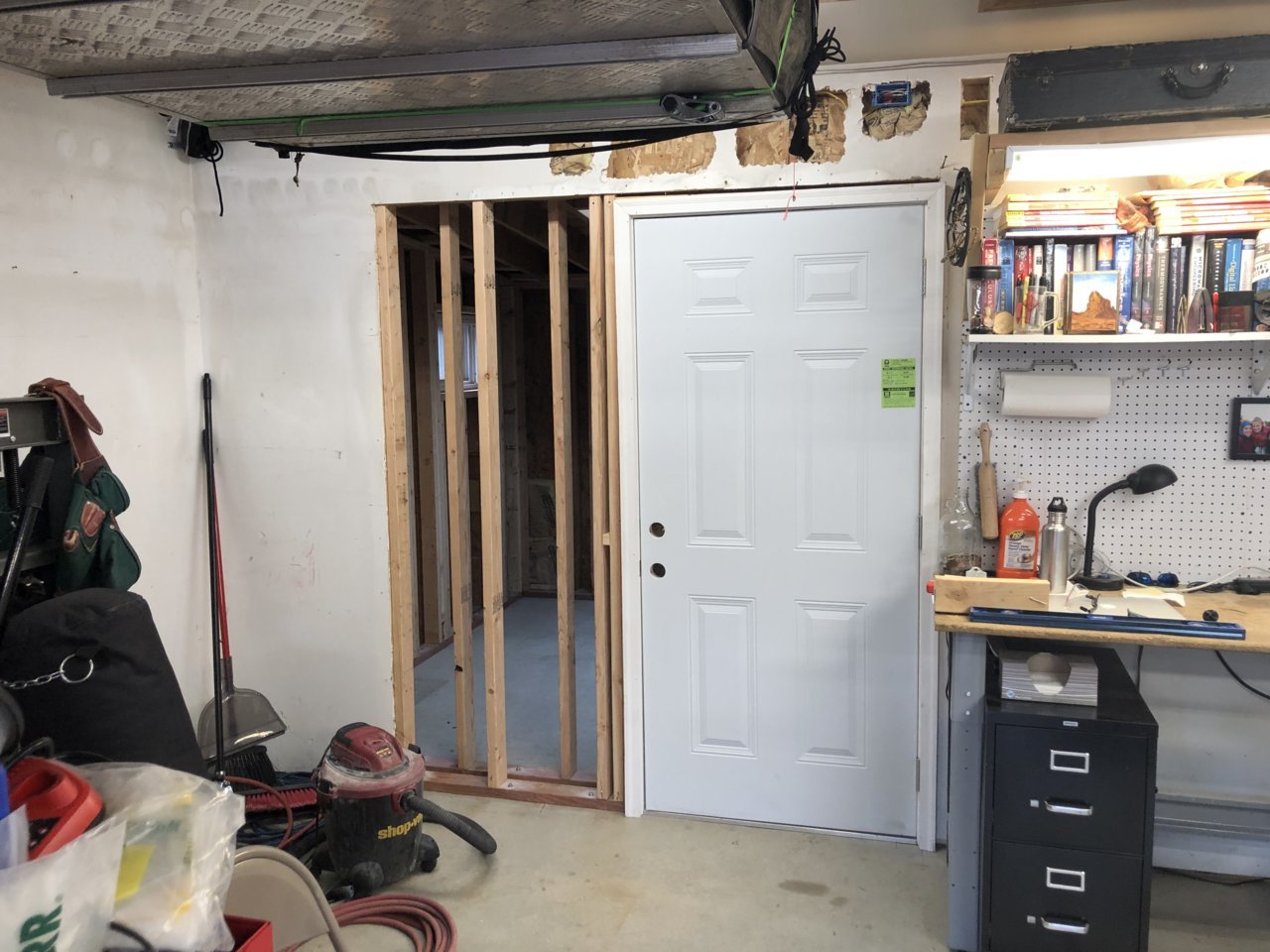

    Framing is done in the man cave! And the door even fits in the rough opening! Next up is running a couple 15A circuits, then installing insulation after that.
    It’s getting there!
    This is sorta what the end result will look like with the office door right between my workbench and my tool boxes.

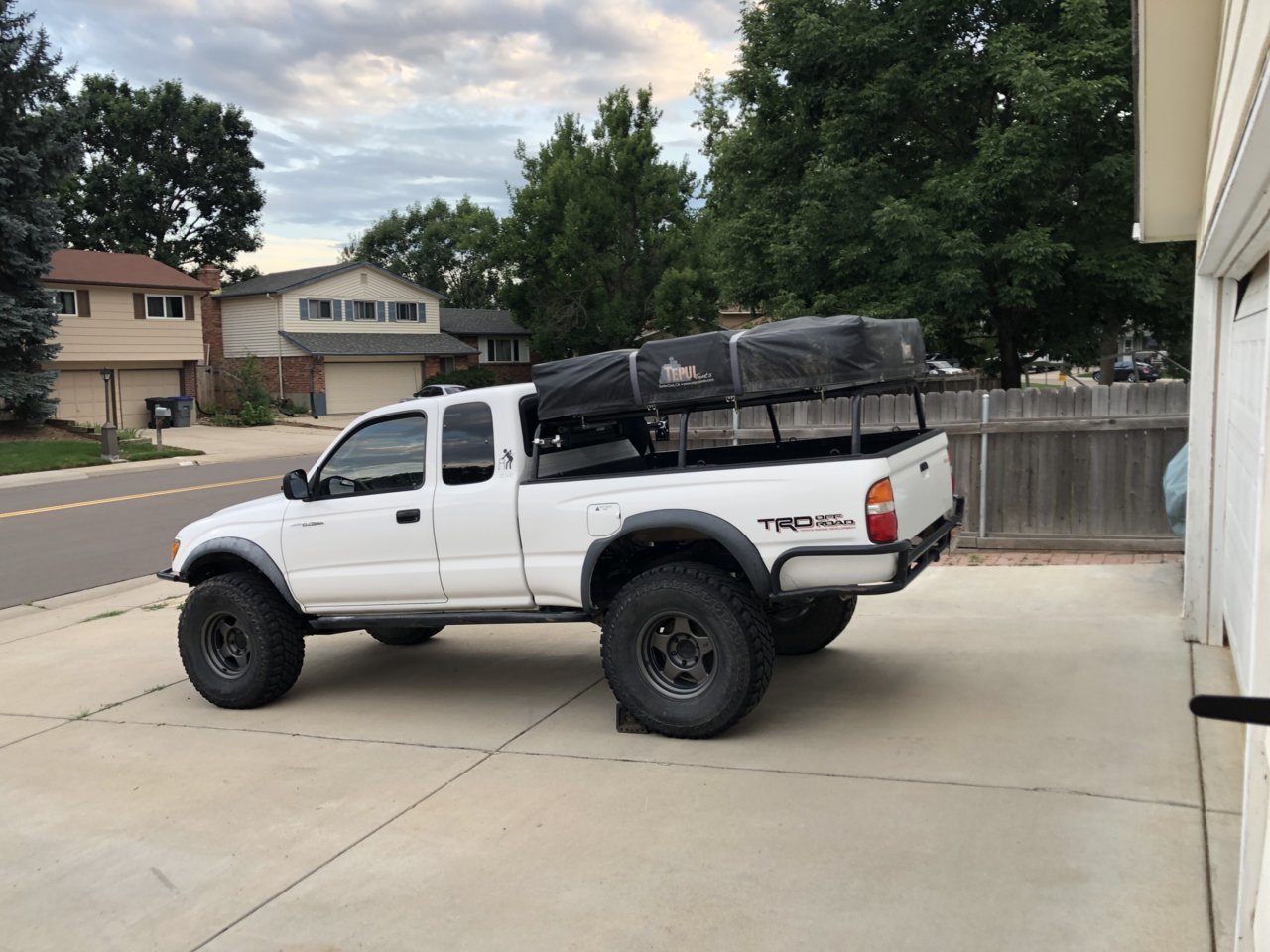

    I also got the RTT back on the bed rack, and holy FUCK do I love the hoist system. After having the damn thing nearly crush or herniate my shit so many times putting it on and taking it off, it’s a damn godsend. It took three minutes to get it back on the rack and lowering it was super controlled with the block and tackle. I’m incredibly pleased. Now I know for sure that the tent can live in the shop most of the time and it can be conveniently be dropped on the bed rack on the rare occasion that we want to camp like Insta influencers.

    Manual or electric hoist system? I’m probably going to install a couple here soon. Just starting research.

    It’s manual, but because it’s a 3-pass block and tackle, it is super easy to raise and lower the load under control. I really like it.
    Here’s the post describing it in a little more detail:
    https://www.tacomaworld.com/threads...rado-gtfo-build.427567/page-123#post-23134290
    That said, there are some fairly inexpensive 120VAC electric hoists out there if you wanted to go that route.

    Just lag bolts into the garage ceiling joists?

    Per the instructions, I used lags to bolt 2x6s to the trusses (I think I was able to catch at least three of them), and then the pigtail lags screwed into the 2x6. I also ran the eye bolts for the ratchet straps into the 2x6 as well. It’s stupid solid.

    Nice. There's a very good chance I'm building a new garage and was wondering if I could do something while it's still just framing and not drywalled.
    jubei[QUOTED][OP] likes this.

    do you just tie off the rope to hold it in place?

    It has a cleat (?) that’s part of the block and tackle assembly that acts kind of like a climbing ascender. I don’t tie it off only because the ratchet straps get cinched down as soon as the RTT is up against the ceiling. If I weren’t using the ratchet straps to ultimately hold the tent rather than the hoist, I’d definitely tie the hoist rope off instead of relying on the cleat (if that’s what it’s called).

    Gotcha im picturing the clear as a device similar to those auto belay things in climbing gyms lol. Regardless it looks legit. Im gonna give it a go :D

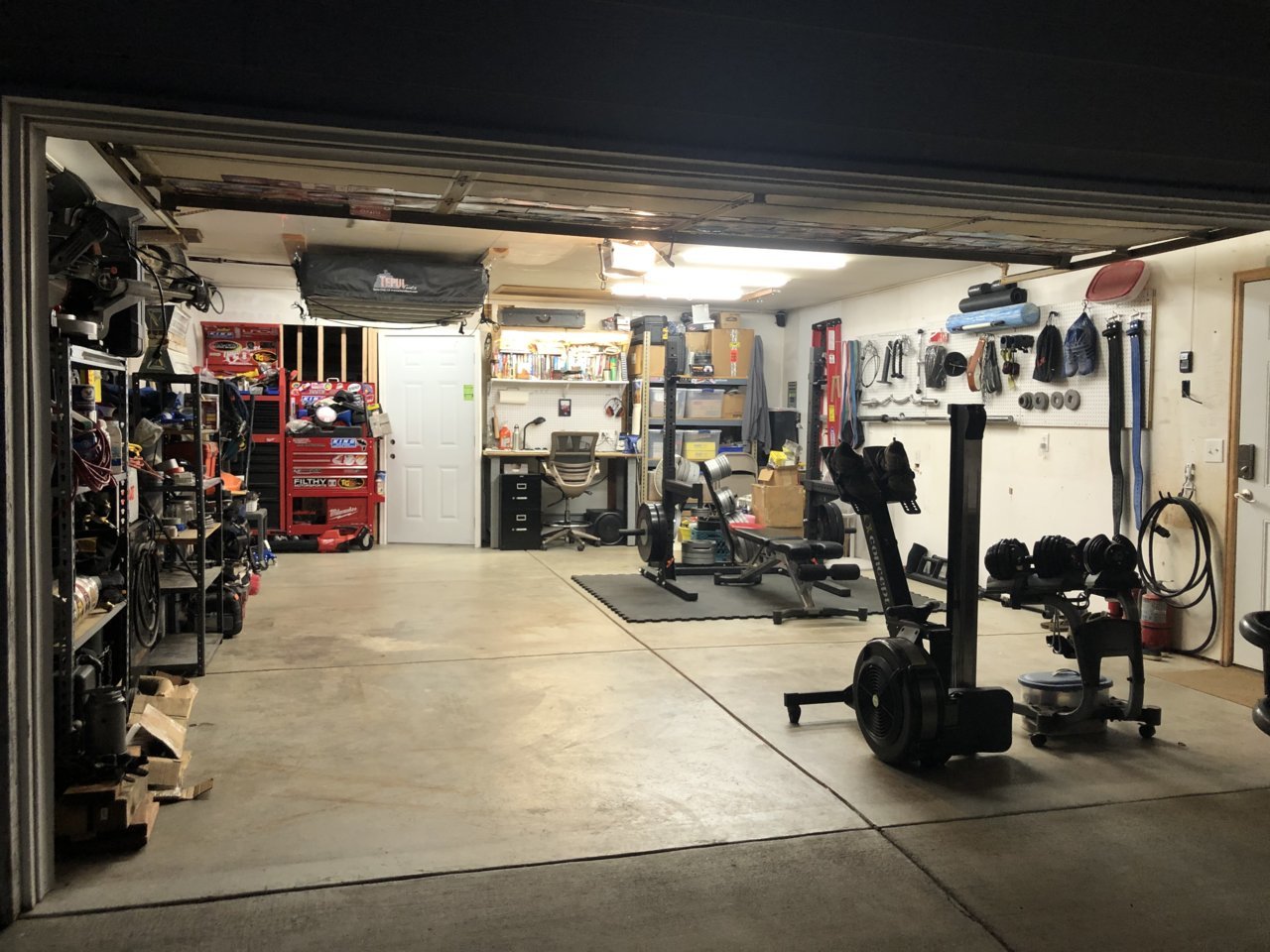

    The truck did great, and it was absolutely fucking fantastic to be able to just pull the truck into the shop directly, grab our clothes bag, plug in the fridge, and leave the truck loaded up rather than be forced to unload everything immediately because I didn’t want to leave it outside. Now today I can unload at my leisure and then wash all the road funk off of her.
