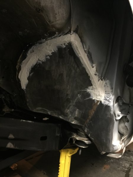

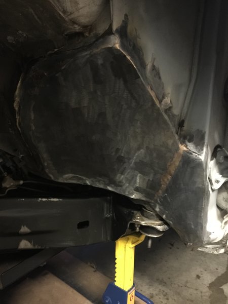

    Here is the result (not a great picture):

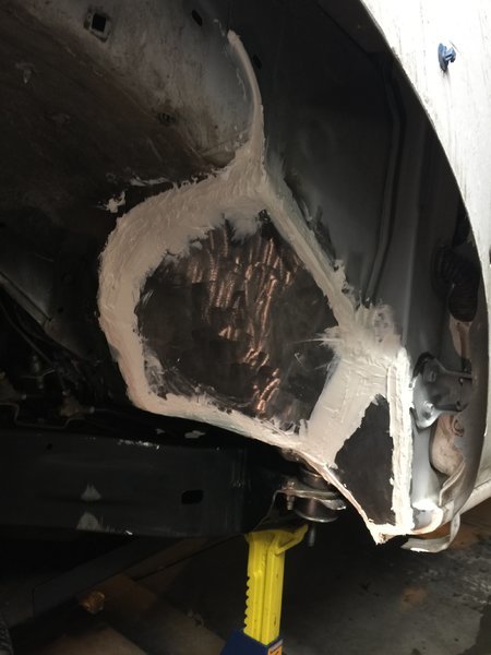

    Applying the seam sealer was a bit messy, but not a terrible process. That is, until the plunger in the tube decided to rupture and let a little over half of the material out into the caulk gun. I was not pleased.
    During the sanding and cleaning process, I had noticed a few pin holes and areas where the sanding had gotten a little overzealous and had taken most of the weld. I hit these areas prior to the broader coverage in order to make sure that they were filled with sealant.
    Here is the sealing job at the halfway point, right before I noticed the ruptured tube.
    Because I noticed right away that the sealant was taking a set much sooner than the half hour or so I assumed, the final job wasn't exactly a work of art. Like most RTV type adhesives, it's most likely a moisture cure, so I think the cool weather and slightly higher humidity made it start to set much more quickly. I'm the end though, it's the firewall on a truck. It's good enough.
    Here's the final product:
    Next step on this side after another clean and prep is to apply Herculiner to the entire inside fender well and firewall! I also want to seam seal the inside sides of the welds as much as possible.
