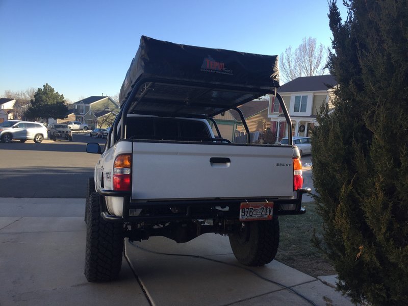

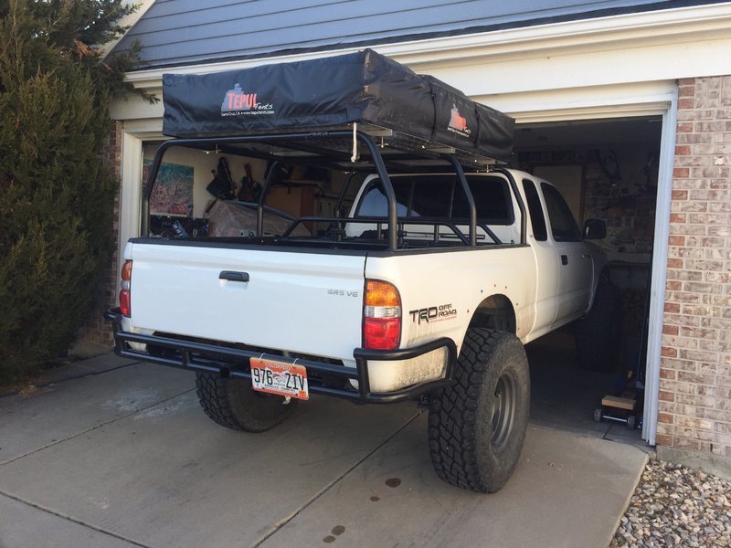

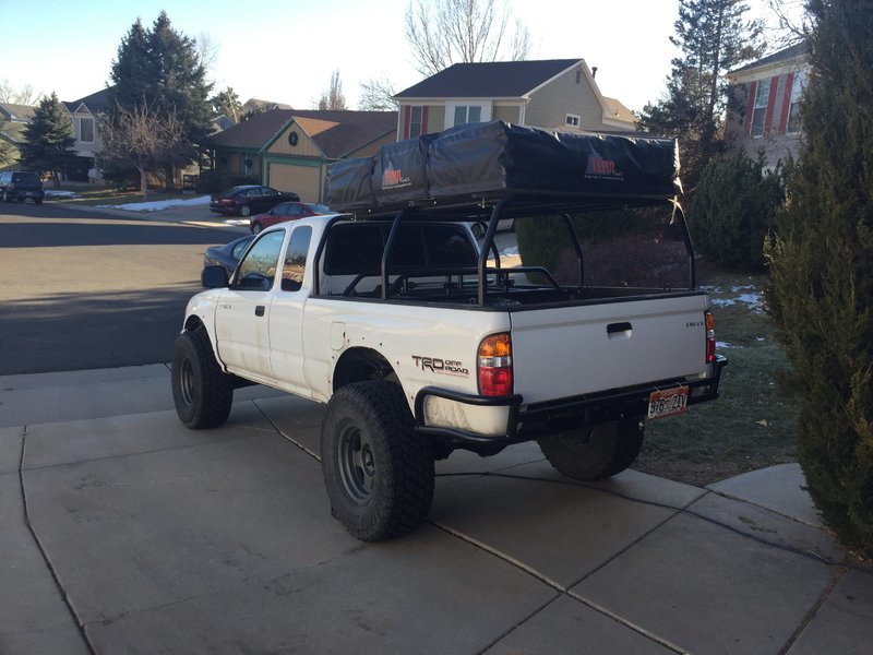

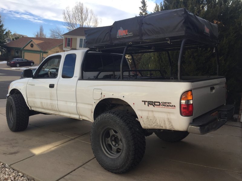

    Trail Gear Rear Tube Bumper Install
    It isn't huge progress, but it's still progress!
    Got the new Trail Gear rear bumper mounted up last night.
    BEFORE:
    AFTER:

  5. Dec 31, 2016 at 1:53 PM
    #325
    LogCabins
    LogCabins Well-Known Member
    Apr 30, 2014
    #128878
    2,310
    Robert
    Oahu
    99 SR5 3.4L 4WD
    Looks sick Jason....sooooooo much better!!! :headbang:
    jubei[OP] likes this.
  6. Dec 31, 2016 at 1:57 PM
    #326
    jubei
    jubei [OP] would rather be doing something else
    Mar 17, 2016
    #181549
    6,066
    Jason
    NoCo
    White 2002 XC TRD and Yellow 1971 JEEP CJ5
    Stuff. Also things.
    Thanks, Robert!
    I'm really happy with it. The fit was absolutely perfect and exactly what I was going for!

    Nice. Such a clean bumper design. I have always liked that one.

    Thanks, man! I love tube bumpers on the 1st Gen trucks. And the simplicity of this one just always appealed to me.

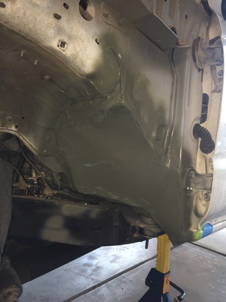

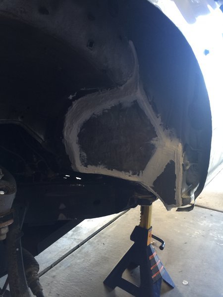

    Firewall Tubbing for 35s - Sealing and Finishing
    I managed to get a little bit further with sealing up the driver side firewall tub.
    In hindsight, I wish I would have done self-etching primer after all of the rust removal and prep work and before the seam sealer. But I didn't, and I'll just have to see how well things hold up going this route.
    Anyway, this afternoon I was able to get a few good coats of self-etching primer down over the tubbed area as well as the seam seal.
    The first thing I did was hit the tub itself with a wire wheel to remove any surface oxidization and also give the metal a little bit of 'tooth' to promote good adhesion. The next step after that was to wipe everything down with acetone, including the sheet metal and factory sealant beyond the weld areas. I forgot to grab a picture of everything post-prep, but this is basically what I was working with prior to that.
    Then I just threw down a few light layers of the self-etching primer over the entire tubbed area and slightly onto the original surfaces beyond. Hopefully this will be a good base layer for the Flex Seal and Herculiner. The goal for today was just to get the damn exposed sheet metal cleaned up and covered up at the very least. Mission accomplished!

    Id say your looking pretty good there jason. You're painted over the seam sealant and if your hitting it with herculiner that will give you an even better seal. Definitely do the flex seal over as the last layer of protection if you feel you need it. But that definitely looks solid to me

    Agreed, sealing def looks great. Your tub job is so clean too, looks nice and smooth. Rear bumper looks good too! Might need to end up moving that plate to the tailgate eventually if you ever dig the rear bumper in anywhere. I've lost mine a couple times. :X

    Thanks, Rob! I really like the idea of the flex seal over the bedliner in the tub area. It definitely couldn't hurt, and I don't want to take ANY chances with leaks.

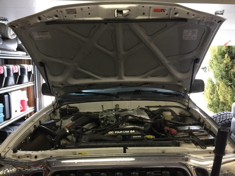

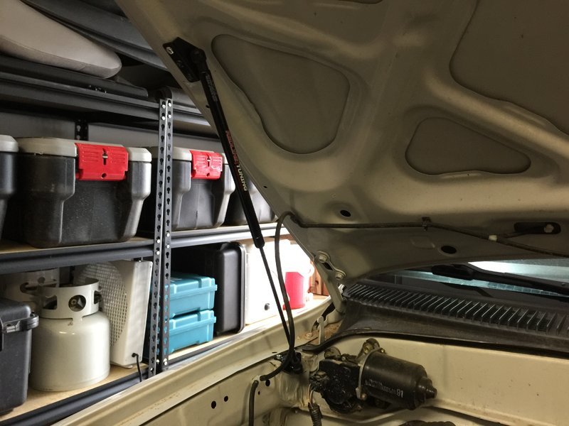

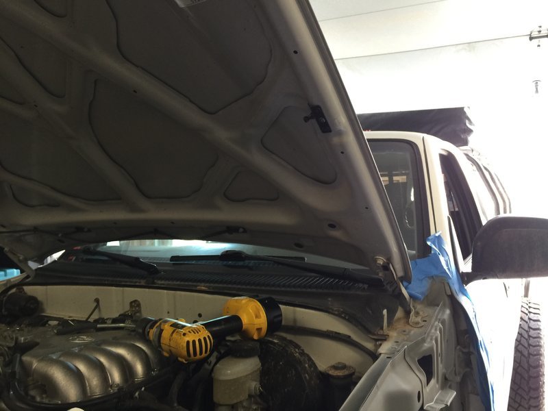

    Redline Hood Strut Install
    As I was waiting in between coats of primer, I decided to knock out my hood struts once and for all. Like a lot of my pending mods, I have had the parts sitting on my rack for a month or two and I'm just now getting around to doing the work.
    HOOD PIVOTS:
    Despite the dire warnings in the instructions, I still dimpled the hood skin juuuuuuuust a little bit on one of the six holes. But that's all it was, thank goodness.
    THE FINISHED PRODUCT:
    I'm already hopelessly in love with these damn things. I must have lowered and raised the hood about ten times, giggling the whole time.
