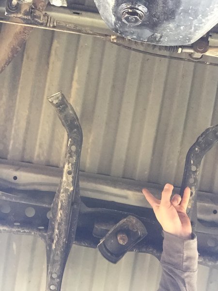

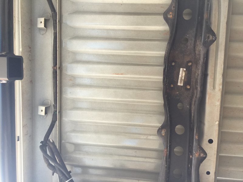

    No need to worry with those couple bolts. Whenever you get time, could you measure from the front (closest to the rear axle) side of this bed cross support to the edge (also closest to the alxe) of the hitch? No hurry at all. Thanks again.

    @rngr
    Posted this in your build.
