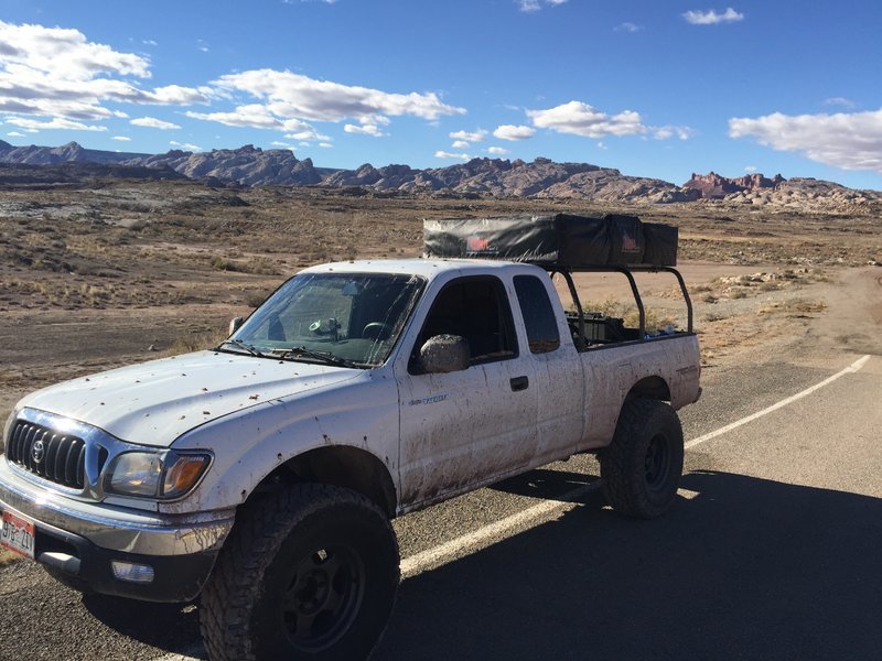

    First some backstory:
    The last (and so far only :() extended trip that I've taken with the truck was last Thanksgiving. It was a fucking stellar trip, and the only real negative was that I got caught in some nasty weather.
    On the way out of Grand Junction, Colorado, heading west on I-70, I hit a rain storm that was ridiculous in its intensity. Knowing that it was moving east and I was moving west, I knew that I'd be dealing with mud when I planned to camp that night east of the San Rafael Swell.
    Sure enough, as dusk was closing in, I pulled off the freeway and headed north. The road was soggy as hell. My tires did absolutely fantastic, and I never once felt at risk of getting stuck.
    I attempted to get as far north as I could to get away from the freeway, but I abruptly came upon a wash that was raging, with water spilling over its banks in spots. So I turned around, found a great little spot, and set up a very muddy camp.
    Killer spot and great views.
    And mud.
    Gear packed.
    And mud.
    Good times.
    And mud.
    So. When I got home the next day and took the truck to the car wash, it took me $12 in quarters to get MOST of that goddam bentonite clay out of nooks and crannies that I swear to God I'd never be able to get mud in IF I TRIED. The damn truck probably weighed an additional 80 pounds with all of it.
    I had mud in my engine bay, the hood, and even the damn roof. Worse by far was the fact that I had mud and silt in between the body and the fenders as well as way the hell up in my bedsides. The reason for that is that I yanked every single liner out of the wheel wells when I cut metal for the 35s. Engine skirts, liners, all of it.
    You might say I'm traumatized. I REALLY do not want to deal with that again. And on top of all of that, I figure if the mud got in those places, the mag chloride here certainly will too.

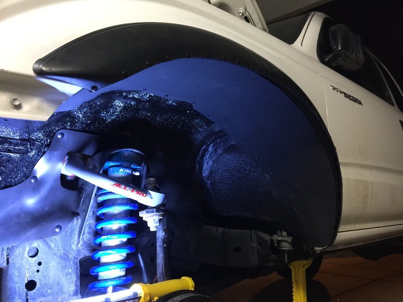

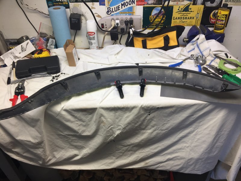

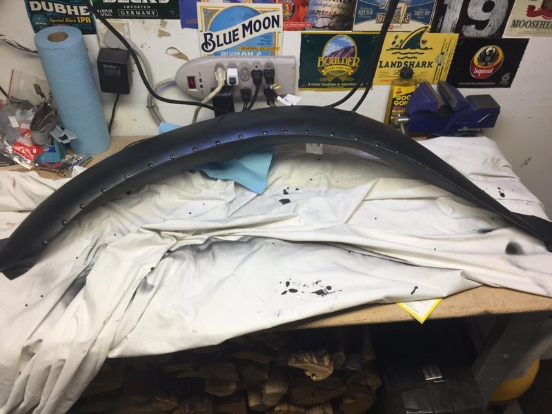

    Which brings me to my latest mod: Fender and flare closeouts. My thought was that since I wanted to run flares again, but they would have to be trimmed, all I would be doing is providing yet another pocket for mud and detritus to pack itself into, in addition to the monster gap between the body and the fenders.

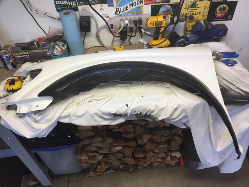

    To deal with the flare openings, I used a crap ton of rivets and some 90mil rubber sheeting. For the fender openings, I chose Kydex (ABS) since it can be formed to shape easily with a heat gun. By the time the weekend was over I only had the driver side fender done, but the results were pretty badass, I think. Check it out:
    One fender flare, trimmed to match the clearanced fender.

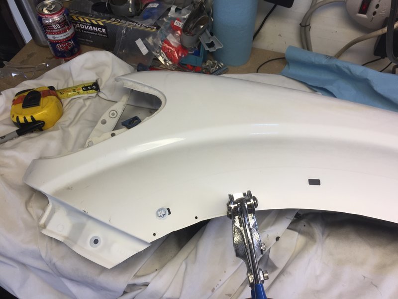

    Match punching sheet metal backing strips to hold down the rubber sheet. Tedious as hell, but my OCD powered me through.
    And beer. Beer also powered me through.

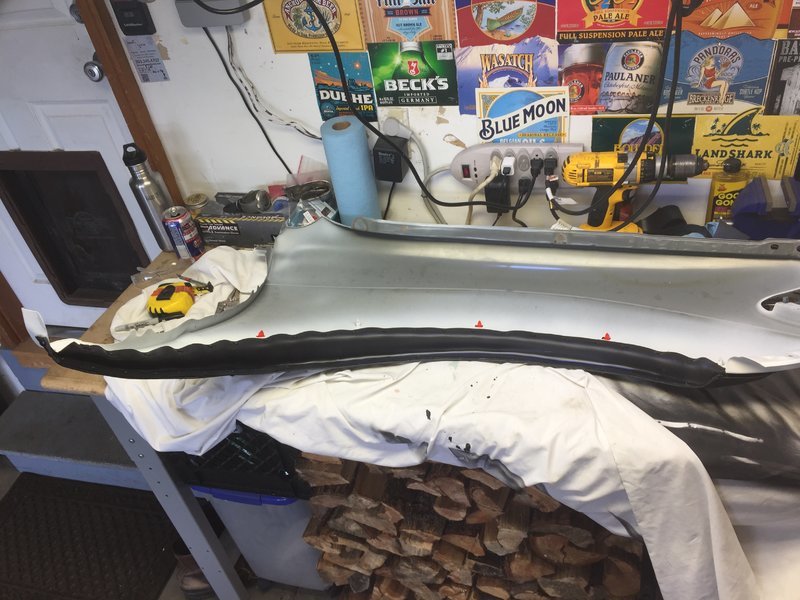

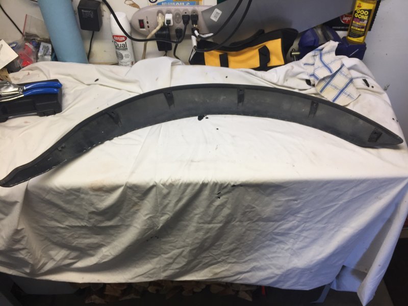

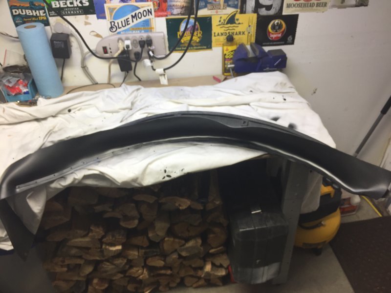

    Blurry pic of the inside of the flare, the rubber sheet, painted backing strips, and many, many, rivets.
    Done riveting the rubber to the flare. Time to mate the flare to the fender.
    Well, almost...
    Moar punching, and then some half-assed touch up painting. The beer and the OCD were wearing off at this point.

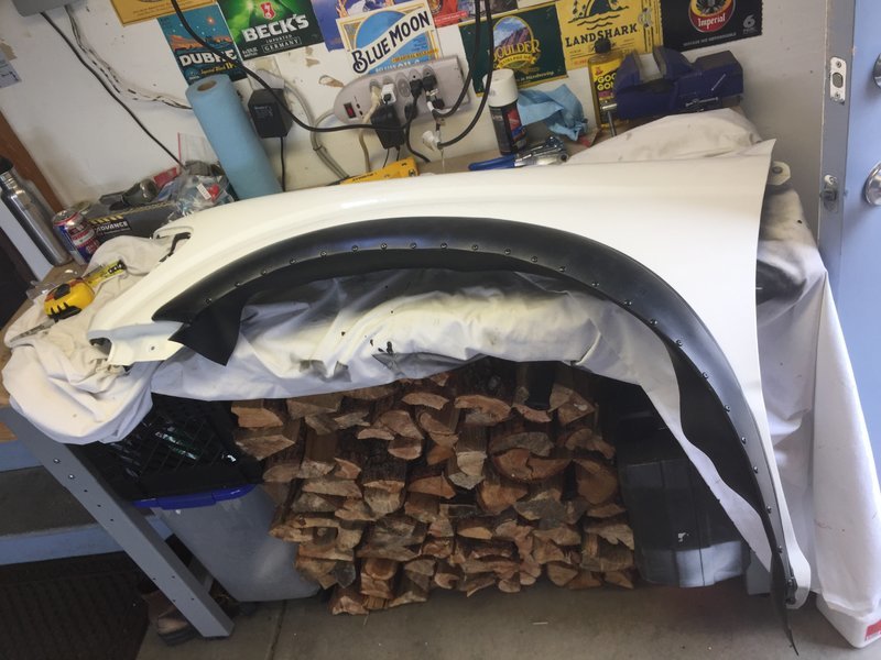

    Flare mounted to the fender with new clips. Time to trim and rivet the rubber to the fender.
    Done. I had to rivet the bottom of the flare itself to the fender because the last clip location went bye-bye along with the lower fender-to-body mounts.
    Not too shabby, I think. Pretty unobtrusive, but super functional.

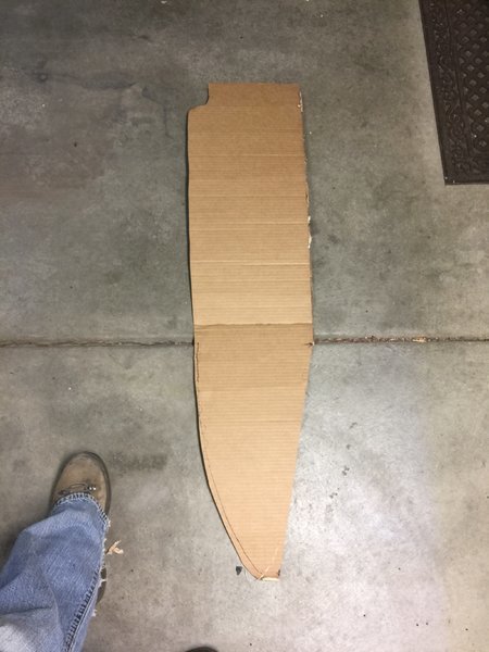

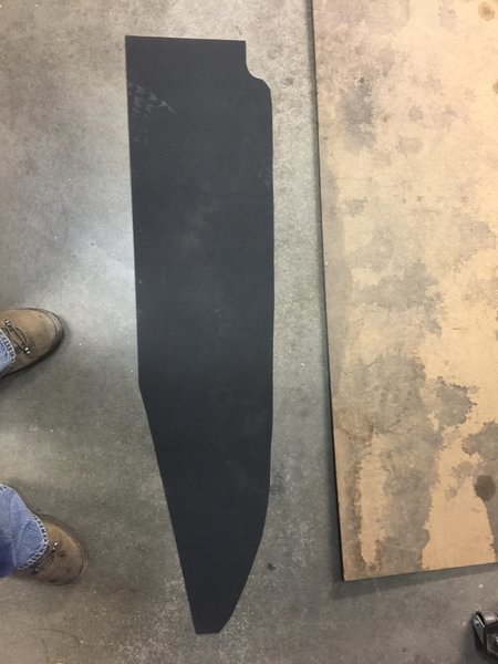

    At this point, it was time to start working with the kydex to close out the last gap. This one is HUGE; it basically encompasses the area under the battery, the void between the body and the fender, and the exposed area around the door hinges. Oh, not to mention the sweet holes in the wheel well bodywork that catch all sorts of shit.
    Super awesome cardboard template. Lesson learned after the fact was that I needed to add about an inch to the overall length to account for curvature and forming.

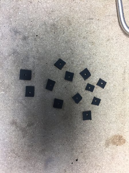

    Some rubber "washers" that I made to go between the Kydex and the firewall. I'm hoping that these do a good job of sealing out the elements and keeping moisture out of the cab. Fingers crossed.

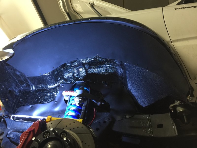

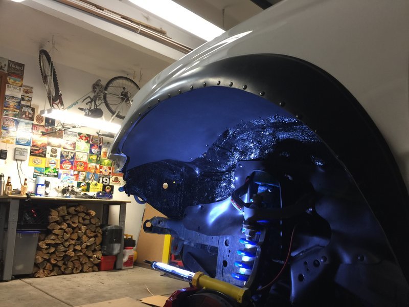

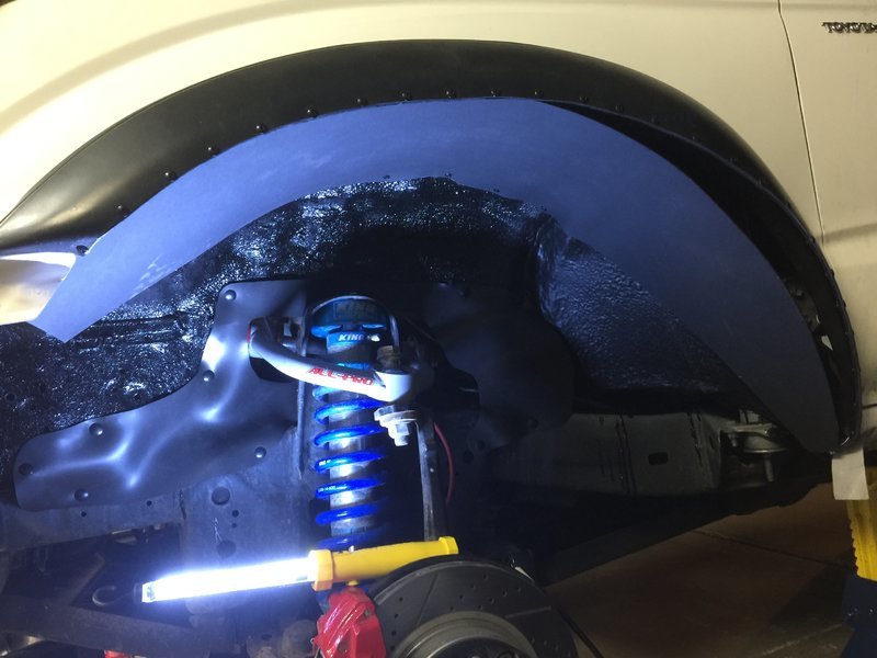

    Upskirt shot of the liner. My goal was to have the ABS overlap the rubber sheet that closes out the flare opening, and I think it came out perfectly. It's hard to see it, but the Kydex did a great job of conforming to the bumps inside the wheel well.
    No more exposed fender gap and door hinge.
    Not quite enough material to go as far as I'd like, but it should keep the majority of the mud from loading up the voids behind the headlights and side markers.
    So there it is. A lot of work, but I think it looks good and should perform even better.
